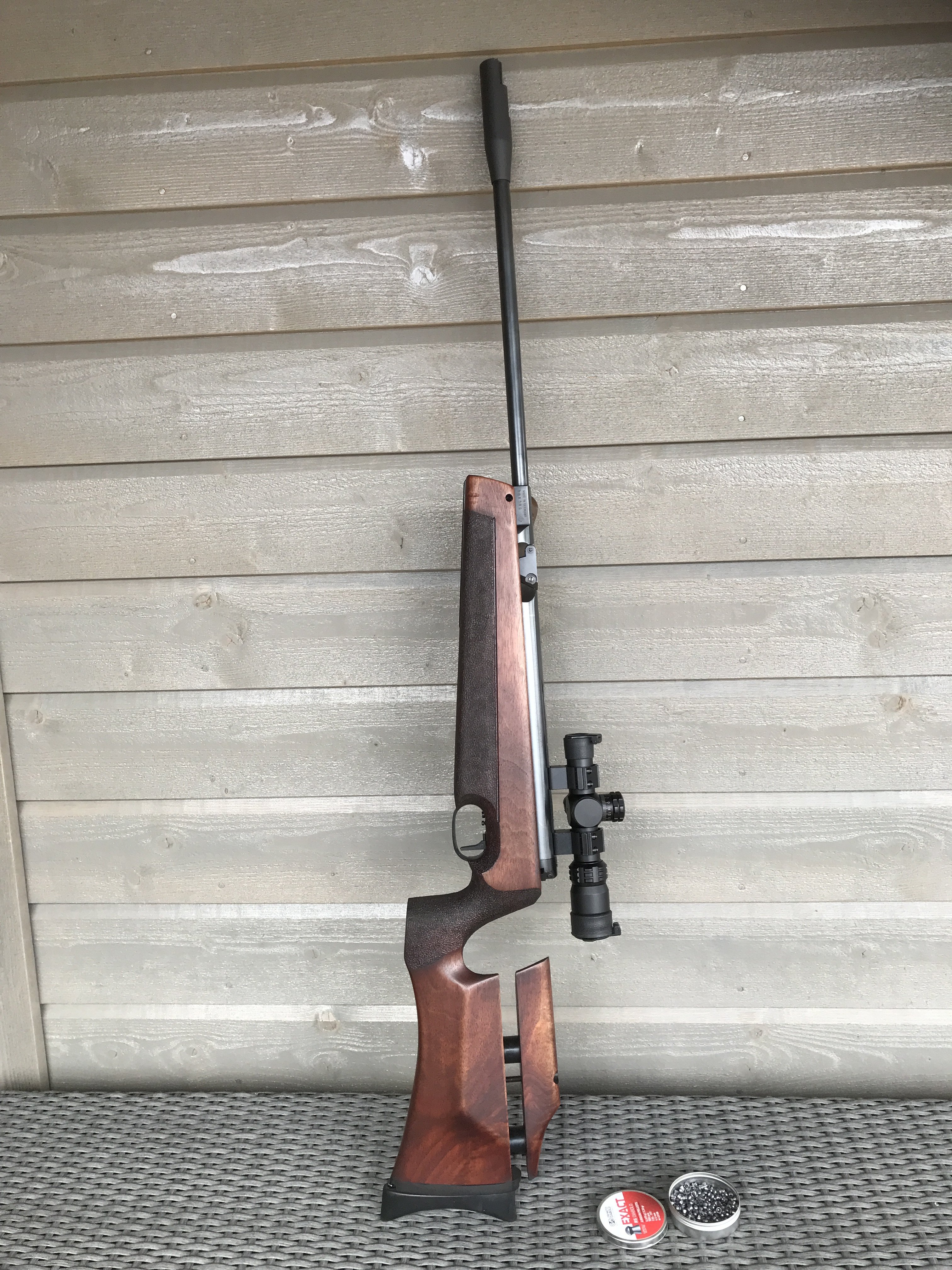

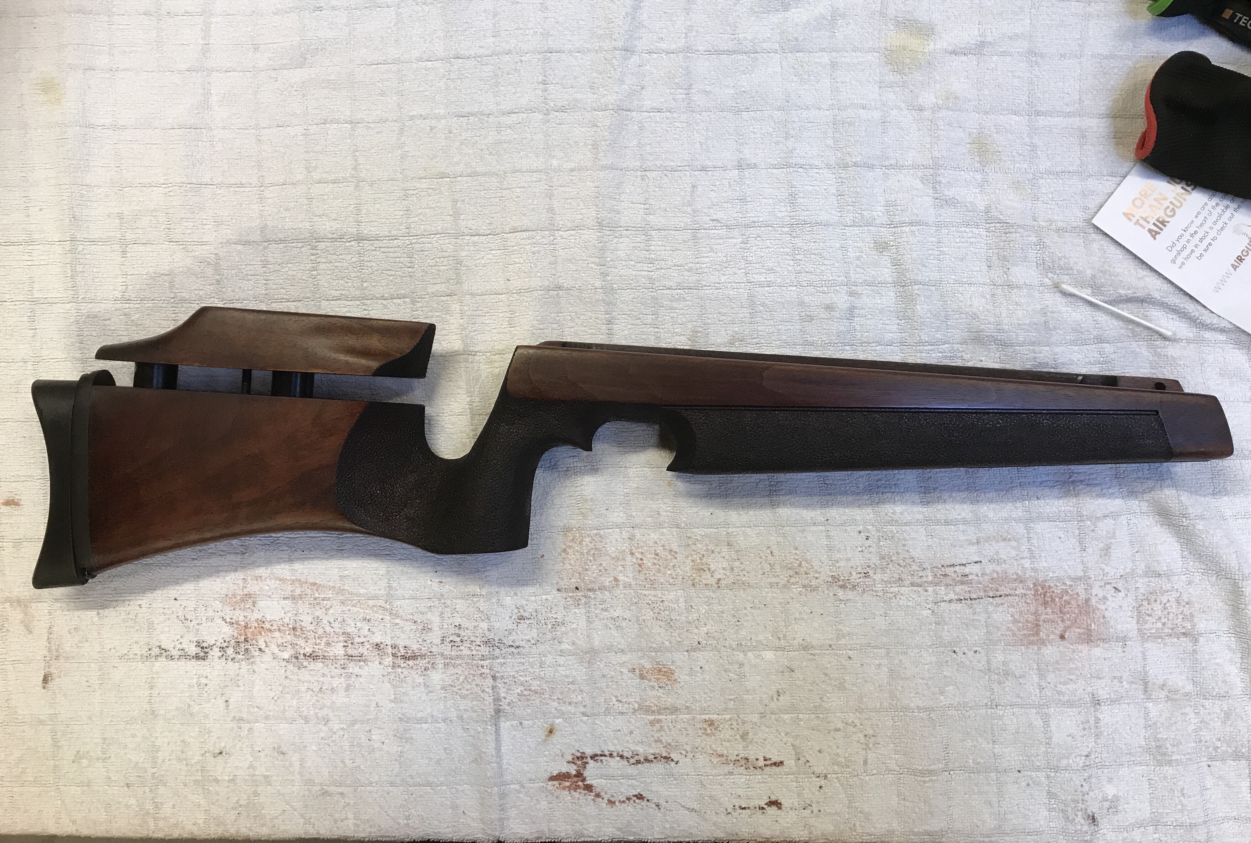

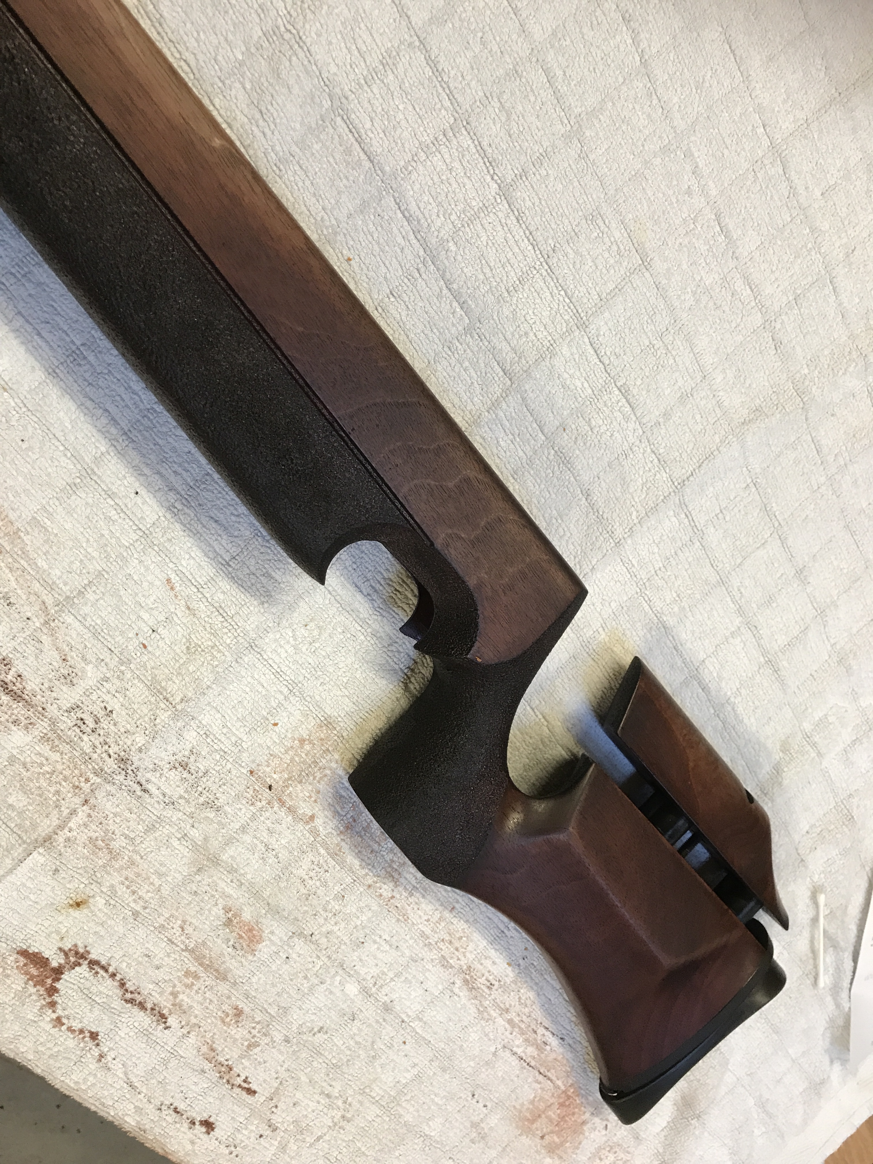

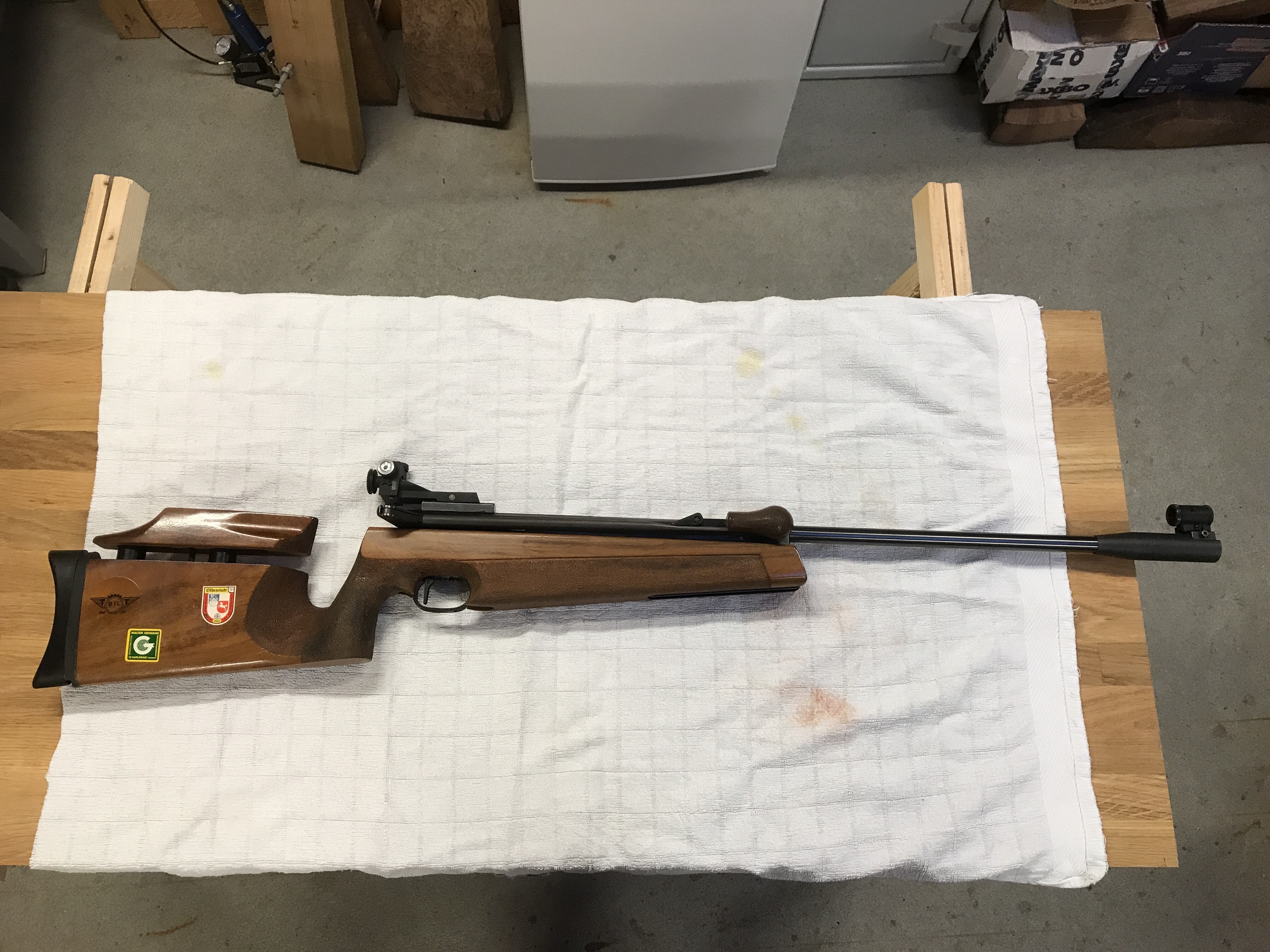

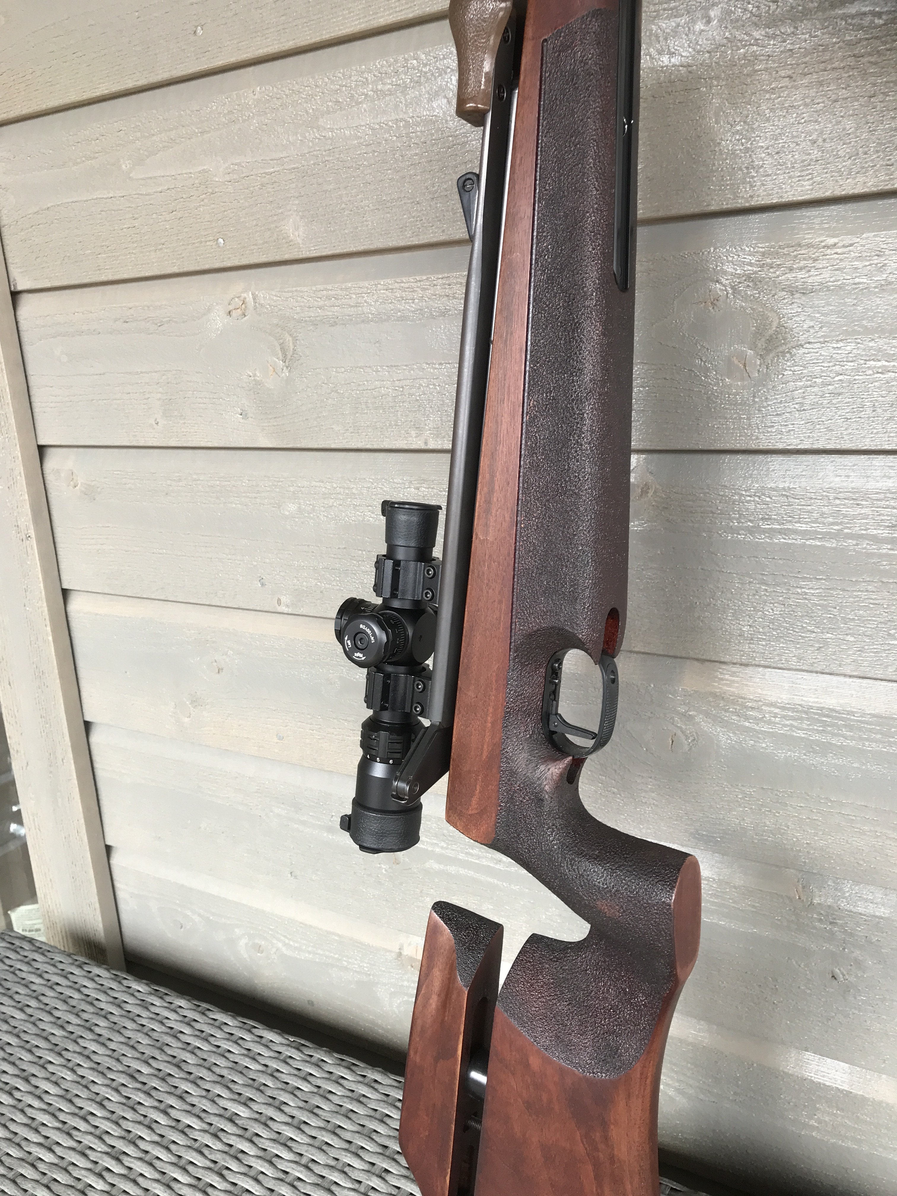

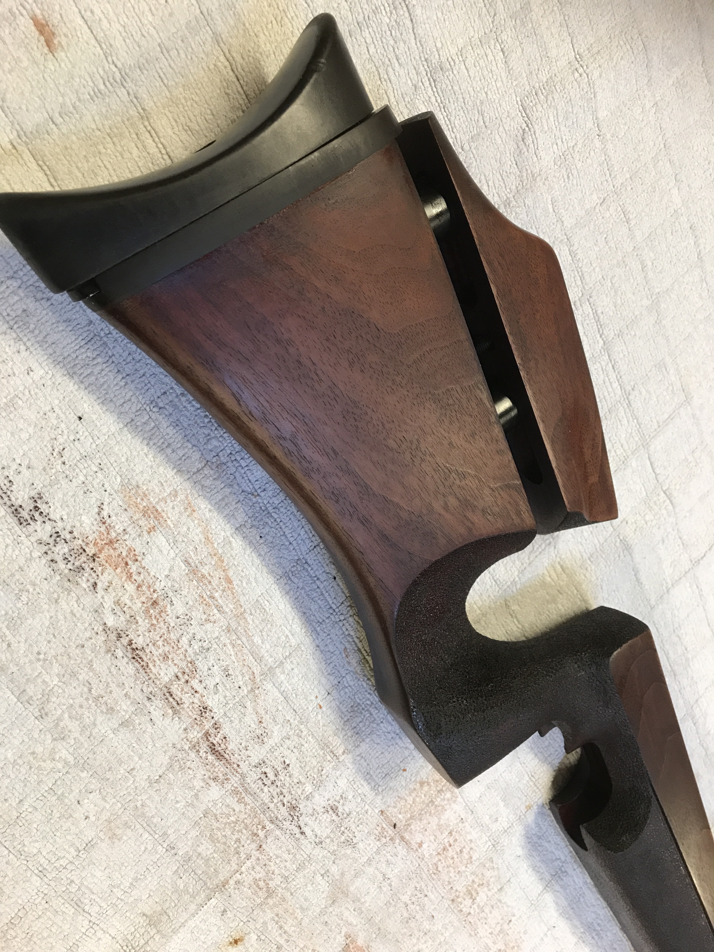

I did a minor correction to the stock on this iconic 10 m competition Walther LGR from 1980. Think it looks better now, especially after refreshing the wood and lifting the grains. I plan to mount a scope, and see how it works on further distances than it is built for.

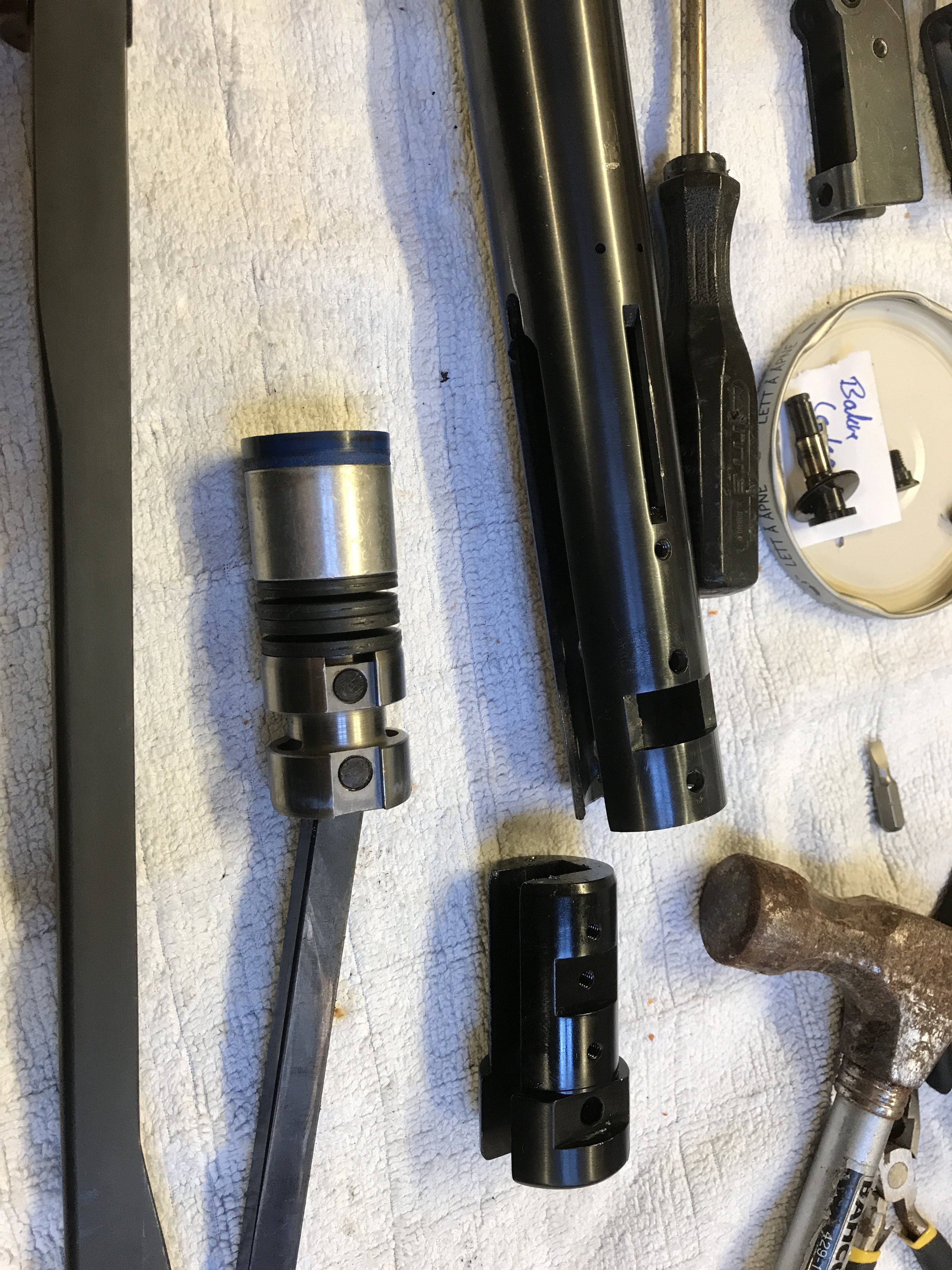

It didn’t shoot (no compression) when I bought it recently, but after replacing seals in the breech, valve and piston, I am optimistic.
Well, I have seen the videos, and read about the special tools used for the valve, but I used a plier, and it was no problem loosen/fasten the valve.
I was a bit concerned using the plier since the recommendation was the "special tool", but no harm was done to the screw holding the valve body.
