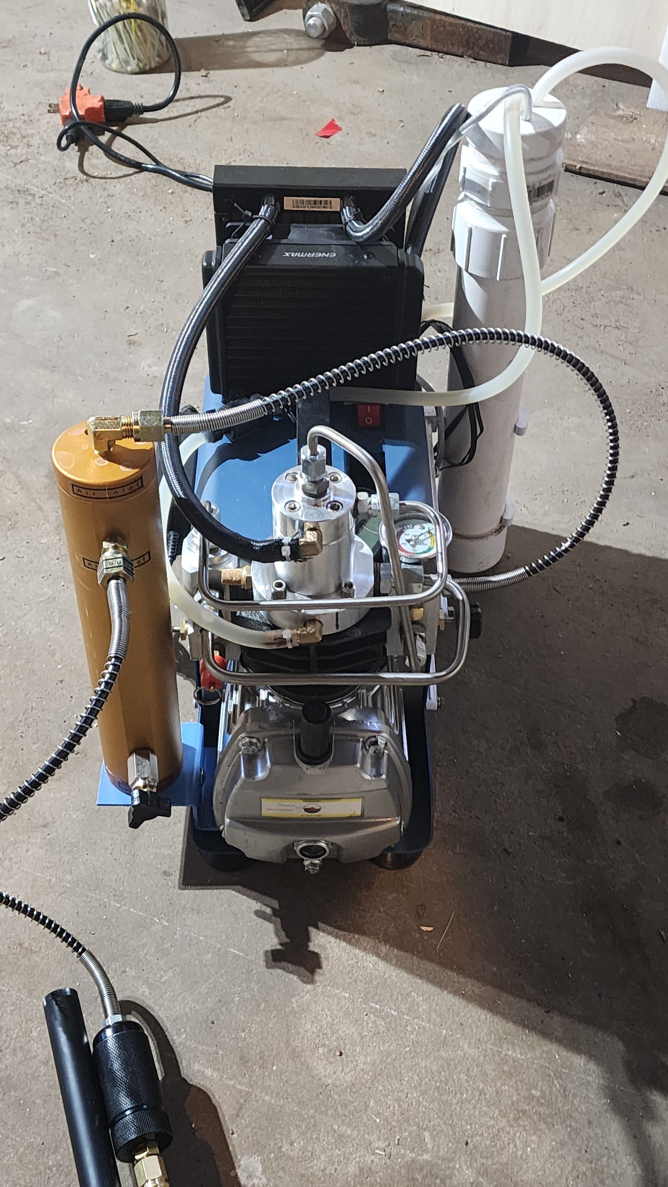

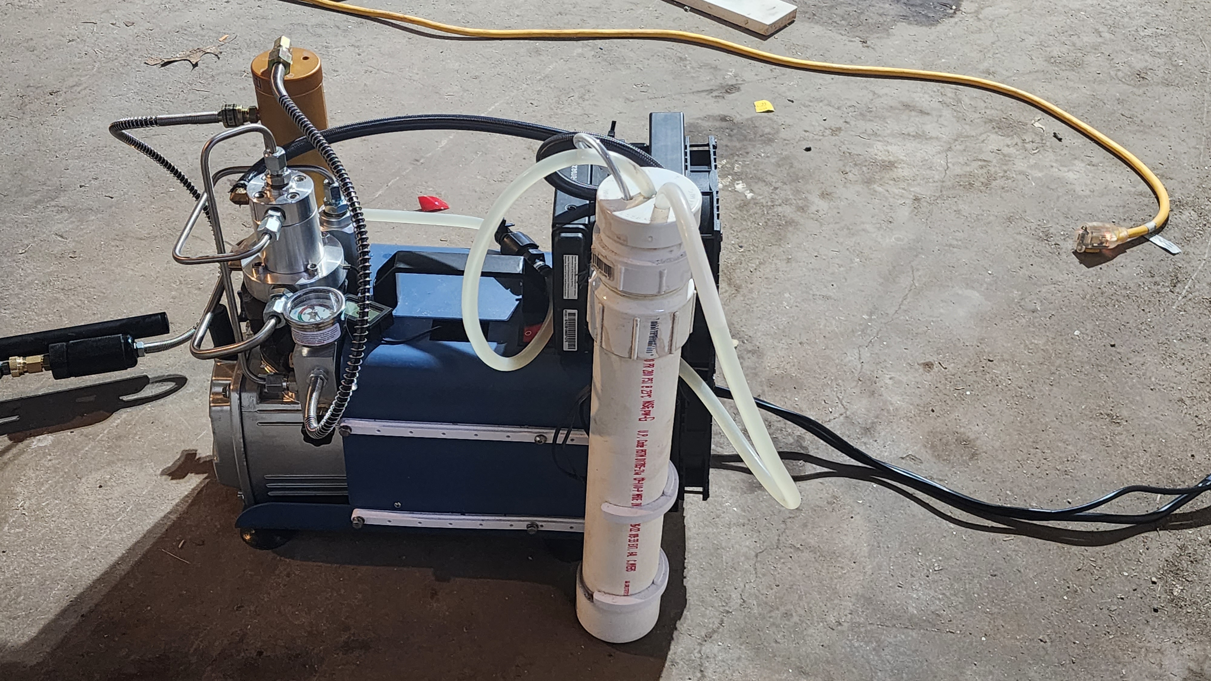

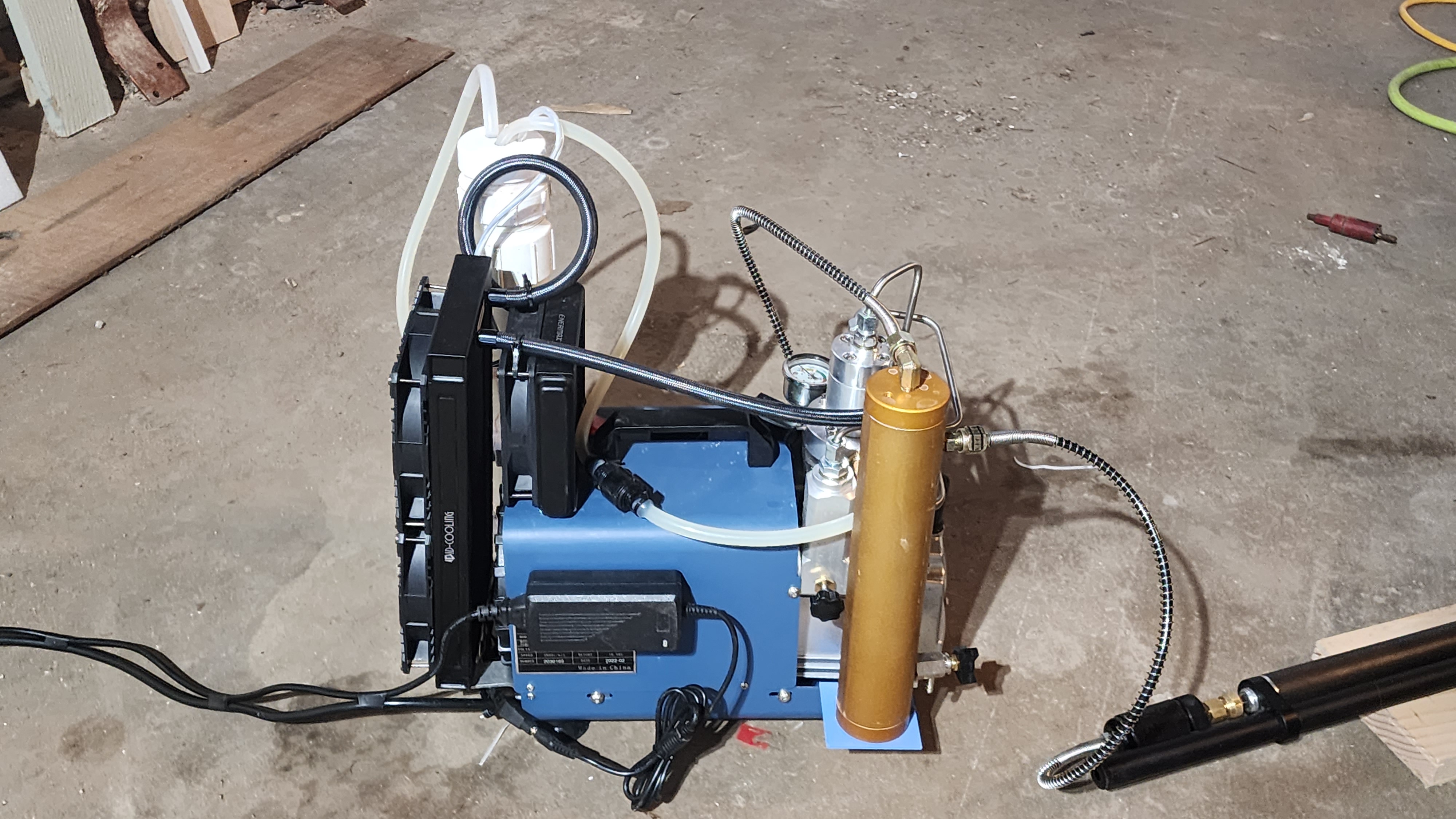

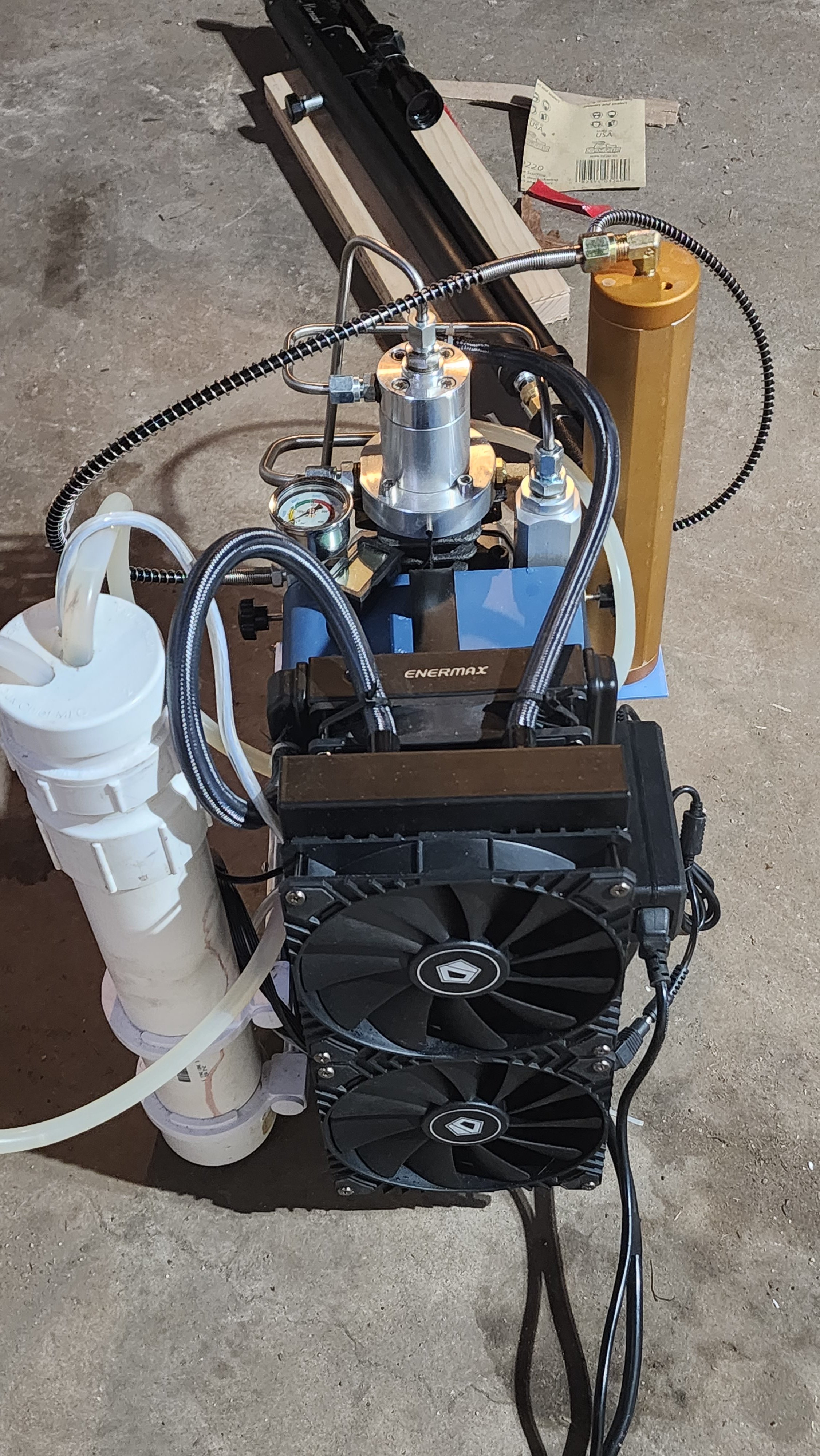

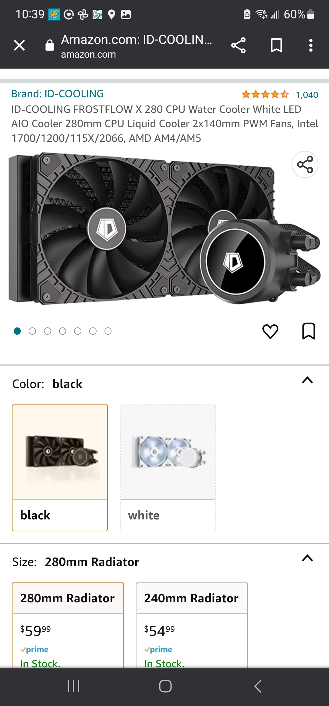

I bought a pcp compressor for <$185 at Walmart and it works great so far. I also have a gx cs2/3 but the new one from wallyworld fills my guns in <1/4 of the time of the gx. I wanted it a little more travel friendly so I added my own cooling system consisting of 2"pvc a new water pump(fits inside 2"pvc)2 radiators with 3 cooling fans. Working great so far.

Takes 7 min with gx to top off umarex from 2700 up to 4500 new one takes less than 2 minutes even with the large air dryer tube added on
That is pretty darned fast. I haven't timed it but I am pretty sure my Yong Heng isn't that fast with just the small black filter and an extra small blue one, and it is essentially the same compressor you have. Is there a brand name on yours?

Yes that's the one

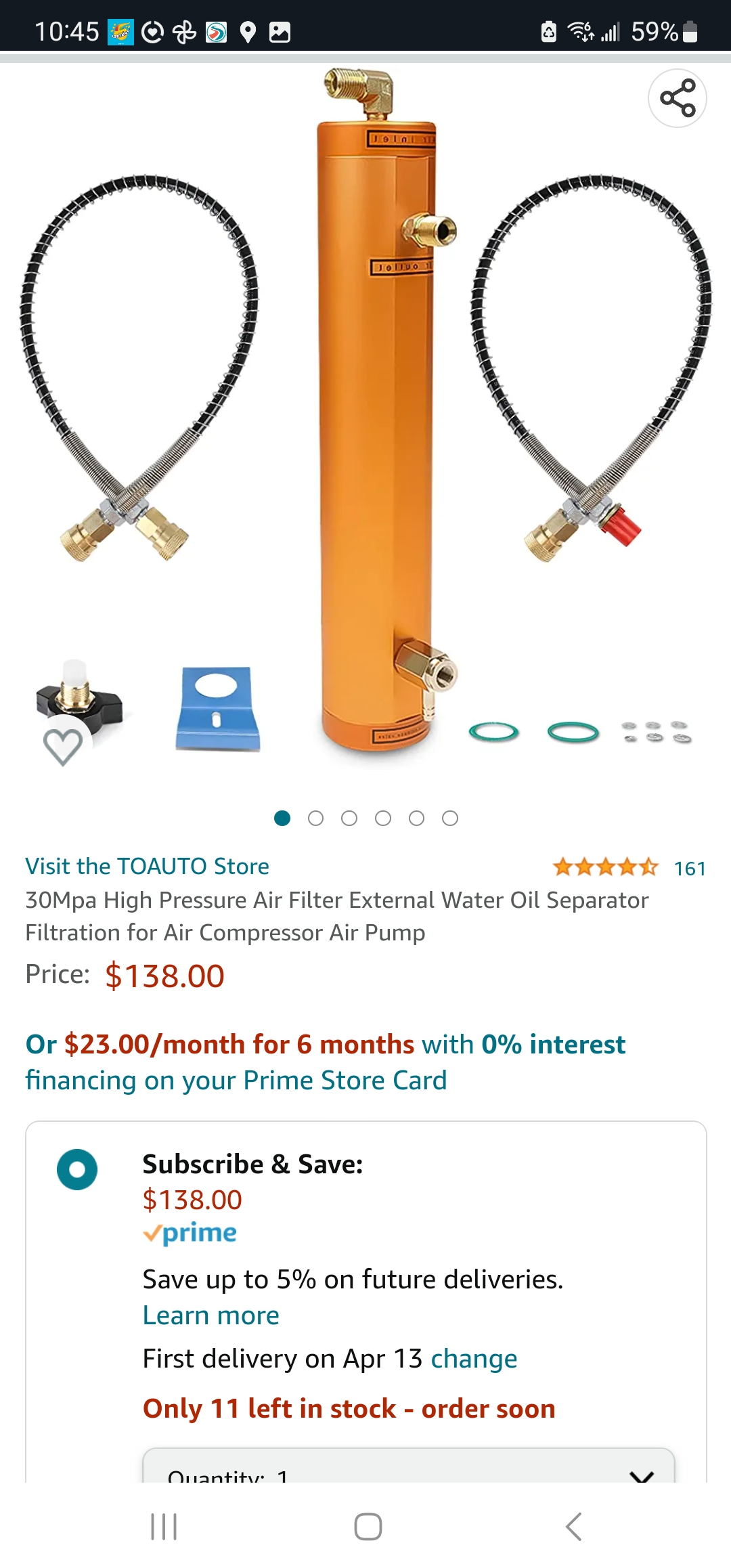

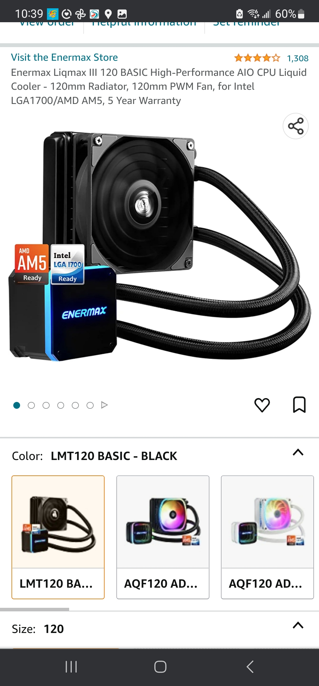

Nice setup. Can you describe the cooling system? Using water? What is the radiator make and model?
I use the premix coolant for cars. The parts are in attached pics
