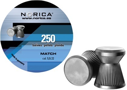

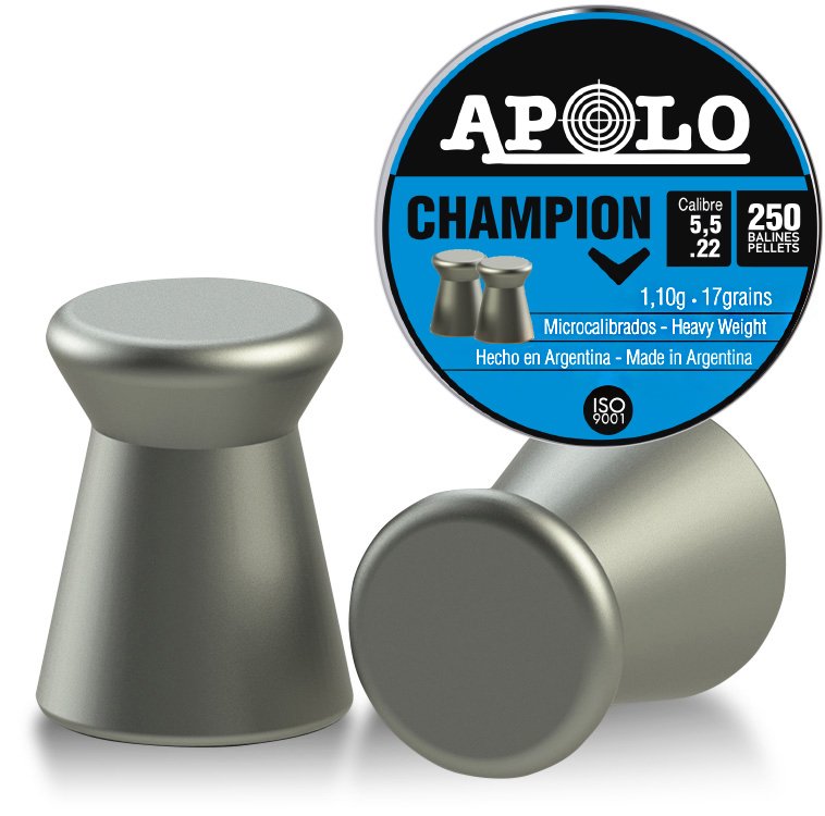

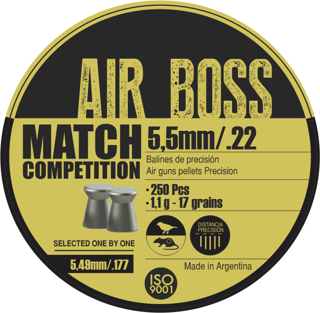

I am interested in wadcutters because of the hard hitting impact they make on quarry.
I would guess(?) that a heavier wadcutter is generally more precise, but of course — the barrel likes what it likes, so no way around the buy-try-and-see game that our airgun supply stores must have taught the airgun barrels.
I found some very heavy wadcutters, and I'm just now trying to source them. Cf. below.
Matthias
🔶 HEAVY WADCUTTERS
17 grain in .22cal
Norica: Says: Made in Germany!
Air Boss (sub brand of Apolo): Made in Argentina
Pellets.  Wadcutter .22cal.  Apolo Air Boss. 5.5mm. Match Competition. 01.1651790293.jpg
Apolo: Made in Argentina
