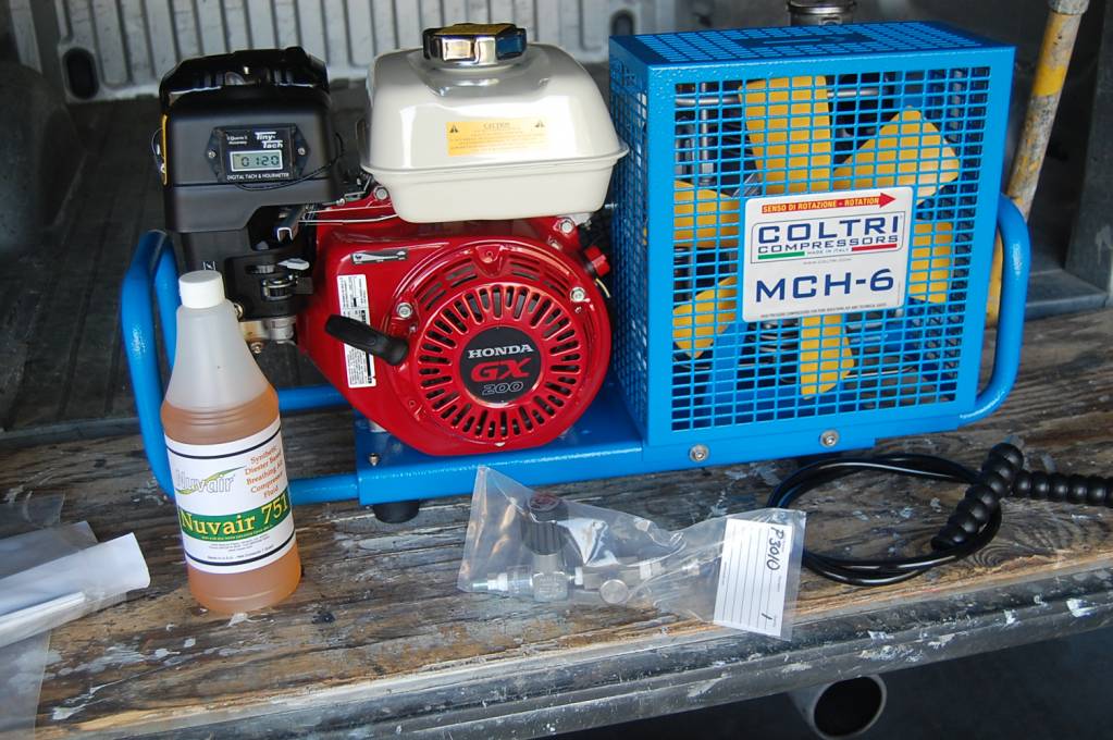

The Coltri MCH-6 is also a worthy compressor for your consideration as it can usually be found for $2795 and is built to be a Junior II competitor for considerably less money. I opted for the Alkin and feel that it is a better choice even though it costs a few hundred more than the Coltri. To me, the Bauer, the Alkin, and the Coltri are the 3 companies to consider if you want a buy once, cry once dependable compressor.
