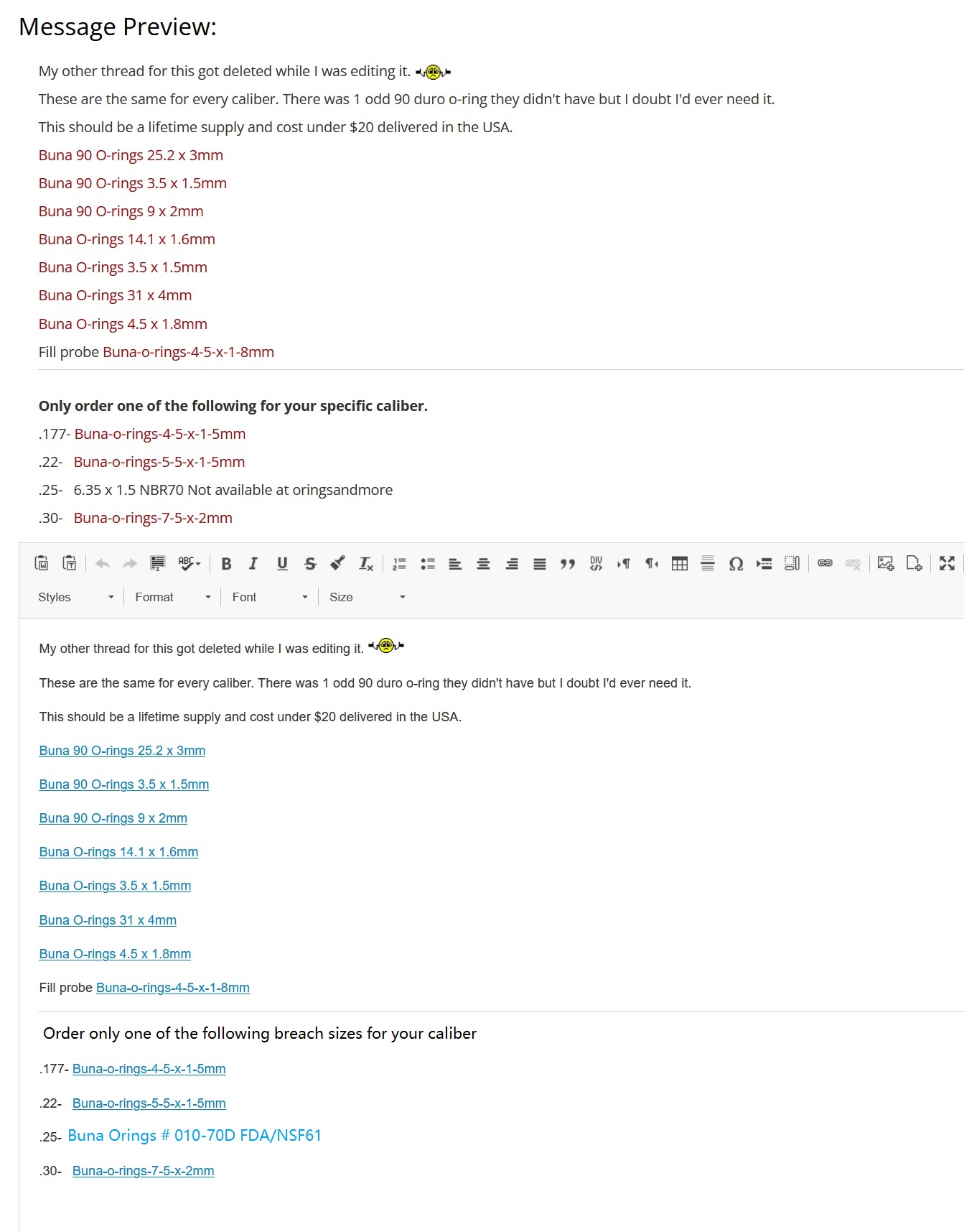

Vulcan3 Oring list for Oringsandmore.com
I had too many links when I first tried to post this list. All the info is here now. It's not perfect but... Here's a link to a cart with all o-rings above including all 4 caliber breech o-rings.

Regarding the probe o-ring....the sizes listed are the same sizes listed in my Uragan manual (for the Uragan). However, a 6.35mm ID with 1.5 CS does not exist (that I could find). And I couldn't find a "close enough" imperial sized o-ring. I contacted AGT and they told me that 6.5 ID x 1.5 CS was the correct size. I have not removed my probe o-ring yet to verify....but maybe 6.5 ID is correct for the Vulcan3 and the Uragan?
It uses a #10 o-ring. My mind has been a bit fuzzy lately so I didn't think about it. 1/4id x 3/8od x 1/16cs https://www.oringsandmore.com/buna-orings-010-70d-fda-nsf61-minimum-100-pcs/
