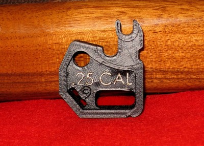

I started a thread on this sometime back after finding my tray on ebay. Several others have got them and seem to like them. A gentleman is using a 3D printer to make them and I must say they are pretty sturdy and do the trick. I did have to remove some material (very minor) with a little jewelers dremel but I would rather take material off than have to try to put it back on. Any questions on it drop me an PM if you like. Hope this helps.
I just went a looked at ebay evensteven101 and he has a newer version out that takes a bigger radius on the shoulder down to the bottom radius of the tray allowing pellets to roll down the ramp better. Pretty cool design. Nice to see some good ole American Ingenuity! (picture of older version like mine)
Ok, wasn't going to post it here as didn't want to ruin the OP's thread. If you want me to take it down OP, I will..
