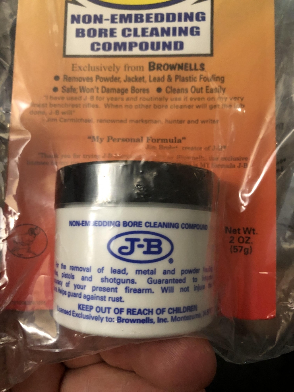

This showed up today. 😁
I'm going to try this out on my Continuum 700mm pellet liner.
What was your procedure? I was planning on running a mop with Ballistol and bore paste for 20-25 times. Clean, shoot some groups and repeat if needed. I’m waiting for more slug liners to arrive. The 700mm pellet liner is just a throw away. Perfect test bed.

HAVE done the JB on a bunch of PBers and several P P guns. Not a big accuracy or group size all the time, never a negative, always a smoother bore by feel with patch. Some a big improvement in group size and a bit of of speed improvement. Clean bore with patches, wipe a good coat of JB on bore mop "cotton" , 50 strokes, wash bore mop, pull a couple patches through, more JB on brush, 50 strokes. Solvent and patch out. I also use the cotton caliber specific bore cleaners, 2 to protect the chamber and boring. Also turn the TO up if doing on the gun and a padded or coated rod. On a Lilja barreled 17HMR I've gone over 2000 rounds between patches with strong copper cleaned and picked up very little blue on the JB done barrel.
Dave, just a heads up that you may want to check the bore dimensions before removing the choke. LW’s choked barrels generally have a loose bore and rely heavily on the choke to ensure the proper release of a pellet. This is a topic that Mike Niksch of Thomas Benchrest has cautioned about. I don’t know the circumstances of your test so this may not matter but I wanted to give you a heads up just in case.
I've found that polishing my barrels might give you a slight accuracy advantage, but what I've noticed is less fouling and easier cleaning of the barrel. I use a 25 cal bore mop, coat my mop with JB and stroke 25 to 35 strokes, then clean barrel. It's a lot easier with the barrel off and the chamber o-ring removed. Make sure you get all the JB out of o-ring groove.
