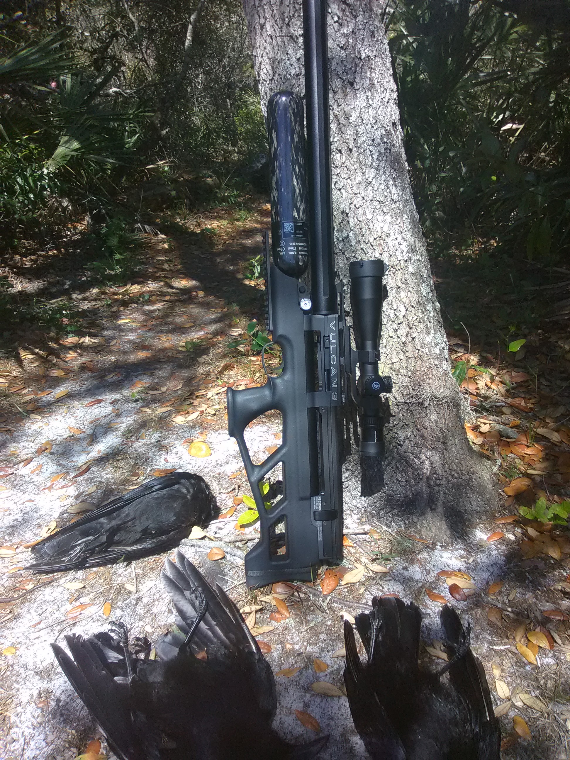

Little on heavy side, super subcompact (20.5 ounce) Vector Veyron 6-24x44 scope helps, needs de-pinging and extra tiny gauge is hard for older eyes. Pros: accurate, powerful and deadly. WM
