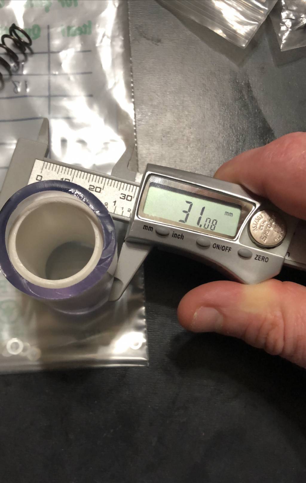

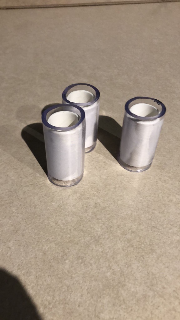

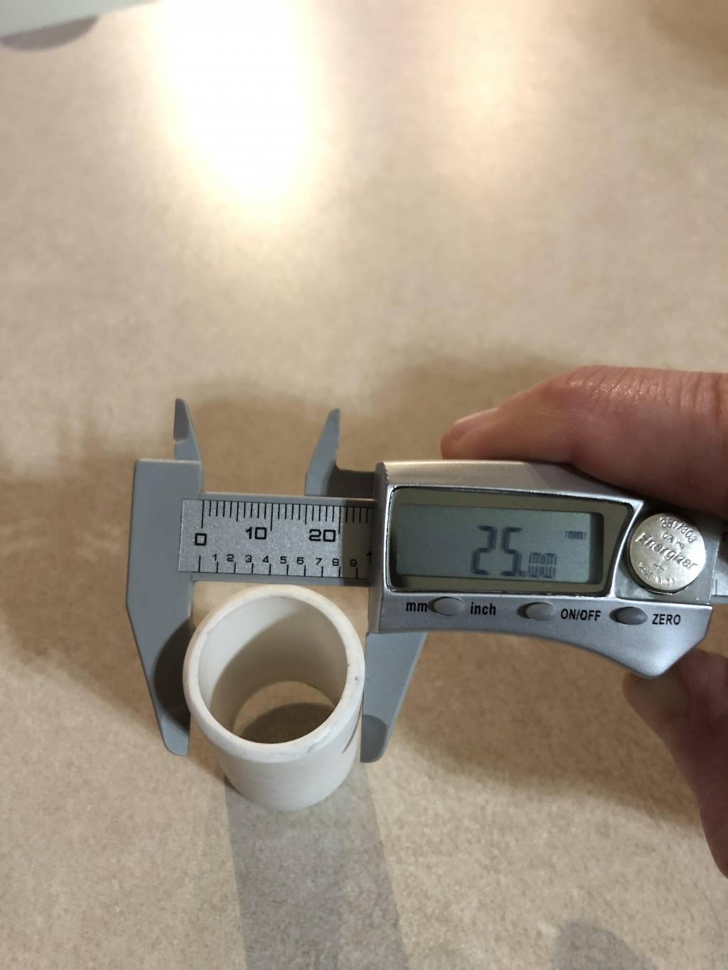

One I made from vinyl tubing and a PVC pipe insert. It is installed on the valve side of the tube/plenum. It takes a bit of work to get the PVC insert shaved to the correct O.D. needed. The plenum is so large the cc's taken up by the d-pinger is insignificant and does not hinder power one bit. I have this installed in my .22 V3 Long that it tuned for 79 FPE. I've also installed this in a few others. It is only needed when the Vulcan is configured in the XL plenum setup. It works!
