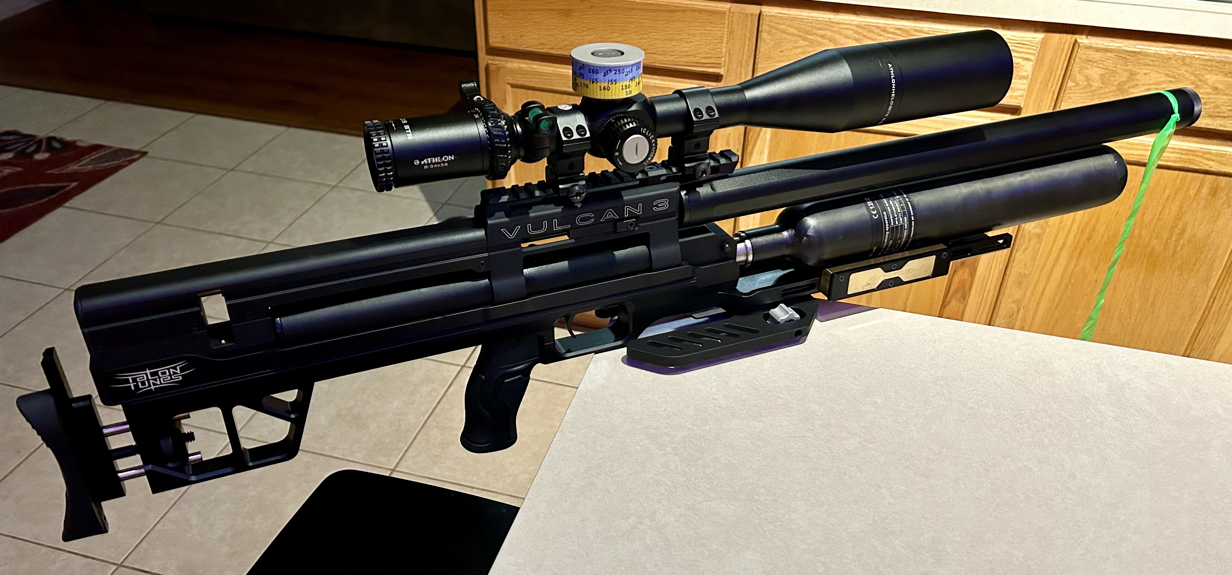

Hello Gents, I’m trying for the speed that seems to be mentioned as “Best” velocity for the AVS & ZAN 33 & 34 gr. Slugs. Today I went from 140 Bar to 160 Bar on the regulator and gained 60 fps… Before was 925 and now 985. This is with the Hammer adjustment turned All the way in until Just able to engage Sear with quite a bit of finish effort on the cocking lever. (That spot seems to be about 5.75 rotation In from all way backed out to hit the stock)
I have read a few accounts of wanting to get those 33-34 slugs up to 1,010-1,020 fps to maximize their accuracy at 100 Yds.
Unfortunately, have to leave town for this week but when back next WE I’ll go the last little step to Max. Rated 170 Bar on the reg. and see what I get.
Info point, it looks like probably 2 Bar per shot at 160 reg. If 50 bar divided by 25 shots holds true. ( edited as I noticed earlier screw-up… 50 bar drop not 500!!)
ANY / ALL comments, tips, helpful input Encouraged.
Thanks and updates to follow next week.

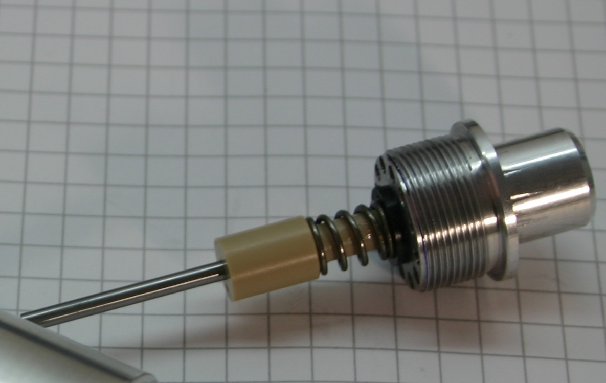

Then I'd say to put a balance valve with a larger poppet and transfer port opening in it.
A much lighter HS. (easy cocking) and a reg. setting at 115 - 125 bar.
Then you could shoot 40 gr. slugs in the 900 - 950 FPS range accurately with a LOT quieter gun that's not maxed out.

Thanks for the input Gang. "Long-Shot", that is a brilliant replacement valve (replaces plenum tube end???) if it brings that kind of performance at such low Reg. pressures. Fascinating. (You should make that think and sell examples $$)

VULCAN 33 / .22 Cal / 700mm @ 160 Bar test: See results from 160 Bar Test string with .22 Caliber 33gr ZAN / 0.218 Slugs. This is with the ADDed Talon Tune Heavy Spring. Notice how the sweet spot seems to be at only "2.25 to 2.75 Turns IN" on the hammer spring adjuster from backed out against the stock. The MAX travel of the adjuster plunger is at 4.75 Turns Into the Receiver before the Sear will not catch in the cocking stroke.
The Variation at 2.75 Turns was very low at only 3 fps across 4 shots. There was essentially No Performance / Velocity Gain above that mark. The Total shot count at this Reg. setting from 300 Bar down to 175 Bar with the 580cc Bottle appears to be 45-50 shots.
I think one can conclude that 160 Bar is Not capable of pushing a 33 gr. ZAN any faster than 990 fps. I will take her to the range in this config. and see how the "AVS" 33 & 34 gr. slugs fly before making any more adjustments. More to follow after some bench time.
