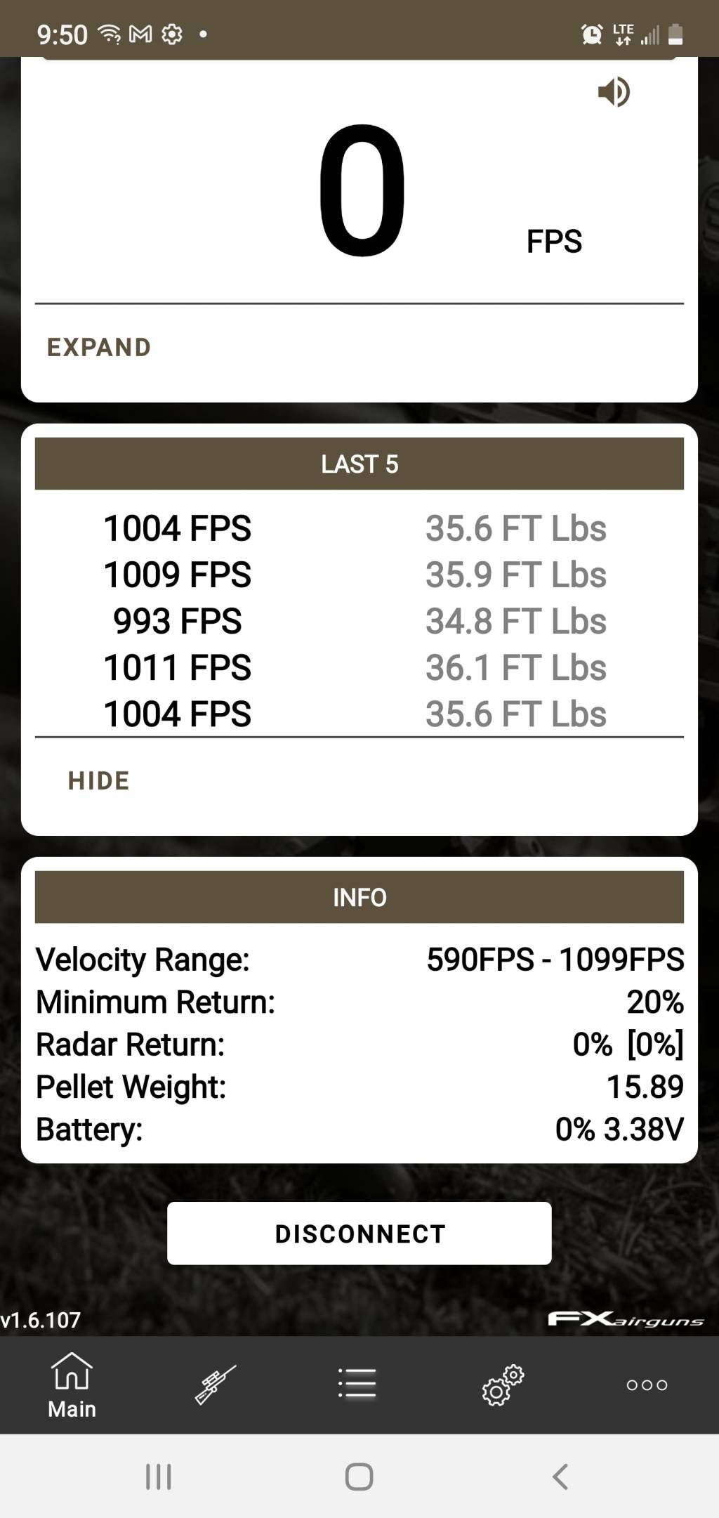

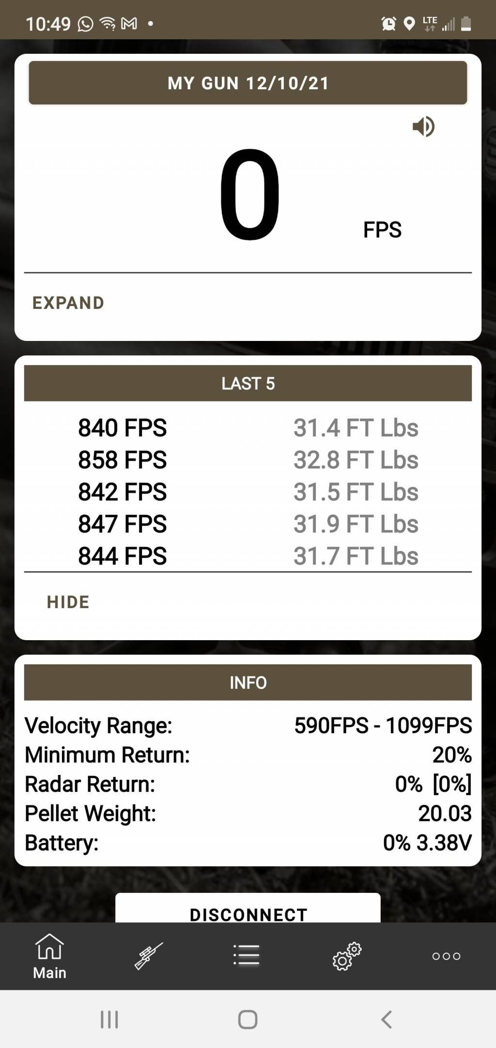

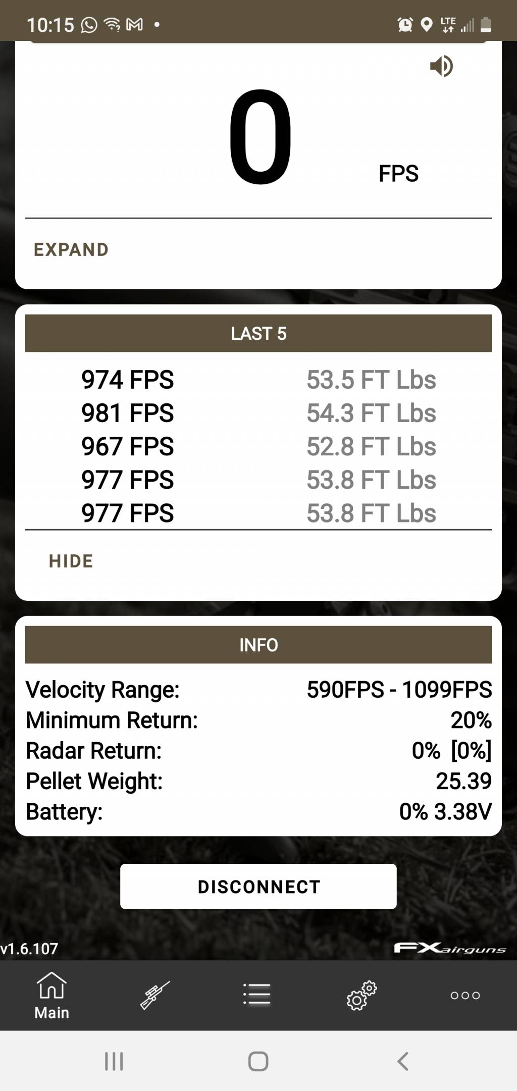

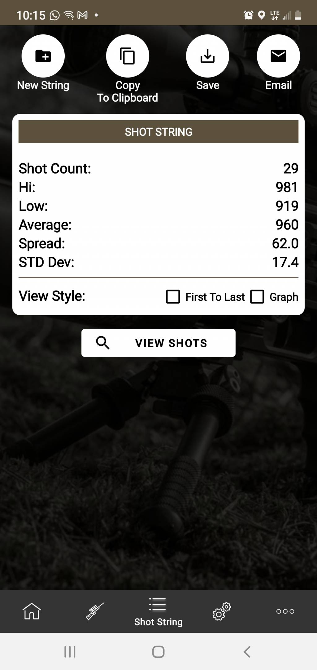

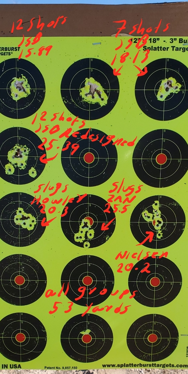

a week ago i try up the Vulcan 3 .22 cal 700 mm barrel.. all groups are 53 yards distance hope this can help you
numbers of JSB 15.89
numbers of JSB 18.13
number of JSB monster Redesigned 25.39
numbers of slugs Howler 20.3
this is the gun out of the box
Seems like based on the velocities with the 25 grains that it is allot lower then what the gun should be shooting when it is set with the regulator on the side giving a larger plenum with the stock 110 bar on the reg or at least based on how mine came. I’m assuming yours is set to the smaller plenum configuration. If that is the case then you may be nearly maxing out the hamerspring to get these velocities I think either flipping the regulator to the larger plenum side and backing off the hammer spring or keeping your reg where it is increasing the regulator pressure and backing off the hammer spring will prolly tighten up your velocity spreads.

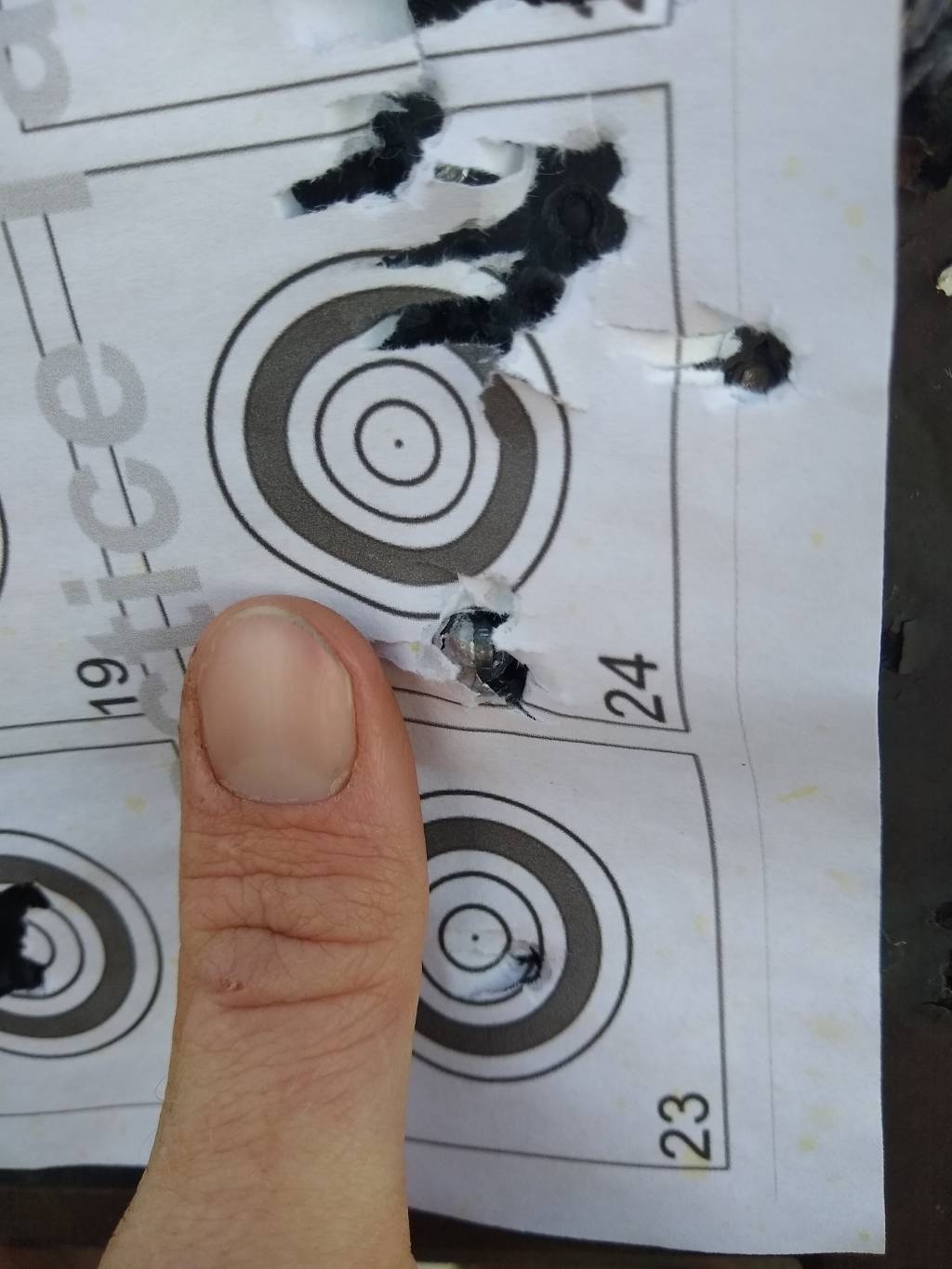

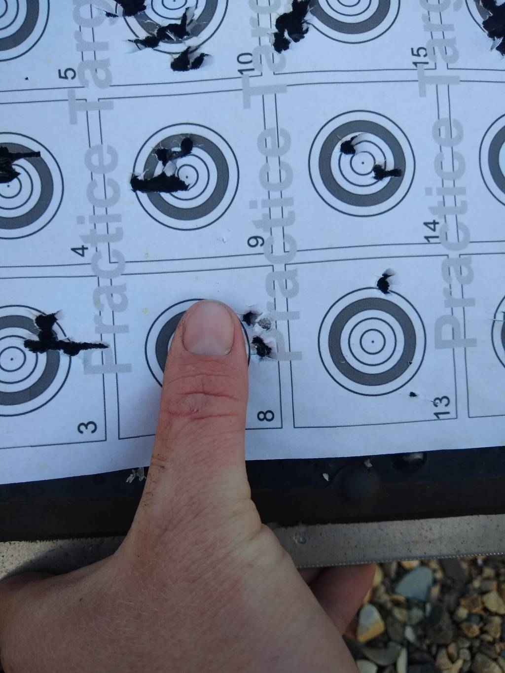

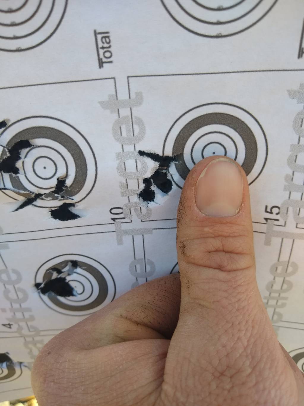

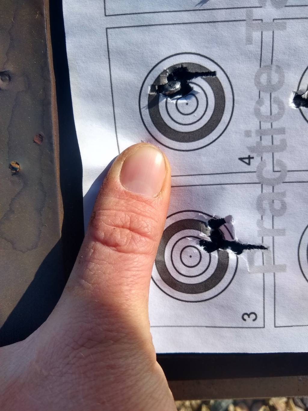

Got it in today! Gun shoots incredibly well. Very comfortable gun to get behind. Action noise is on the louder side but not bad. Fit and finish is top notch. I really like what they did with this gun. Top group is first 5 at 50yds. Next 2 also 5 shots at 50yds. Adjusted the scope alittle between each group. FX 16gr pellets at guessing 930fps.

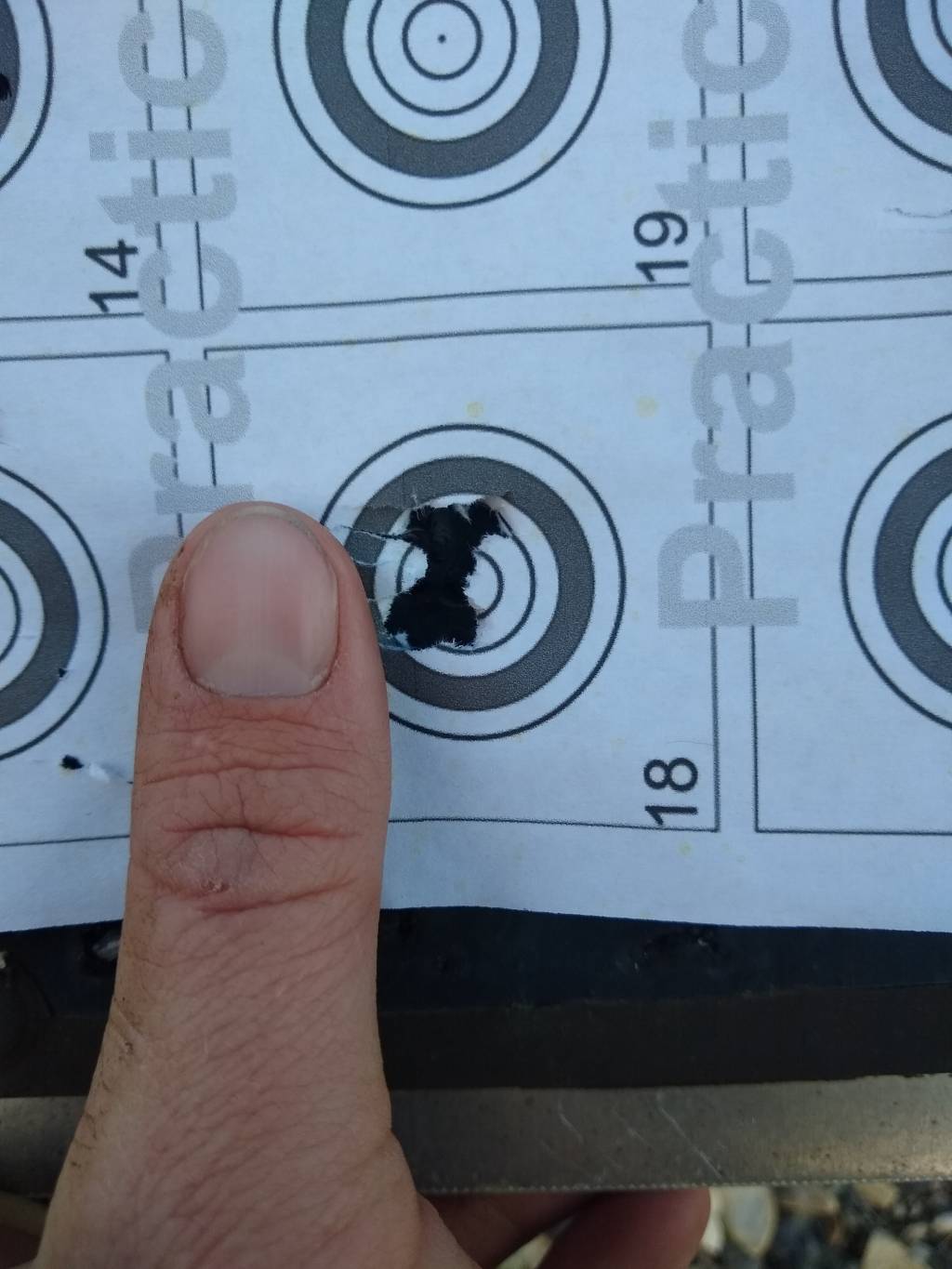

Top 2 pics 6 shots each with AA 16gr. Bottom pic shows an older tin of RD Monsters I've had that I'm gonna use up, less than half full maybe? Wish I had more looking at that accuracy! They larger group above are 12 shots with CPHPs. Not terrible but not great. I have over 10k 16gr pellets in the different varieties and seems to like them all so happy there.
Hey Dillon what’s the noise your talking about. Ping ? Just curious about the noise. How’s the report with the new shroud. Hopefully get more guys post about the gun. Not many say much. I do know that the 22-700mm some got are not happy with the barrel but it looks like it still shoots pellets.
