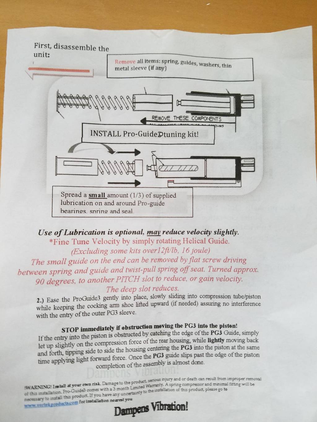

I recently purchased a hw97k and right away popped a HO tune kit didnt even fire one pellet through the gun. I installed the kit perfectly gun shoots great but it's not shooting to what the spec says. again this is a PG3 Vortek HO tune kit. the gun shoots 14.3 gr at 695 fps I can can even pluck golf balls with a 3-9x32 scope at 90 yards. but I'm not getting the 720 fps the kit says in the spec. I was wondering am I supposed to leave the stock washers in the piston when I in stalled the kit? also I understand you can adjust the top hat for maximum velocity but I dont understand which slot and it's like impossible to turn. also does removing the brass washers from the pg3 kit do anything? spring in the kit is broken in and no one responds when I try to contact vortek. any input would help thanks

You can release the tophat from the spring using a screwdriver. There's a gap between the end of the spring and the tophat. Apply gentle pressure in that gap using a small screwdriver. The spring should release slightly and then you can rotate the tophat. It's pretty obvious once you see how it works.
There are two positions. On my HW95 with a Vortek PG3, I chrony'd both and found little difference. I set the tophat back to the stock position. You may have better luck.
ya I was just hoping it would shoot around 730 fps with the tune kit and the vacuum seal i got that they said could increase fps. it shoots between 685 and 695 just doesnt seem right. that's why I was wondering if maybe i change the slot on the top hat it could increase the velocity i just dont know which slot and things a bitch to take apart. shoots great just was hoping for a bit more fpe. But it's possible it's just the crossman premier pellets.

The directions that came with my PG3 kit say to remove everything. I would CALL Vortek, if you want to get a precise answer from them.

also update
I since rotated the top hat to the maximum velocity slot and am getting 695 -700 15.6 FPE and 21 joules which is pretty good with 14.3gr which I'm pretty sure is to spec. also polished internals and bore with 600 800 and 1200 grit sand paper. gun shoots incredible I would take apart the trigger pack and polish it but it's a brand new gun and to lazy any ways.
