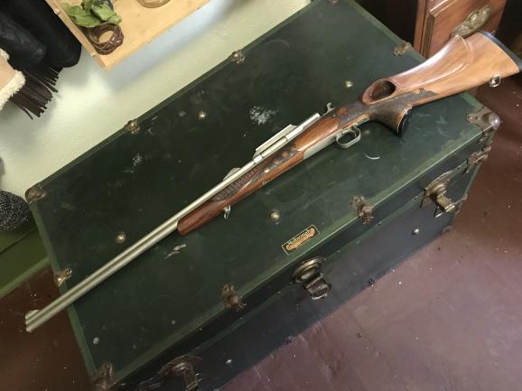

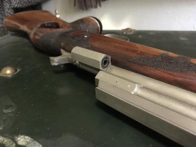

Howdy Folks,

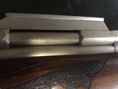

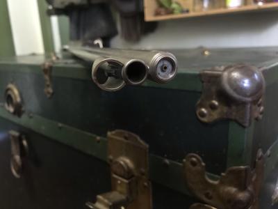

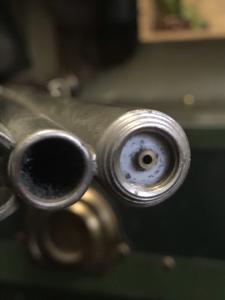

I'm new to this whole airgun scene, haven't fired them since I was a young lad. But with that being said I just inherited one of my granddad's air rifles along with some other guns. I had no idea he even had one of these. I would like to start firing this thing but I wanted to ask if any of you all have seen a setup like this or have any knowledge of this rifle. Looks pretty custom to me. The tube underneath the barrel is threaded on the business end so I'm pretty sure you would have to load the C02 from there but it looks like it would need an adapter or tank which I do not have. I can load up more images if need be.
Thanks for all your help in this,
Jensen

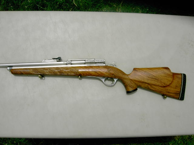

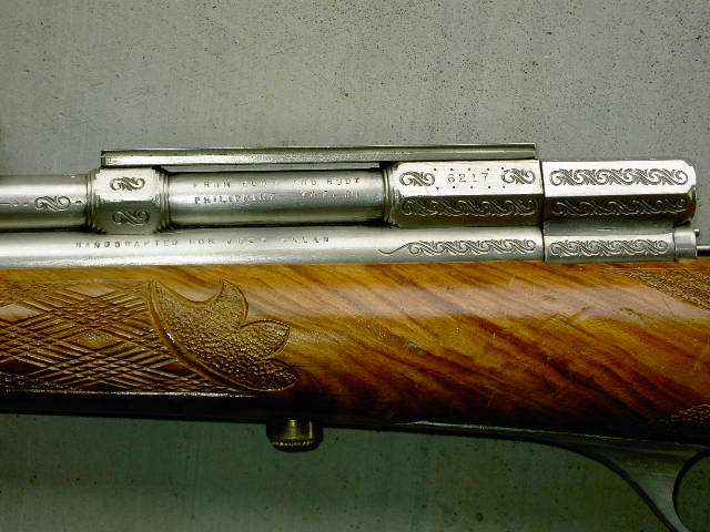

Typical Philippine co2. Go to a local hydraulic hose maker. Those guys know their fittings. They might be able to make the hose while you wait. It's probably a standard pipe fitting size. Squish an o-ring in there finger tight for a seal and CAREFULLY try to fill it. The Pellgun oil trick might get it to seal. Don't freeze/burn your fingers!
Often combination shotgun/pellet guns. If the rifled bore liner is missing you might be able to make a bore insert from a .22RF bore liner. Daisy 922 barrel could probably also be adapted by a decent machinist. (me). Good luck, it looks like a cool gun.
Thanks for all the info everybody.
I think I have a game plan. I live in a small town(Astoria,OR) and I might just have to talk to the scuba shop for a hydraulic hose. Otherwise I have made some for my paintball guns before so I'm thinking of making an adapter and valve to go from one of my paintball tanks into the fill fitting on the gun. If I do this should I equalize the pressure from the tank or just slowly let a little in at a time?
"by the time you get the tank, fill hoses and the co2 situated, you might be better getting a good quality springer."
That one-of-a-kind Filipino Co2 rifle has ten times the SOUL of 90% of springers ever made. It's definitely worth the time, trouble, and expense of resurrecting; assuming the miracle worker that does it can appreciate what he resurrects.
