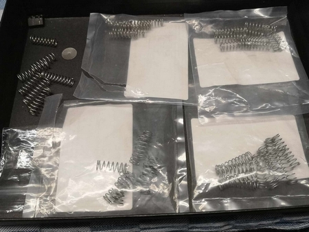

To my knowledge, it is now the most powerful CO2 multi-shot pistol in .177 caliber. This result is the outcome of many years of fine-tuning and optimization. I tested a wide range of valve springs with different wire thicknesses, coil counts, and free lengths. To refine all my settings, I went through around 500+ CO2 cartridges during the tests phase, exploring every possible way to gain both velocity and shot-to-shot consistency. As a result, all internal parts have been modified.

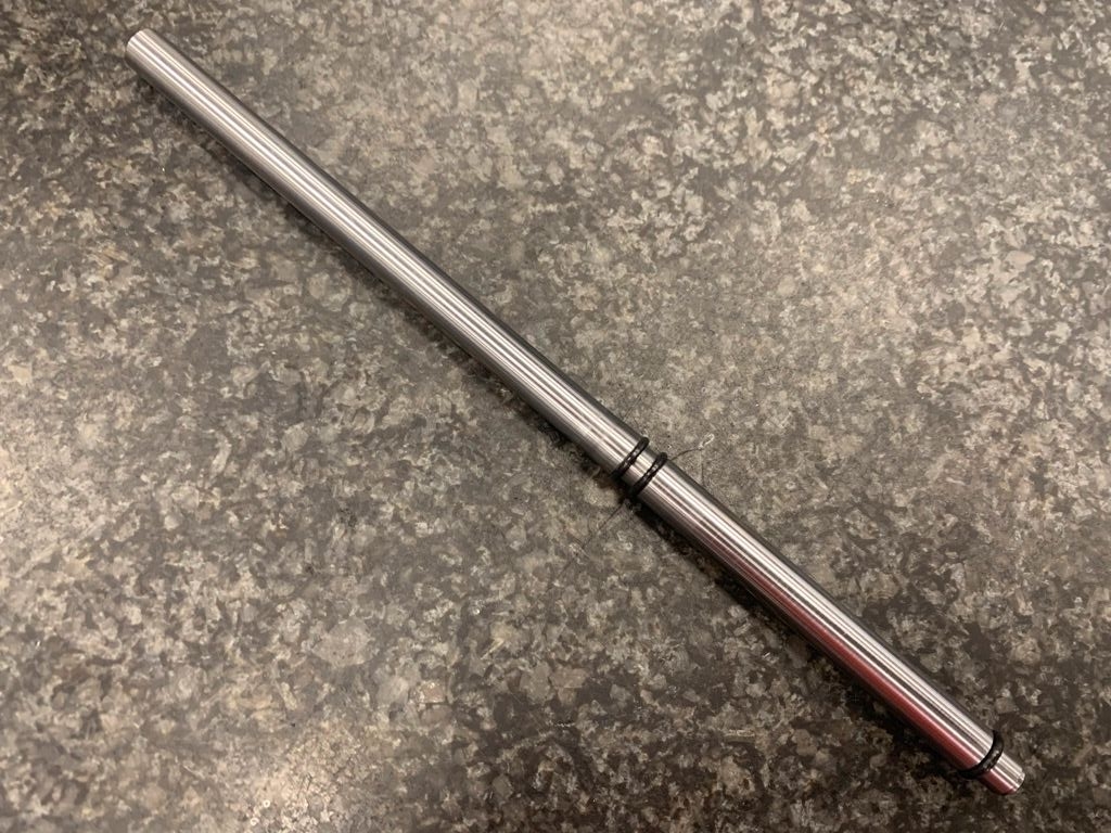

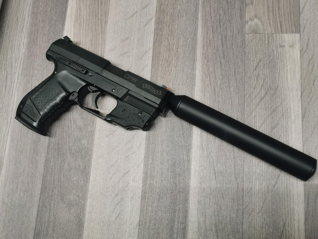

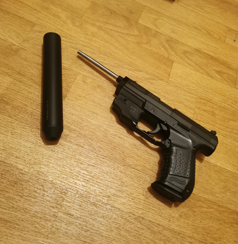

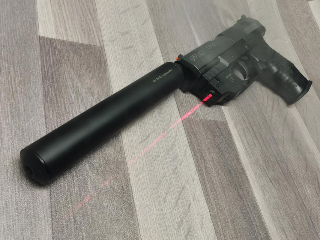

The limiting factor at that point was clearly the barrel length, so I installed a custom machined 7.5 inches barrel, partially hiden within a Weihrauch silencer. The sound suppression remains very effective. The improvement was immediate, accuracy became outstanding, and the power took a big leap. I was finally able to fully exploit all the internal work, reaching 560–570 fps with cheap 0.50 g pellets, which translates to around 7.5 joules.

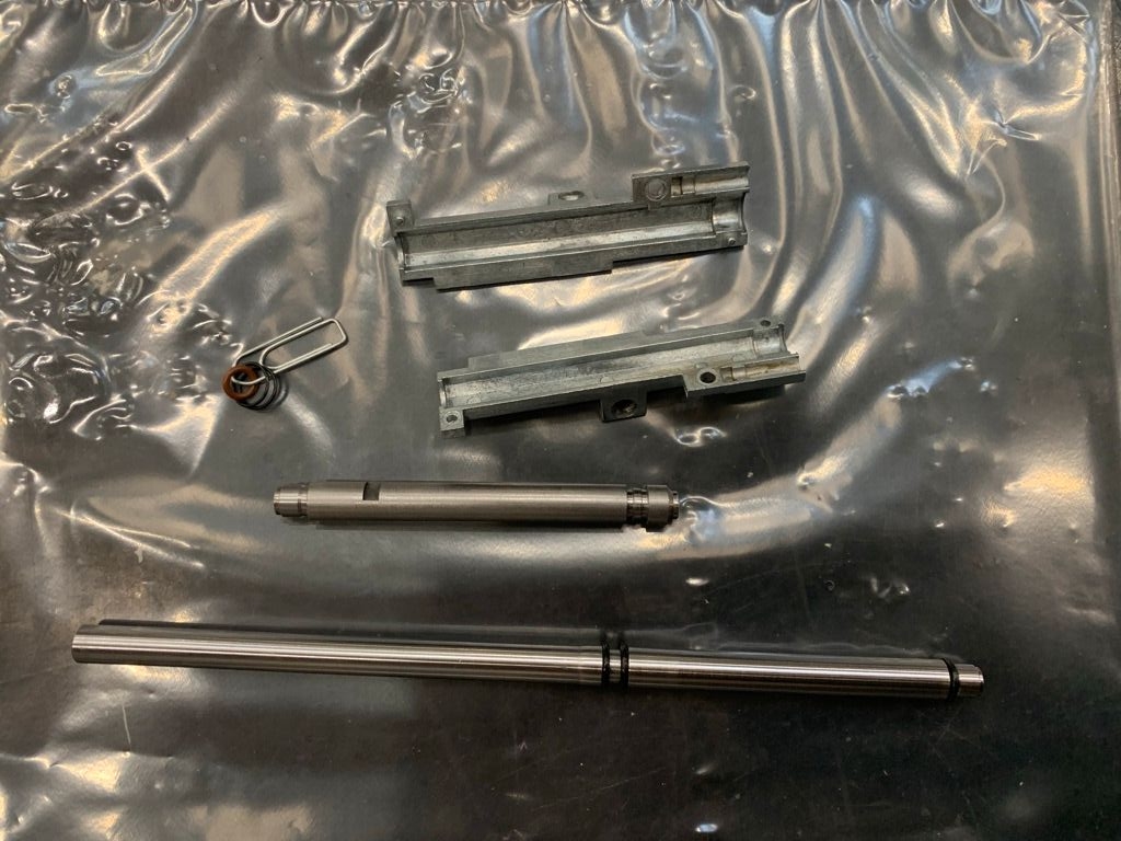

I've modified :

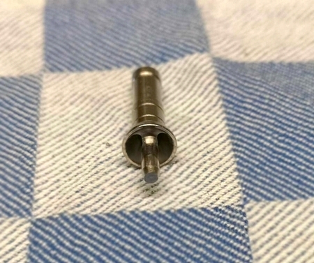

-"Moon" valve with enlarged 4 mm output port and widened CO2 inlet
-Mag head fully machined to increase CO2 volume
-Spacers added under the CO2 piercing pin to increase volume
-Piercing pin bored out to 1.30 mm and filter removed
-Valve spring lightened and optimized
-Reinforced hammer spring (imported from Indonesia)
-Threaded steel insert in the alloy hammer for reinforcement and improved valve opening
-Improved sealing between barrel, cylinder, and CO2 outlet
-7.5 inches rifled barrel
I've modified :
