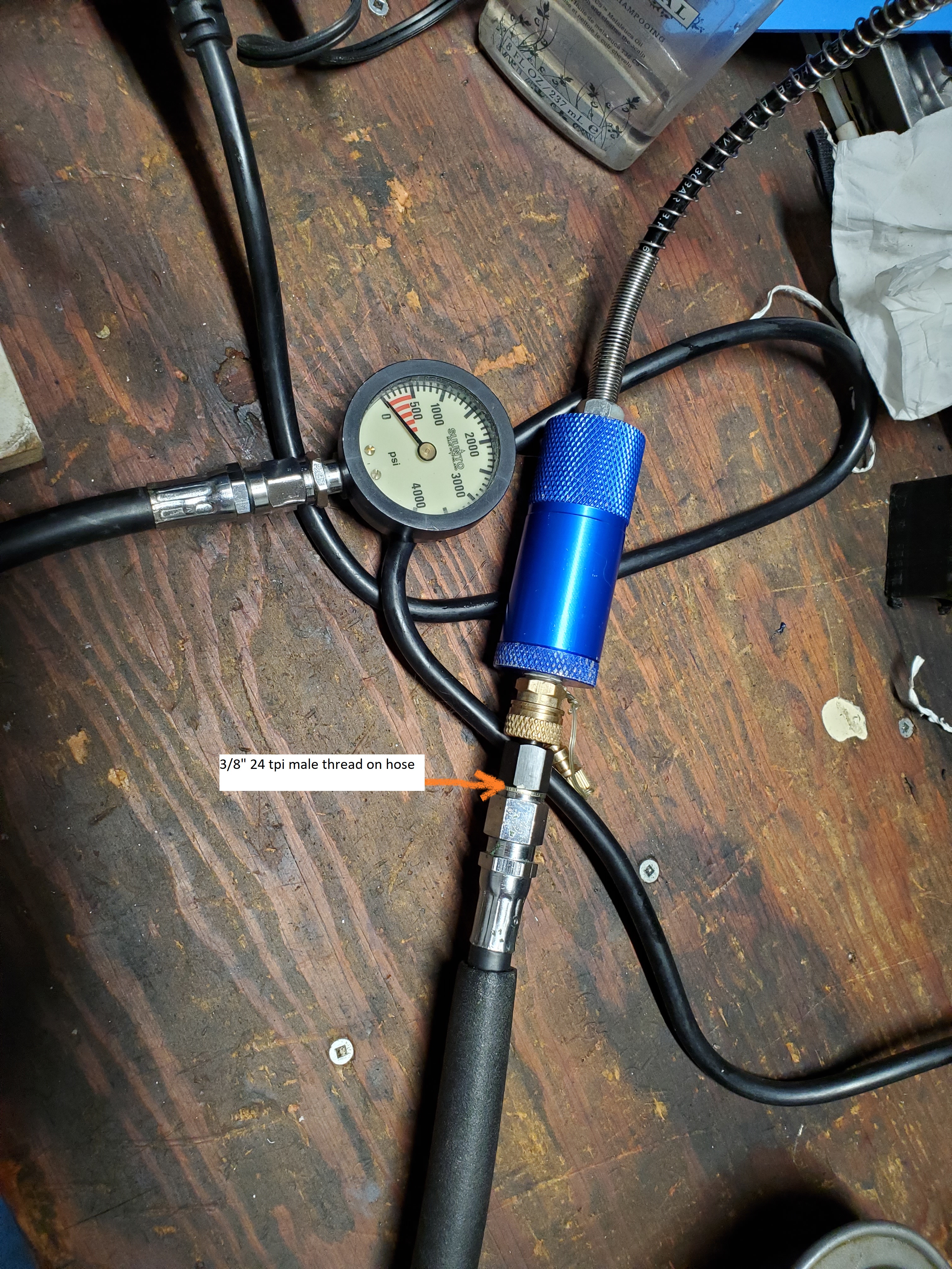

I guess a guy needs a guage that plugs on the the hose end to check line pressure to compressor gauge pressure .. guages are cheap enough to fix one up for testing things .
I made a test gauge by threading a Foster male coupler onto a SCUBA pressure gauge. These are a dime a dozen in the surplus stuff at dive shops. Very good quality gauge and hose which never seem to fail, and no one needs another one. This was coupled to the outlet on one of my YH compressors.
