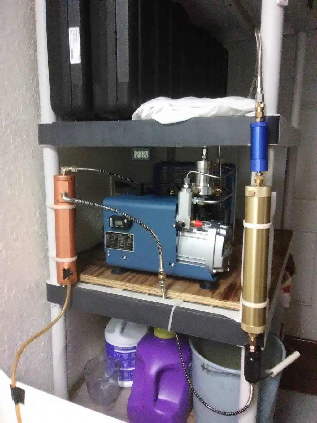

Fly,
Here she is. The copper colored water-separator ($125) by back wall is for high humidity in Florida garage, however, most go with just gold filter ($59.) There is a 10" box fan beside compressor. I use a 5 gallon bucket, on a stool, inside laundry sink for cooling water and ice jugs.
