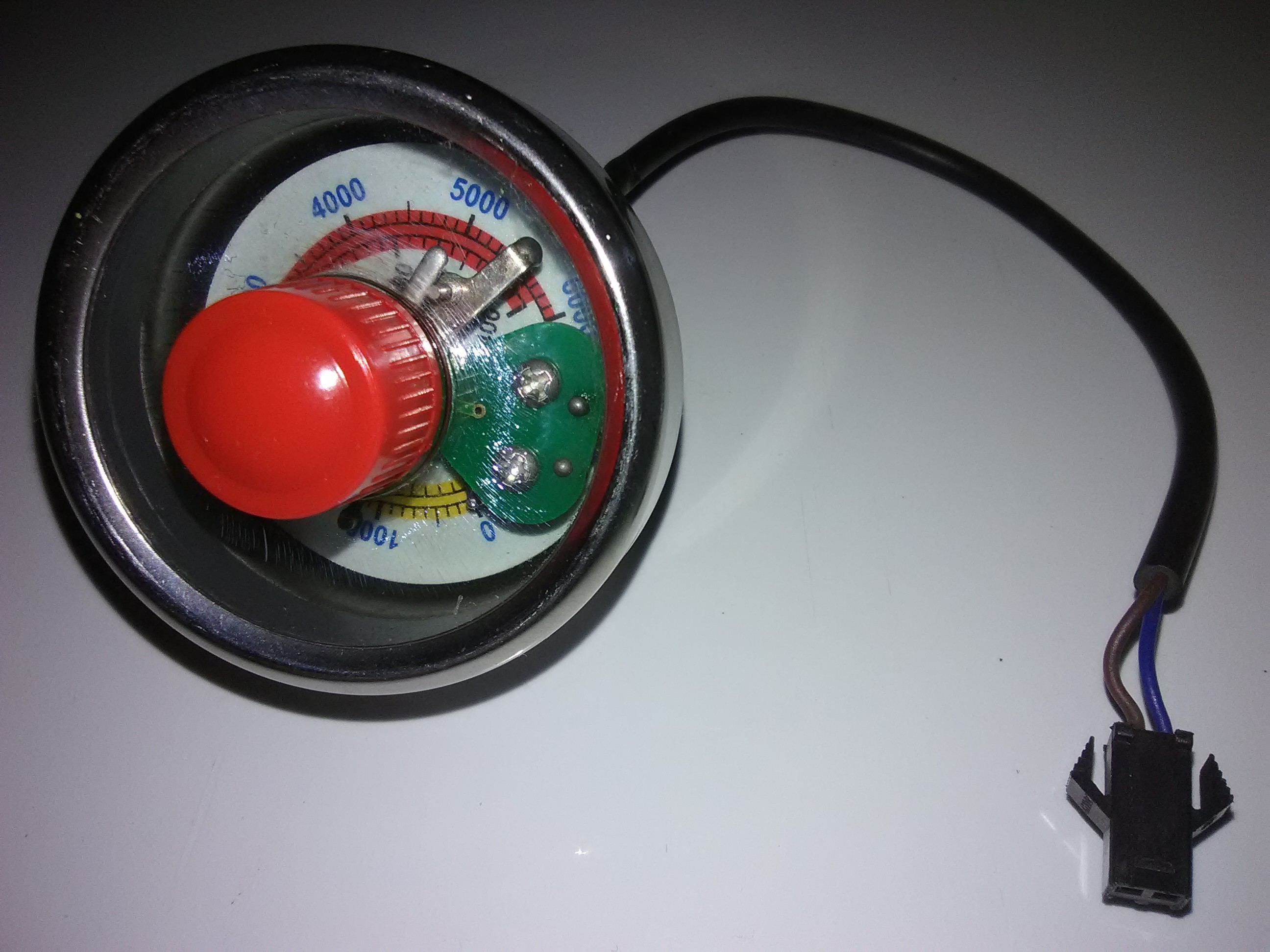

Here's gauge from Set Pressure model Yong Heng, only lasted two years due to heavy vibrations. Replacements can be found on eBay (Search "Yong Heng parts") for not much. Has 10mm parallel threads that tighten down against white plastic Delrin washer in threaded hole. If similar in appearance to yours, might try picking one up. WM
Here's gauge from Set Pressure model Yong Heng, only lasted two years due to heavy vibrations. Replacements can be found on eBay (Search "Yong Heng parts") for not much. Has 10mm parallel threads that tighten down against white plastic Delrin washer in threaded hole. If similar in appearance to yours, might try picking one up. WMView attachment 419812
Well this gauge actually looks a bit better quality wise then the one on the Vevor compressor. Thank you for the suggestion. And although I don’t disagree with Gerry52’s advice I really like the auto shutoff option as who wants to sit there and babysit a pump?

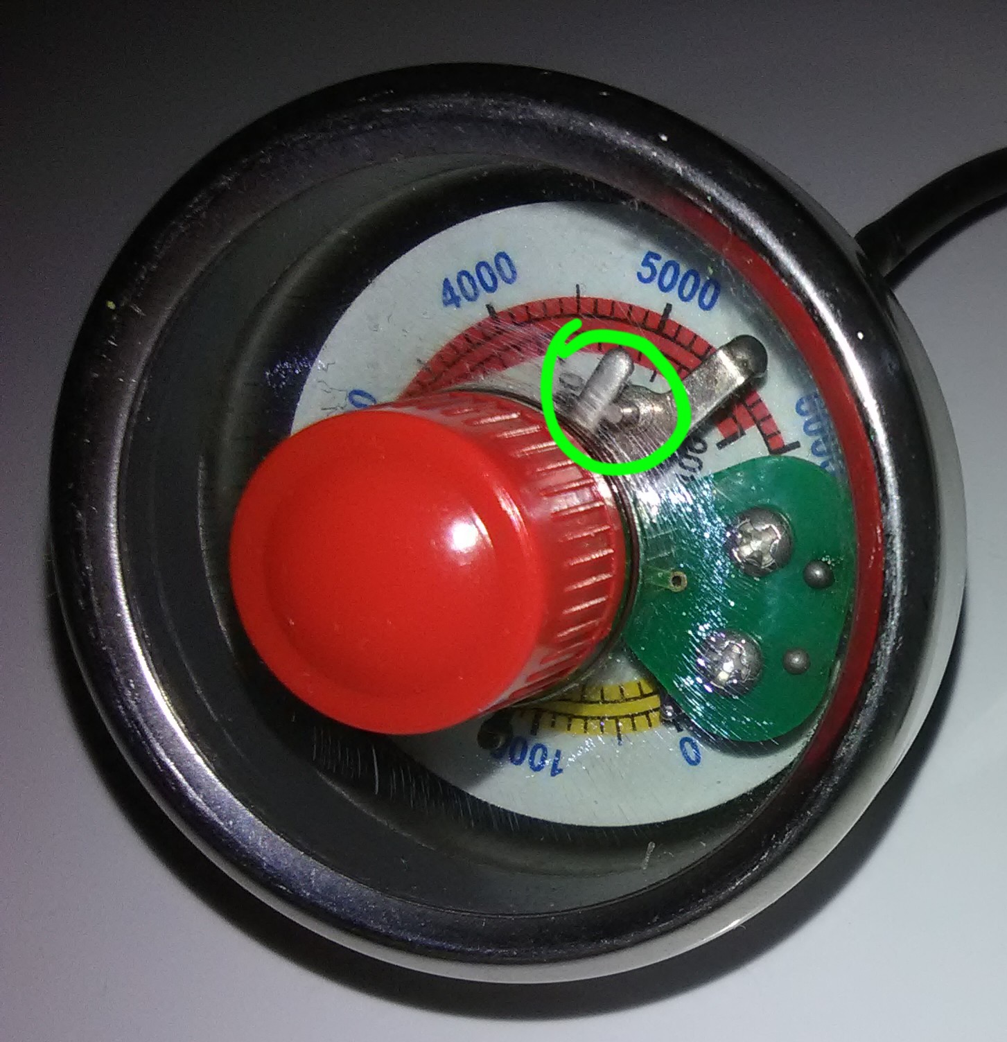

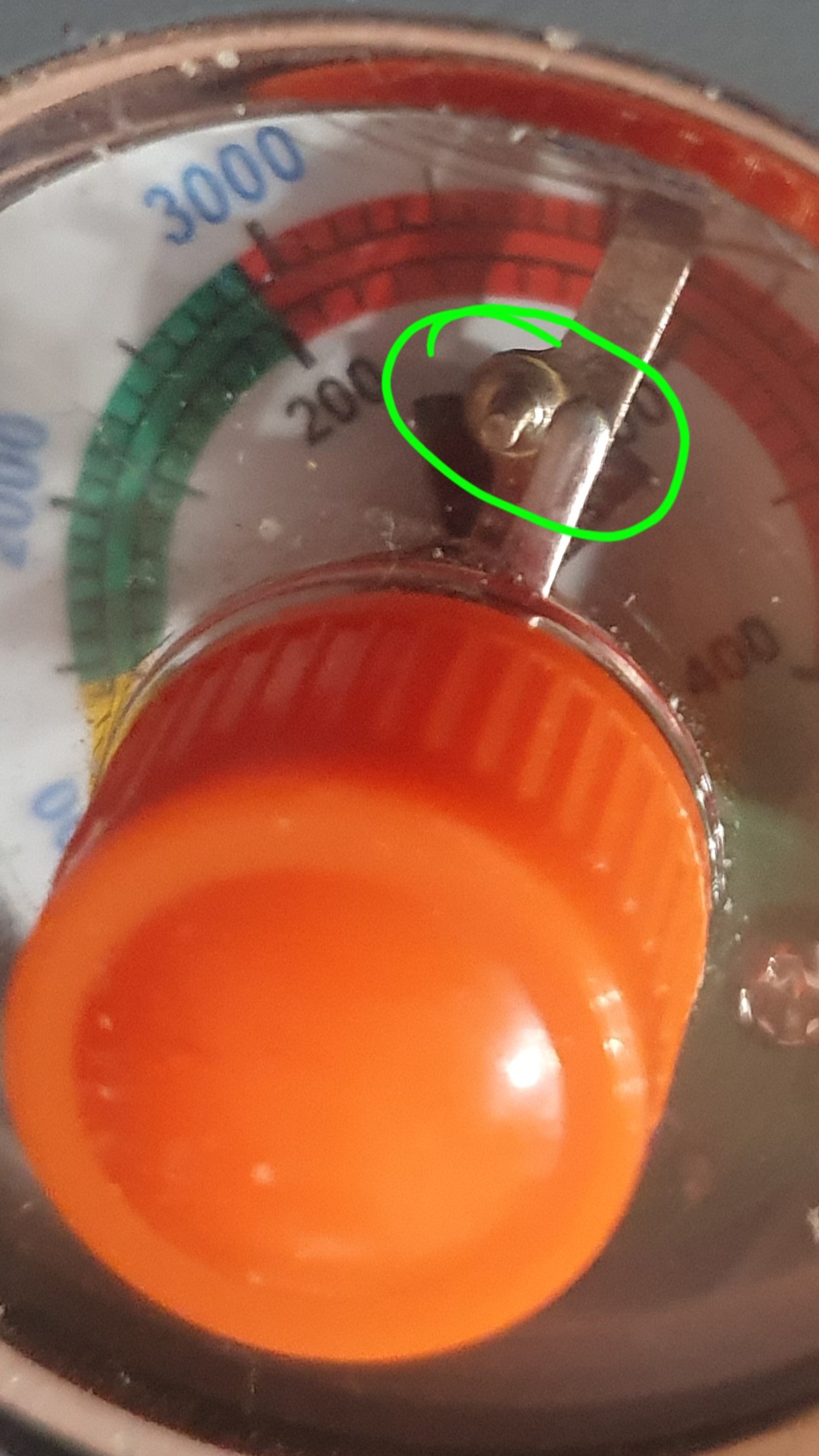

i drew a circle on the picture recently posted.
the set point marker has a pin on it,
the red knob has a little arm on it that pushes against the pin on the set point marker,
the red knob itself doesnt move the set point marker.
if you go past your intended set point,
you have to turn the red knob back in the opposite direction until the little arm comes back around and makes contact with the pin to push the marker in the other direction.

Think these gauges are from same manufacturer, in fact, I replaced the broken with one from the above-mentioned hand pump, just screwed right in, works great. I'm with Gerry, with PPE eye and hearing protection, I never leave filling unattended. Once had return cooling hose slip out of water bucket, if absent, water to floor, compressor overheats. Just saying, WM
