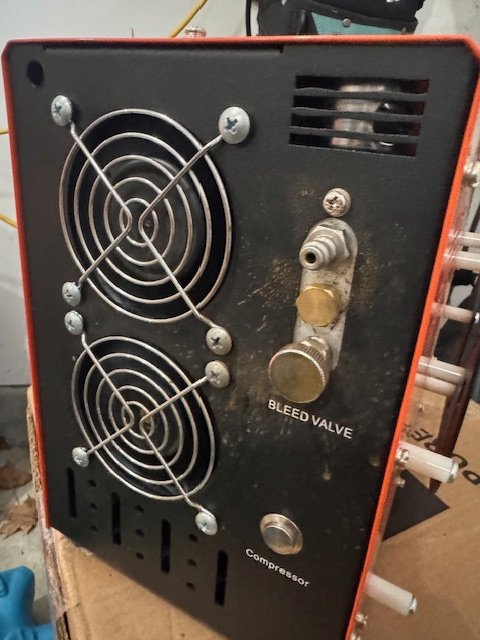

So my compressor stopped working properly.. 5-months old. It will fill but very slowly and then when I turn it off it depressurizes, so I think there is a leak somewhere and I have this brown residue shooting out of the bleed valve.

You can source a new motor and piston fairly cheap on Amazon. I have a nice single piston housing, you'd have to get new ring seals or just replace the piston. I also have the block and copper piping to reassemble. Looks like lots of moisture has been taken in. On the side of the cylinder housing is an intake screen.. you can directly thread on a small oil/water filter instead. Youd either have to leave metal housing off or cut a through hole for it.
I would gladly send you the piping and Cylinder/housing... Just cover the postage.
If that is the problem. Usually the cylinder, piston gets really gunked up and slows the filling process or the copper coils and brush in the motor burn out
Thanks for offer. They sent me a video to disassemble / clean something. I’ll see if I can open her up and identify issue.
Wasn’t going to do that under warranty but now that it is essentially free no harm in tinkering.
