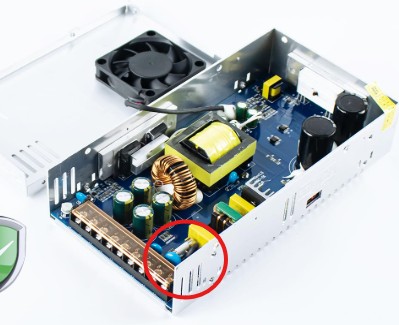

The unit is a black box with VEVOR on the top, It has a small external silver power box attached with a power cord to outlet. I would love to find the fuse.
I posted some photos showing replacement of a thermister on one of my power supplies, and the fuse should be obvious. If you cannot find, let me know and will post them again.

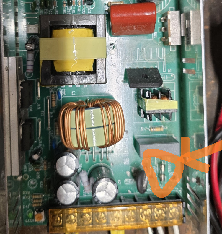

I will show the thermister photos first, then find some better of the fuse, it needed.

My Nuong compressor's power supply failed (*The Nupong is a clone of GX CS1 and a zillion other shoebox compressors).
I have a spare power supply, but of course I wanted to fix the problem.
A lucky flash of red showed that the NTC 5D-15 negative thermister in the input stage was failing.
I ordered these off Amazon, so will only need to remove the circuit board and solder in a new one.

I have a short video, showing the other side of the fried one, but the one in my spare shows the thermister better.
The fuse is circled in orange in the second photo. It is to the right of the fried thermister.
I suspect that the thermister will be a failure point.
When I convert one of these power supplies for other uses, I often manually blow the Buss (glass) fuse and solder leads to an external ATC or Mini Fuse holder in order to place the fuse outside of the case. I have encountered only one or two blown fuses in 10+ years of using these power supplies, so they aren't a high failure item. If I recall correctly, these power supplies are self limiting in terms of voltage and current.
The little potentiometer with its yellow dial is to the left of the wire terminal strip, it adjusts the output voltage which can often be increased to nearly 15 VDC. Electric motors tend to like higher voltage so I generally try to have the voltage in the 14.6 VDC range, which is typical motor vehicle charging voltage.

If you need to remove the circuit board from the case, the power transistors, or might be MOSFETs (can't recall off hand) are clamped to the heat sinks. If that's not obvious, let me know.
