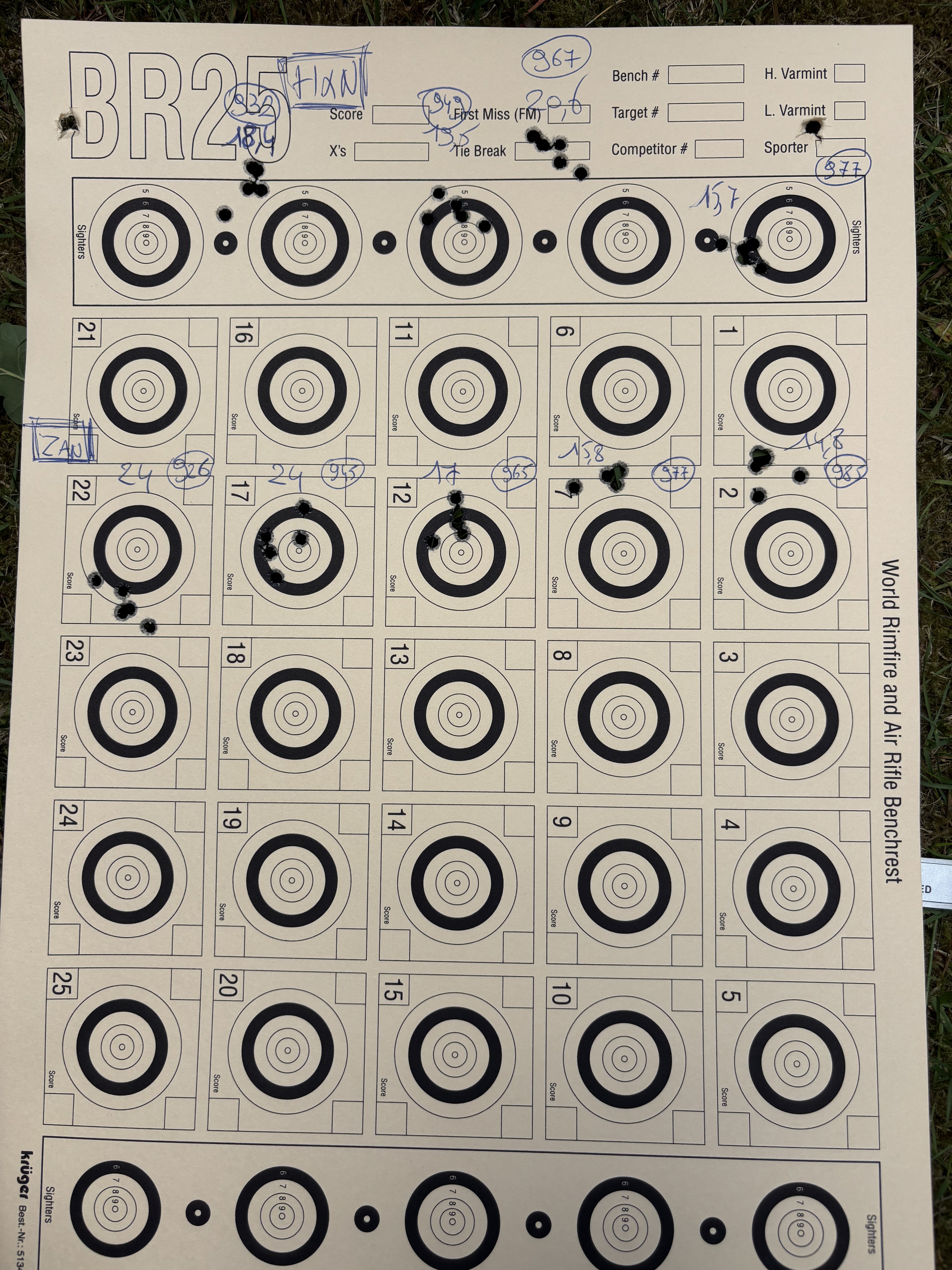

I have the same gun tested 20 diffrent slugs the best were the h&n .250 38 grain sub moa at about 930fps and the zan 37 .250 close to submoa
also a picture where i tested fps and accuracy at 70meters (group size is in mm and fps is with circle around)
hope this helps

Thanks!! I will check and see if I have any of those slugs.
