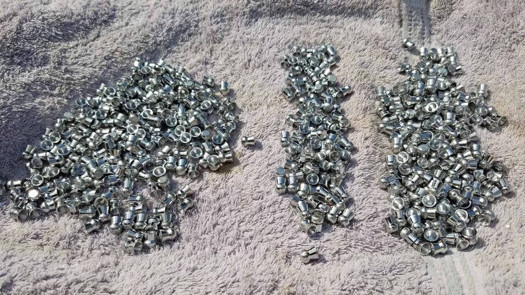

I just purchased a NOE 30 caliber pellet mold. I will be trying to get them to shoot straight hopefully in the coming days out of my 700mm STX. Looks like between 46gr and 47gr with these casts, but do have two other different pins for heavier weights. I cast these today.
Wow those look great can I buy some ?! Let us know how they do!
Thanks Eric! I am a long ways from selling these, nor would I sell them (a lot of work), but if they turn out worthy enough I would be happy to send you some for free being you gave me the time of day, and were the first to ask. I don't know if I can get them to even group well yet.
I did already cast a few and tried them. Groups tried to form tight on some, but overall a roughly two inch group at 52 yards. These cast are far better looking than my first run though, so fingers crossed...
I have that same mold TT, the deep skirt ones i found do better than the heavier shallow skirt. These are my best shooting cast projectiles. Dont bother with that barrel shaped .30 mold from NOE. They are all over the place.
I size those pellets to .299
Thanks! That's good info for me and others. I won't bother with the heavier pins then. I have already been there with the BBTs, and is why I got this mold. .299 sounds good!
What groups sizes are you getting at distance?
Something like 3/4 inch at 50m, thats all ive shot them at so far.
