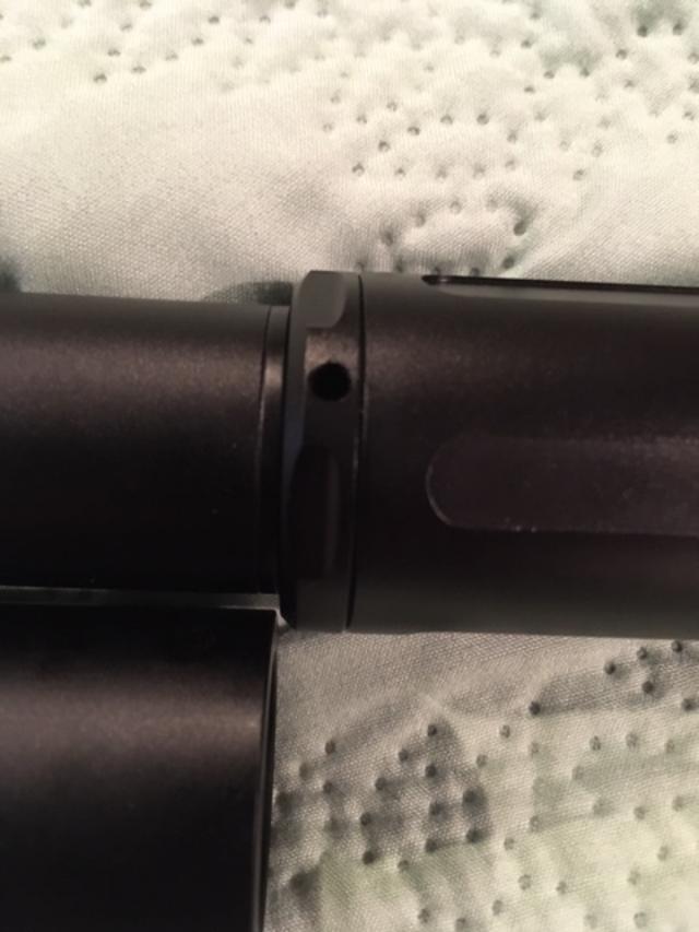

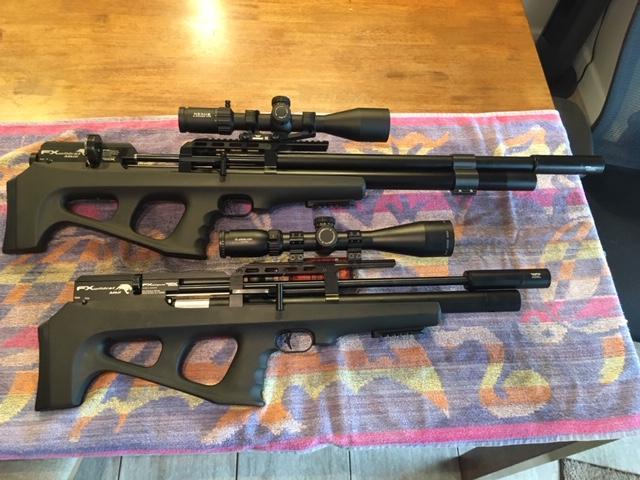

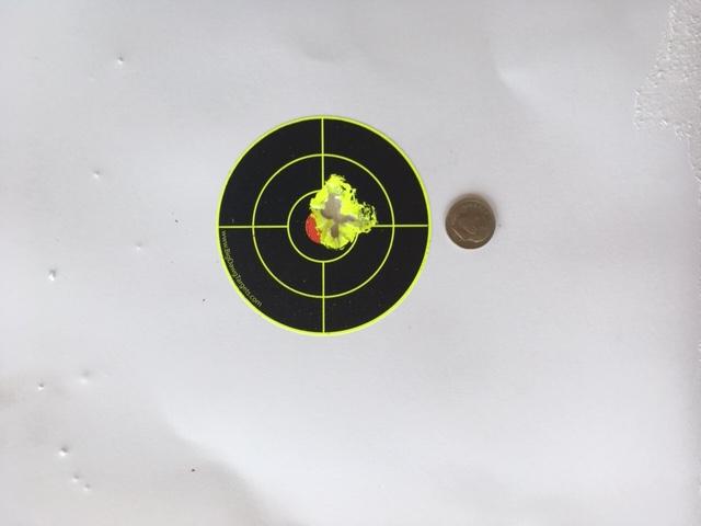

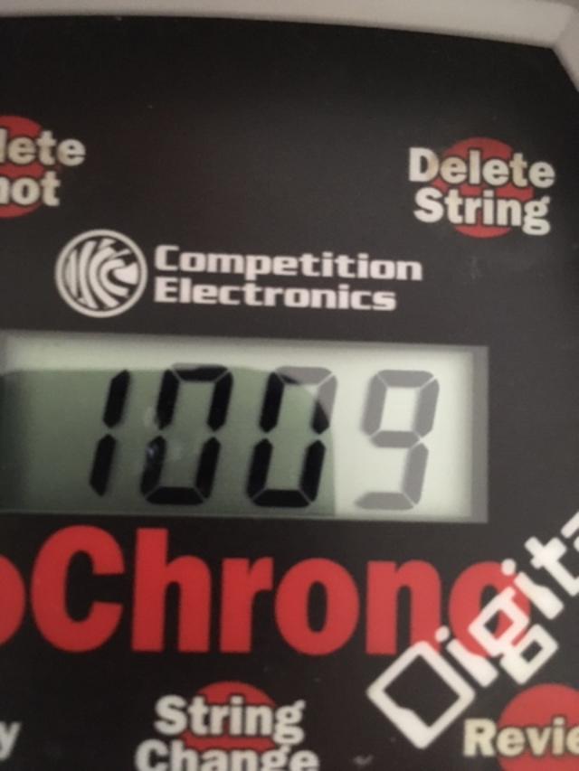

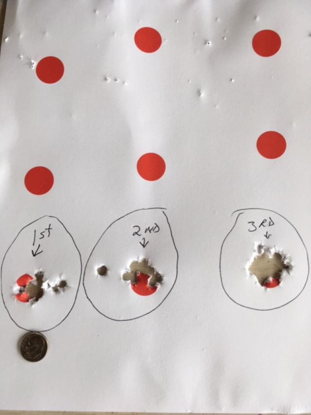

I tuned my .25 cal WildcatMK3 sniper with guidance From JoeKool here on the forum. I purchased and installed a Ernest Rowe plenum extension, barrel brass dual transfer port and a barrel band. Reg is now set around 125-130 bar. On power wheel setting 7 I'm getting over 1000 fps with the 25gr kings and 900+ with the 34gr heavy's. The following pics are @60 yards 16 shots (1 mag) per dot. These were straight from the tin no wash/lube/weight. The shots outside the groups were probably me.
Awesome tune! Running more efficiently now. What were your numbers before the tune?
Damn good shooting too👍
Yes more efficient getting around 50 shots on reg from 230bar fill and thanks legionair. The gun was originally set up with the smaller plenum, factory TP reg was set 145-150 shooting around 900fps with 34s and 32 shots per 230 bar fill.
