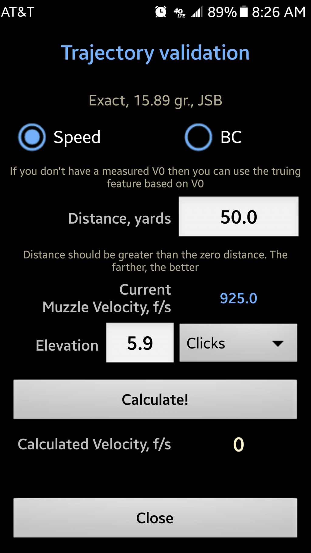

If you don't have a buddy with a different crony that you could barrow to double check your numbers you could use an app like Strelok Pro, sighting in at one distance and measuring the drop to a farther distance and see what it says.

That's how I became suspicious of my chrony to start with. I do a lot of shooting out to 1,000yds and the trajectories I was getting on paper didn't match up with what I should have been getting with my chrony readings. It seemed like it was reading about 10% higher than it should of.
