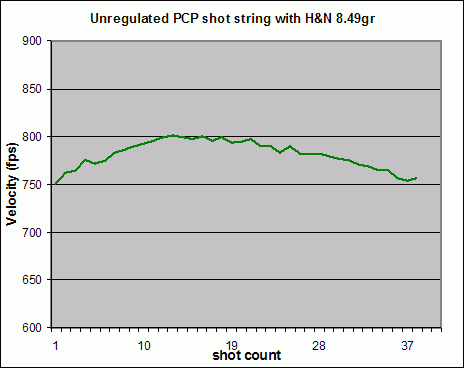

Sounds like you're describing a bell curve, starts out a bit lower then raises then lowers again as the pressure decreases. At the beginning of the tank/bottle the hammer is opening the valve but there's more back pressure so less velocity, as the back pressure decreases you get a increase in velocity.
Like so.
