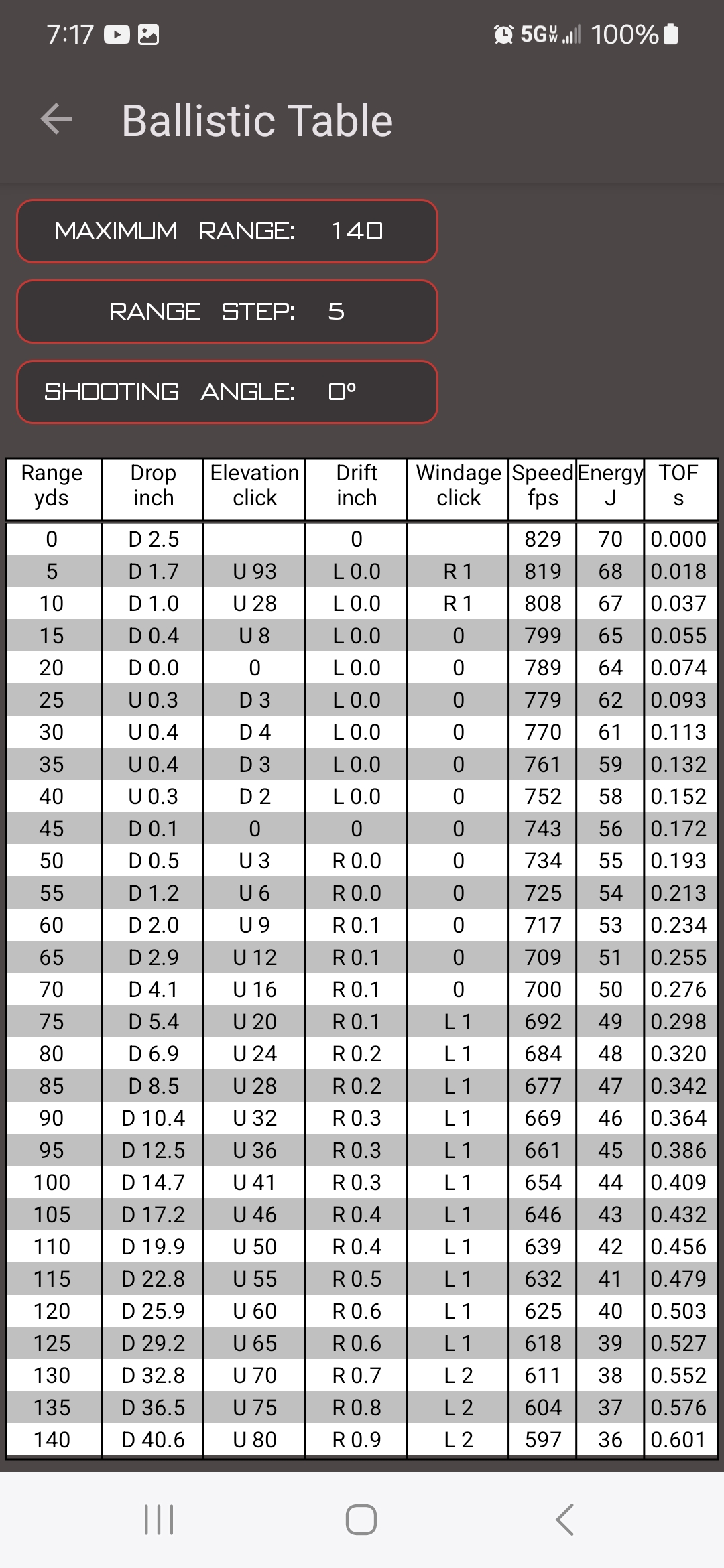

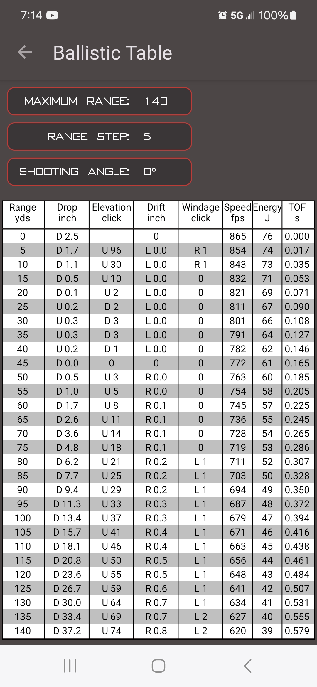

At 100 a 30fps drop is .5mil difference in drop. I'd call 1.8" off a flier. In terms of hunting... that's still near 1"@50...the difference between hiting or missing a house sparrow, heart shot or low gut shot on a starling, or braining a squirrel or just removing its jaw.

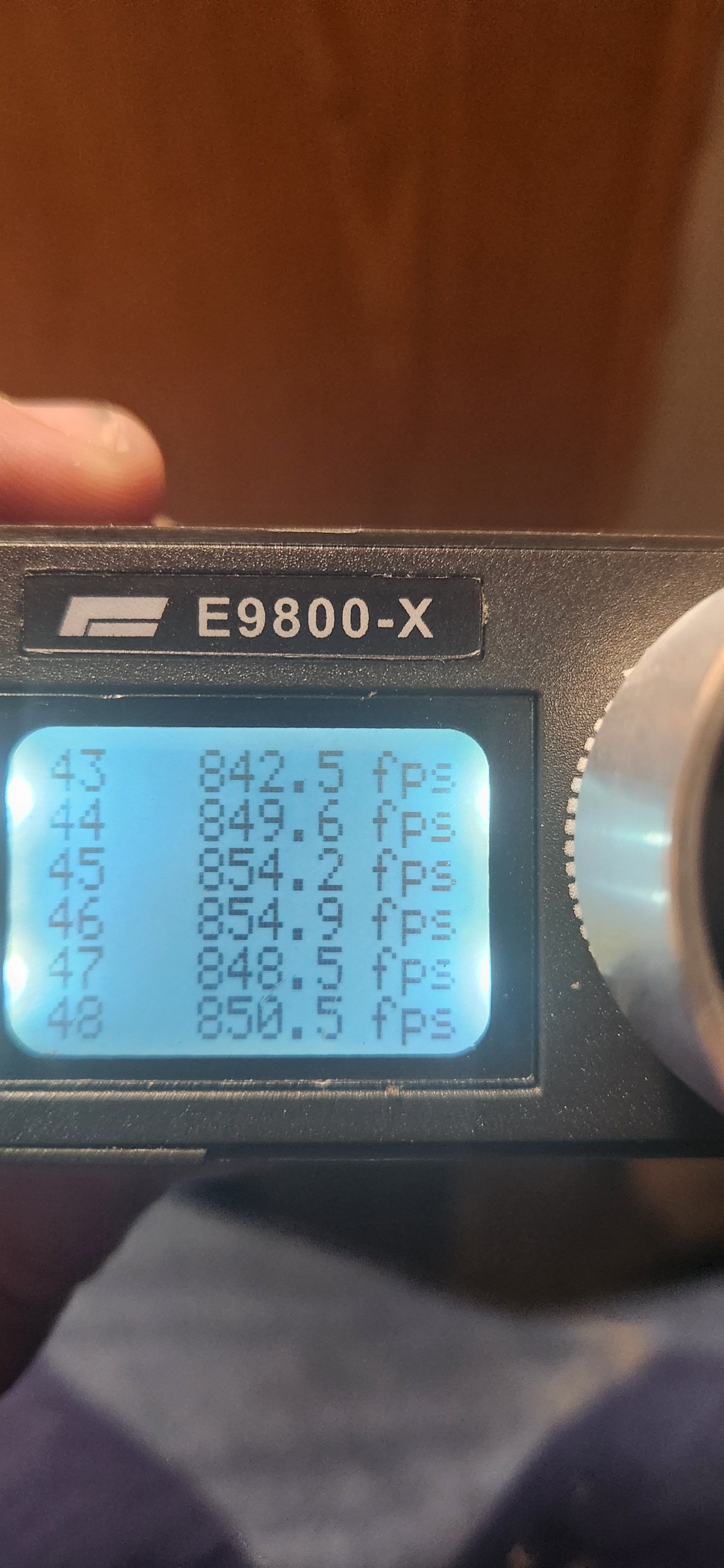

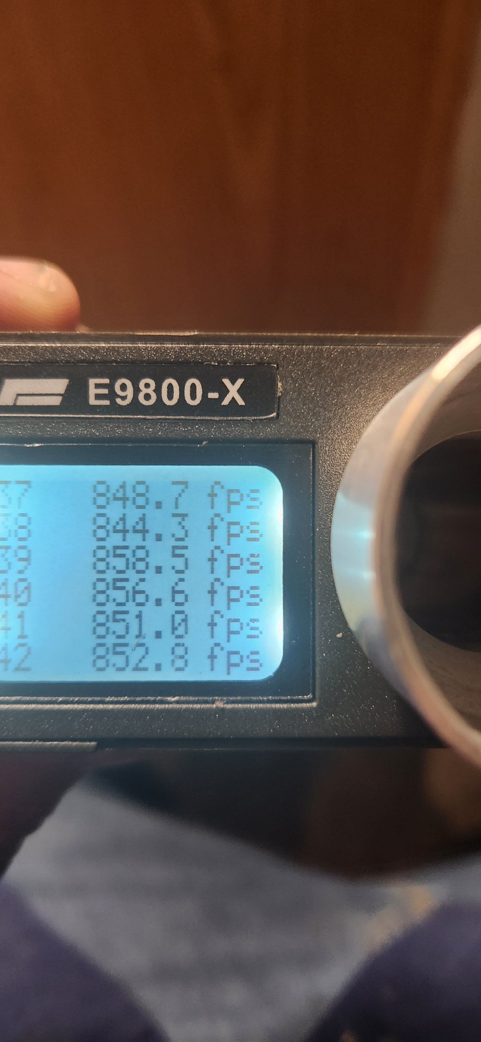

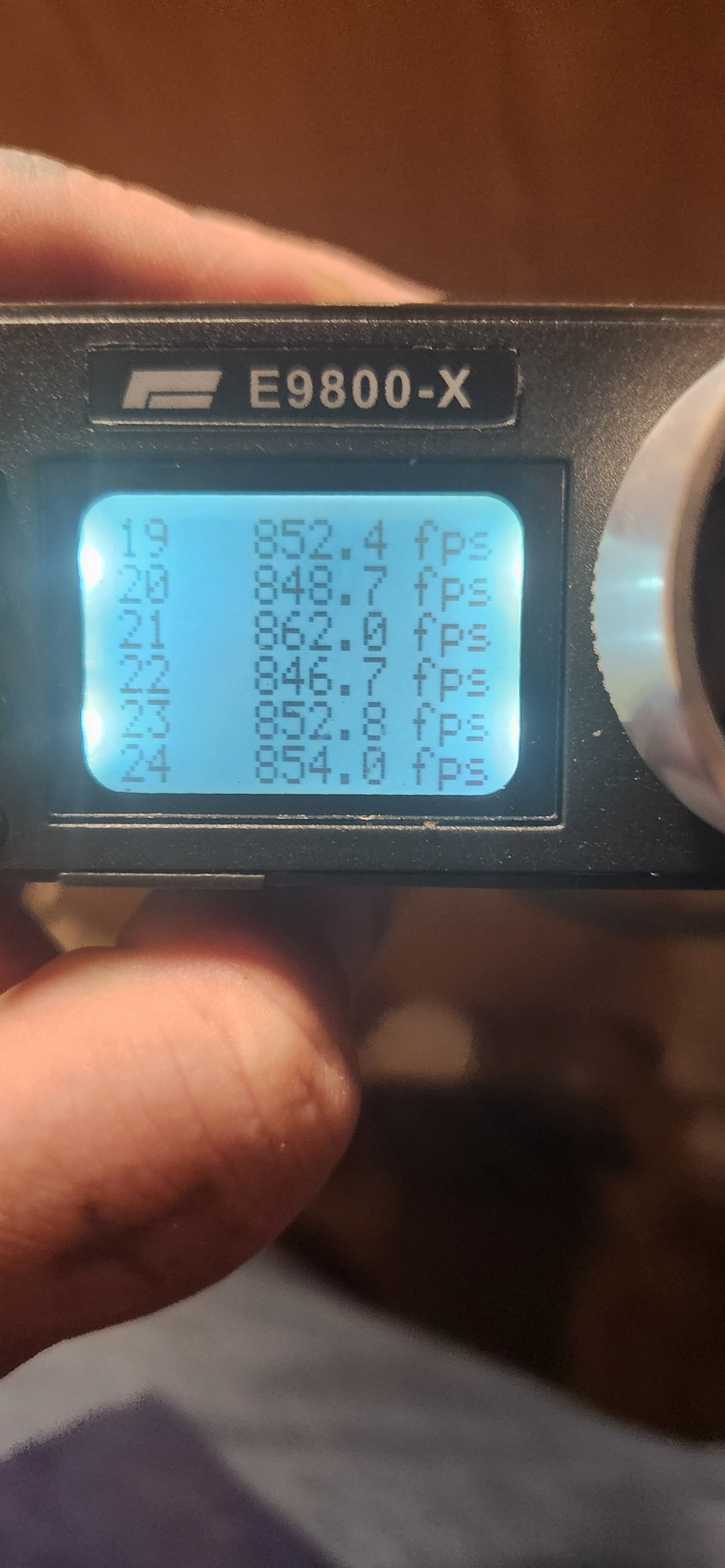

Is it possibly a chrono issue. Since I'm having very satisfactory accuracy and I'm more than happy with 860fps 6 turns on the external hammer wheel down from max. Position 1 is roughly 530fps, max nears 940

I think it was just a very slight internal hs adjustment one tiny 1/16th or maybe 6-8⁰ turn did it. I am content with this....

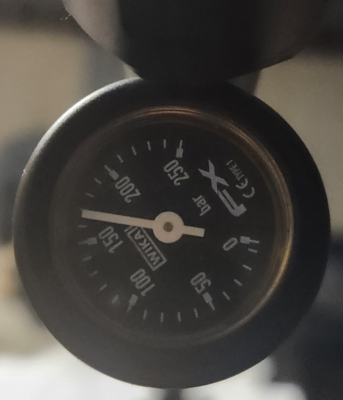

No more extreme jumps. 48 shots and this is how much I have to spare from 230
