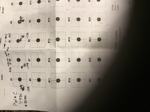

Recently when shooting my impact with slugs then changing over to JSB 25.4’s without adjusting the setting, I shot some amazing groups at 50 yards running 970 fps.
I haven’t shot it any further but I can’t see why it would get any worse at distance..
Here is the target, slight Left to right breeze. First group 5 shot with the rest 3 shot. I adjusted the scope after each group and went the wrong way once.
I’m running 130 on the reg, 4 on the valve (.400”) and C on the power wheel for the JSB’s running at 970. (PW on max at .610”)

That speed makes sense. My Red Wolf liked them at 940 on the factory tune and then 980 on the Helliboard.
My Crown currently likes them around 930-940 slightly better) and 910-915 at 50. I have been testing them a bunch at 50 on different days to make sure the settings aren’t a fluke. Just have to take it out to 100 and see if it still likes them.
I haven’t tried to get them to 980 on this rifle, because I like being able to shoot 18s extremely well also.
