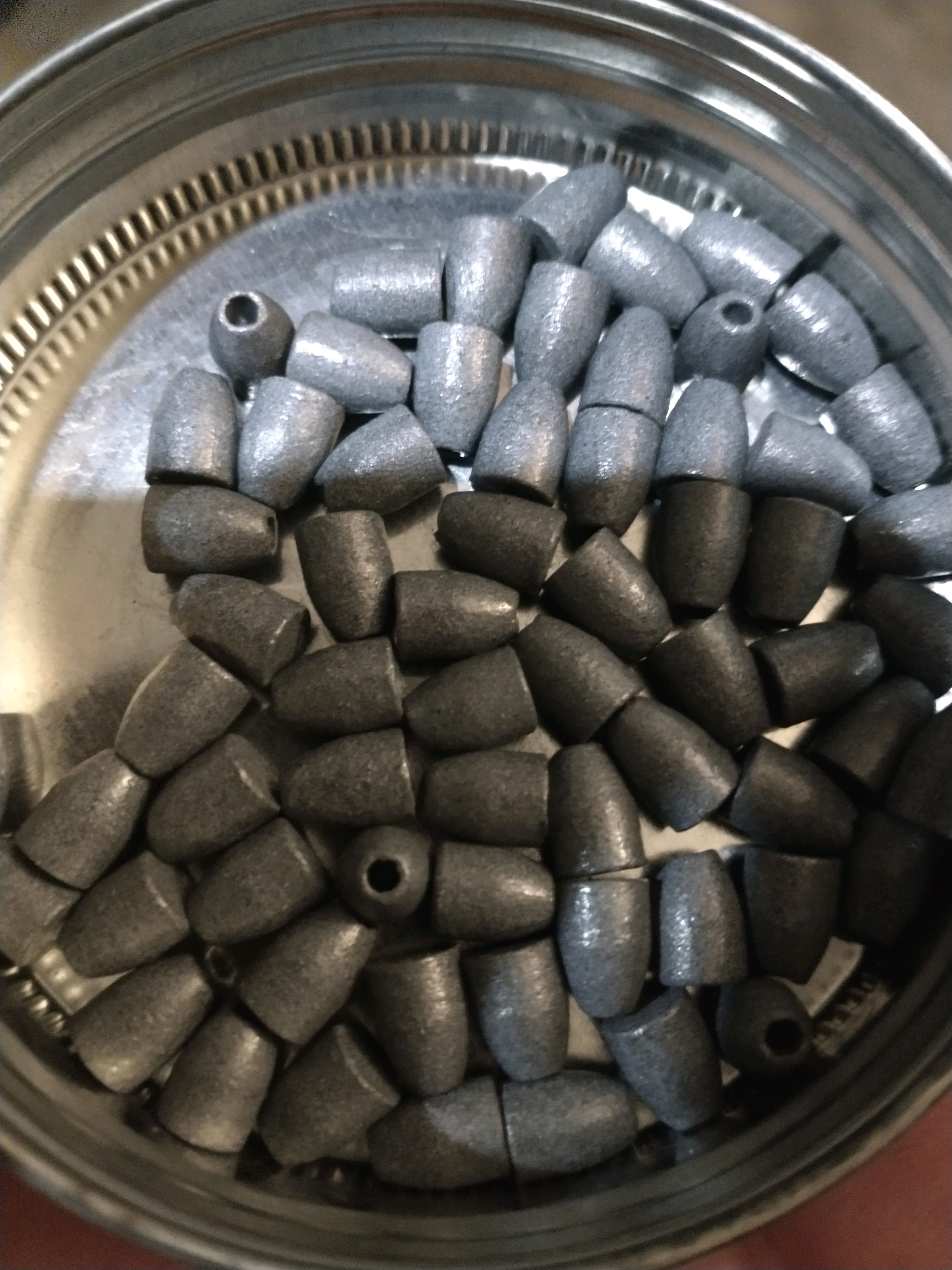

I cast for everything I own and I play around with cat sneeze loads. I powder coat almost everything too. You'd be surprised at pressures pure lead can take when it's powder coated. Add a little tin and it keeps those beautiful mushrooms from breaking up too. View attachment 307184
I cast for most of what own but shoot about 98% cast to jacketed. I powder coat everything and don’t think I’d ever go back to the old sticky/smokey lubes. I’m using pine logs as back stops to collect and re-use all of my lead “someday” and it’s amazing the paint doesn’t come off after firing, even hot loads. What mold are you using for these slugs? They look great, tell me more!

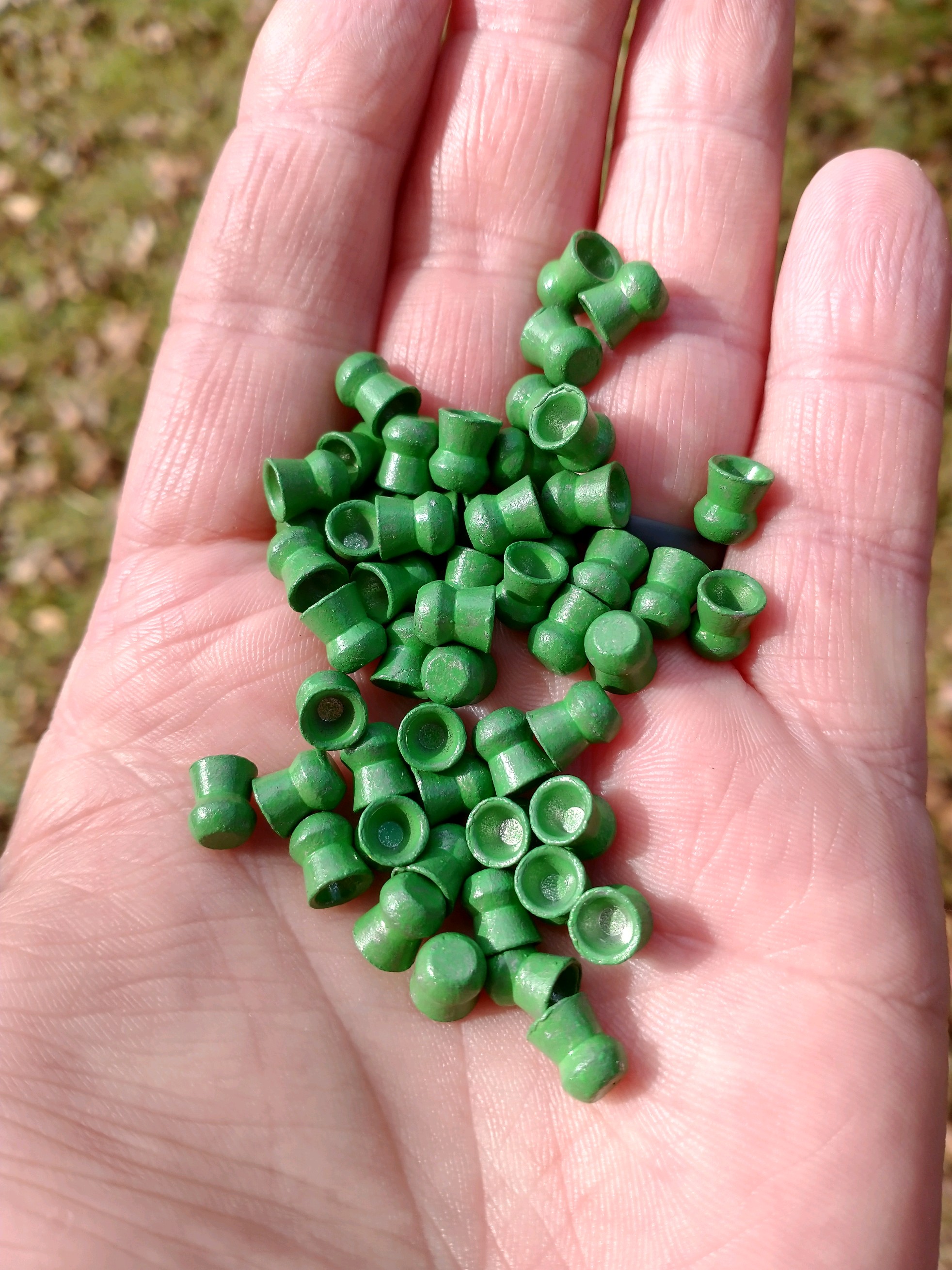

I linked the mold beneath the image. The slugs are powder coated with Eastwood squirrel gray. I even powder coat my cast pellets. :ROFLMAO:View attachment 307202
Nice! I don’t have any NOE molds but it looks like I may be buying one… :) I’ve only used Eastwood powder and have no reason to switch. Ford light blue, periwinkle gray and gloss black. Gloss black doesn’t work well by itself so I mix it with the other two. When it’s gone I won’t buy it again.
NOE really caters to airgunners. I have it on good authority that he is planning to start making swaging dies too. I'm $40 away from being in the NOE $1000 club. 🤣
I've had the same results with gloss black. I stick with polyester tgic powders for best results.

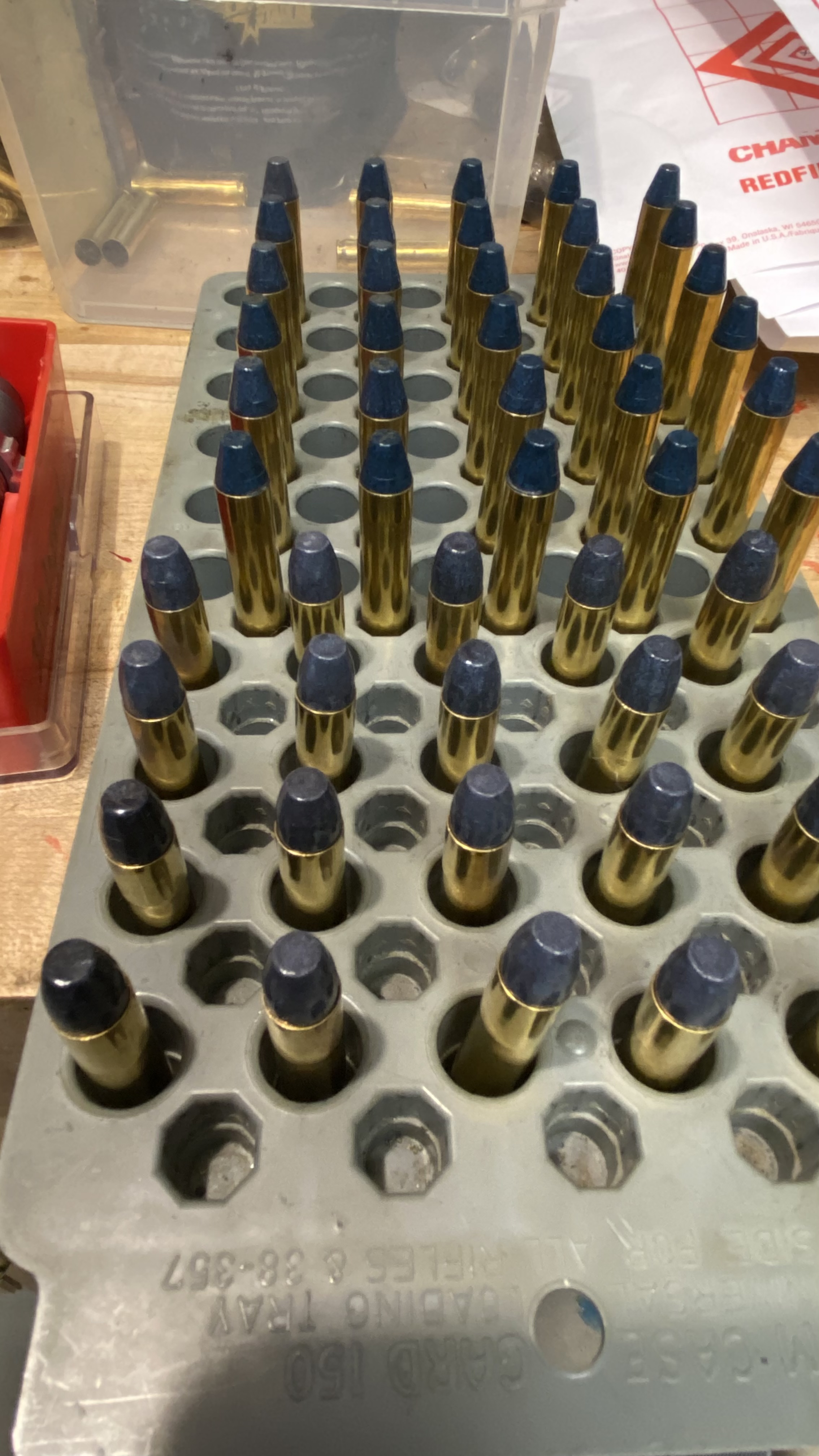

My latest project... Lee C358-200-RF in 350 Legend, IMR 4227 and small pistol primers. This would actually be a great gun to have a suppressor on, CVA Cascade and the barrel is threaded. I shoot this gun A LOT! The loads in back are using a 127gr 9mm bullet sized to .358 with Alliant BE-86 or Unique. Deer hunting load and plinking load.

What are you shooting these out of and was it difficult to get them shooting well?
My .25 Flashpup shoots them well. My .25 Stormrider is a little underpowered for them but it doesn't do bad either.
