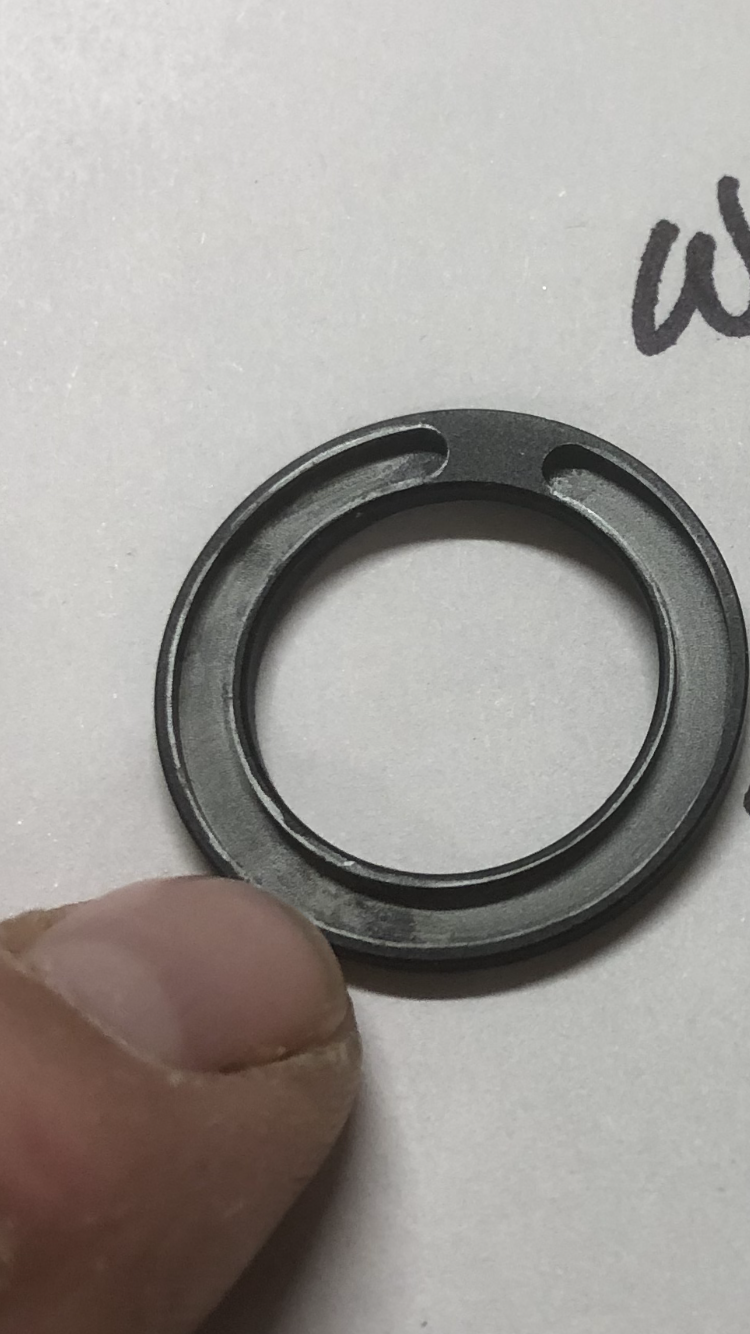

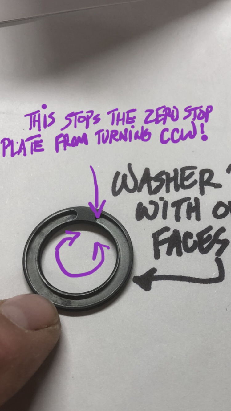

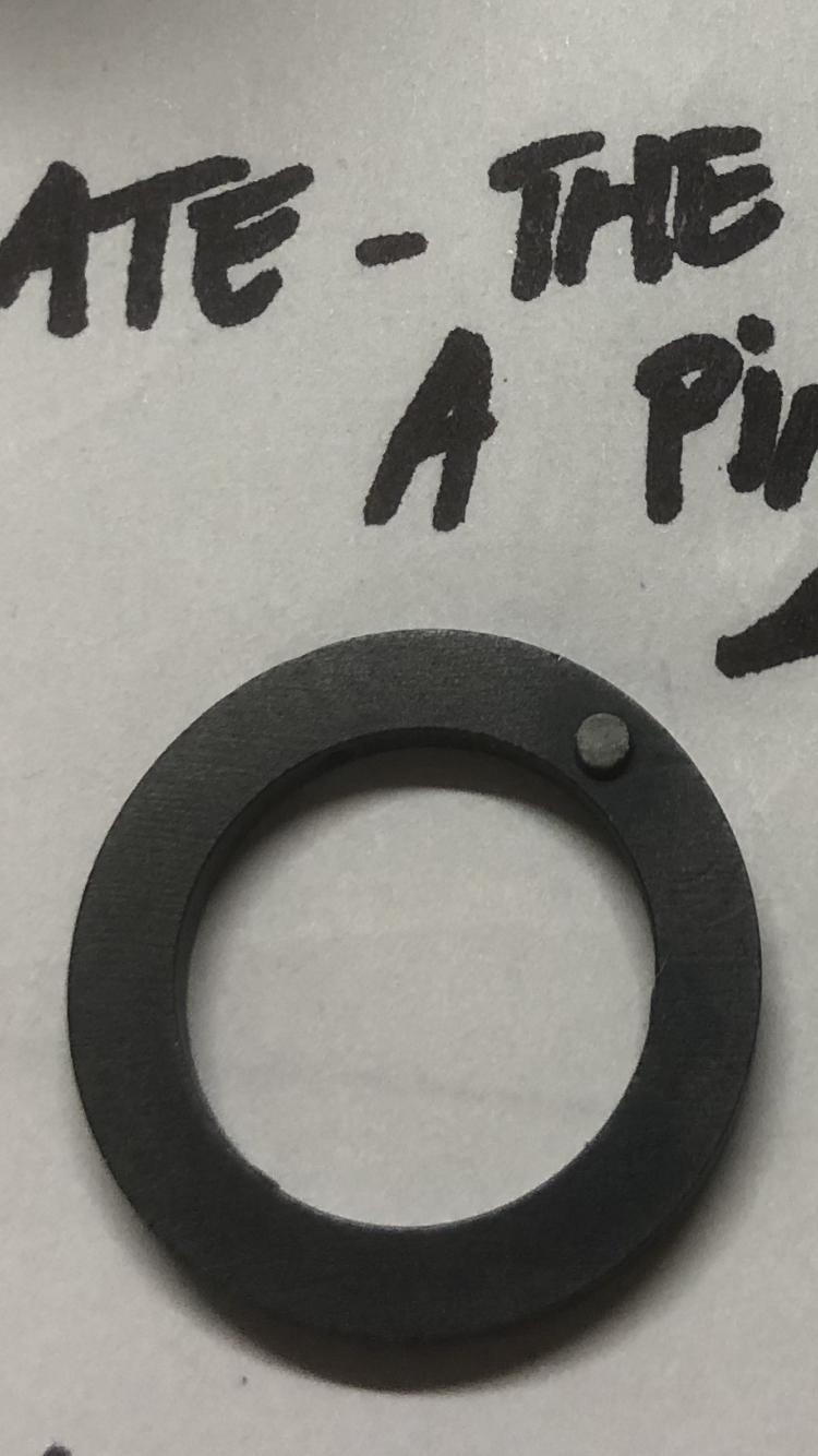

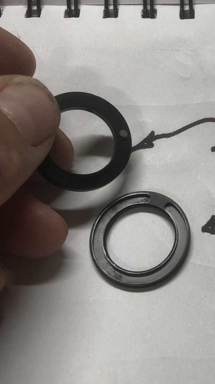

Anyone here using this scope? The zero stop function, omg, what is up with that? For the life of me I can’t set it so it allows me limitless revolutions of the elevation turret CCW upwards, like all my other scopes can with a zero stop. This X-pro I can only get about 3/4 of a whole turn upwards past my zero stop set point. Any users of this scope having or seeing this same issue?
Mike, I followed the install instructions and when that didn’t work for me, I reached out to vectors tech support and they were very very helpful, but it still didn’t work out for me. See, it’s the design of their zero stop. Yes it will stop when turning the elevation knob to your preset zero(mine was at 50 yards), but to adjust upwards I only got just under one whole revolution and the elevation turret would come to a stop like it had a zero stop to raise upwards, also.
Unlike my delta Stryker that was also zero’d at 50 yards, I could adjust upwards(CCW) as many turns as I want, then rotate cw back down to my zero cause that’s what zero stops do!!
@Bigragu In your opinion is this a design flaw or a QC issue with your unit?
