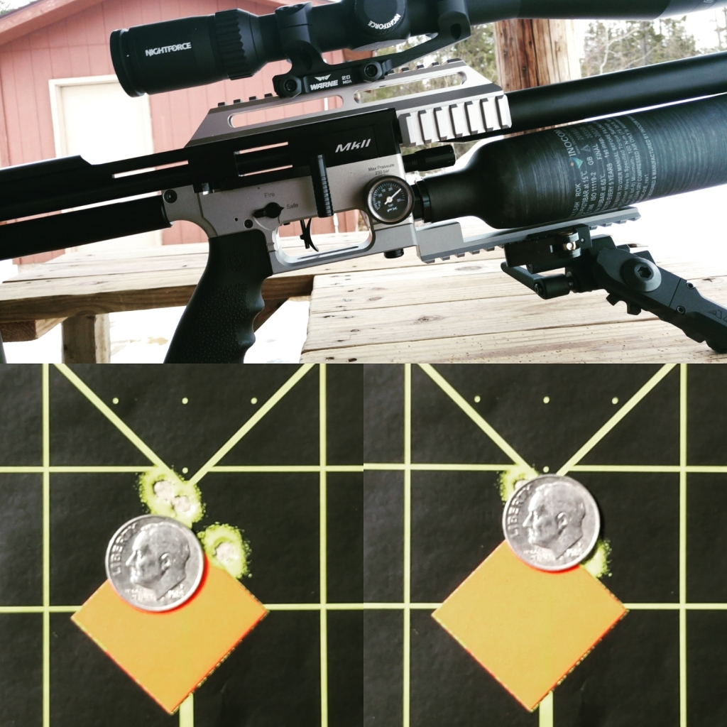

Varmint Knockers 28, 30 and 31.5gr are good for FX slug liners
Test platform:
FX Impact MKII 22, 700mm slug liner. 10mph wind quartering from the rear.
100yd groups.
30gr
31.5gr
Both tested successfully in the field at 134yds.....they fly true at 944 fps (30gr) and 920fps (31.5gr).
