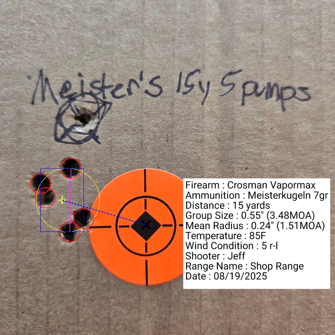

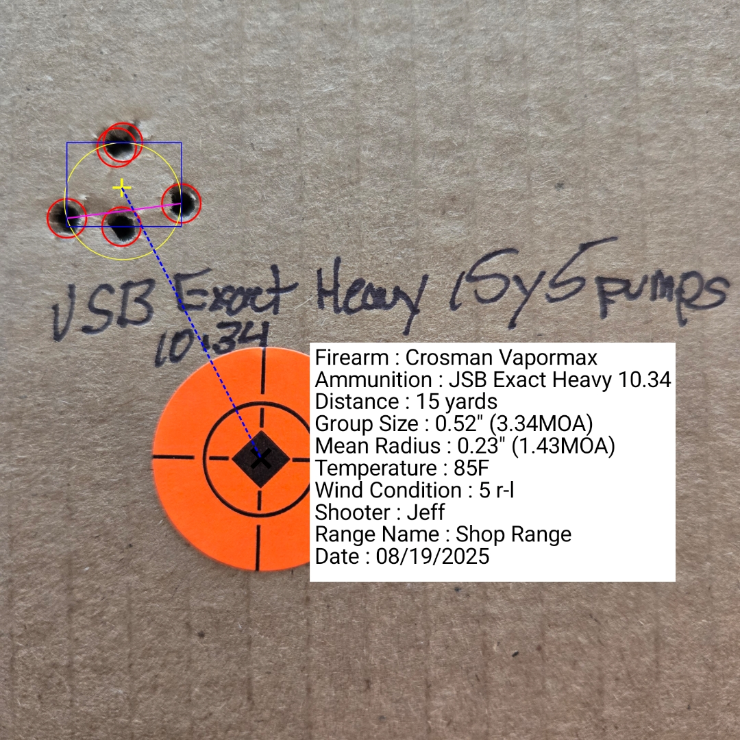

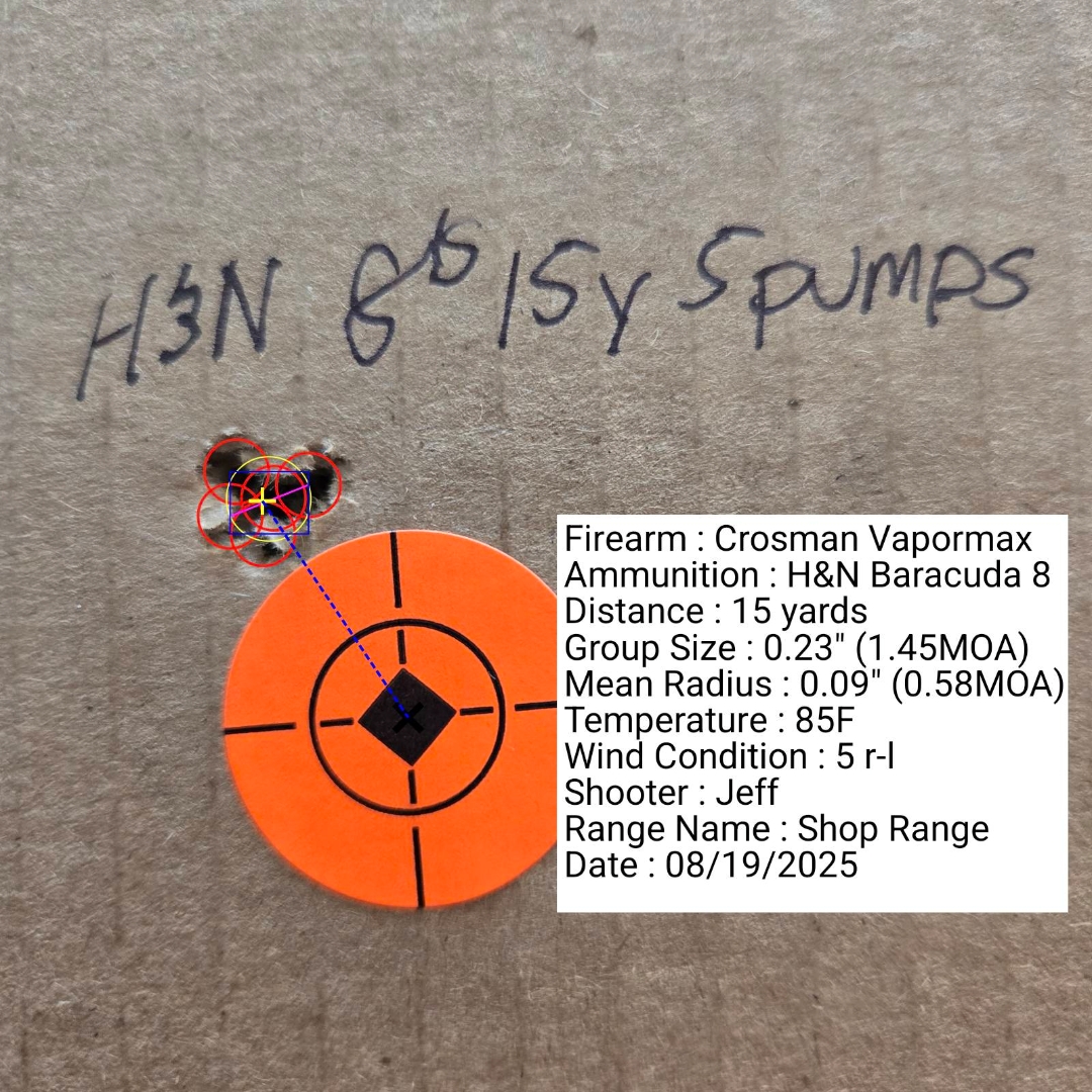

Here's some targets shot at 15 yards with 5 pumps and open sights straight out of the box

So far I'm really liking this, I will be putting a scope on it so more accuracy testing to come.
