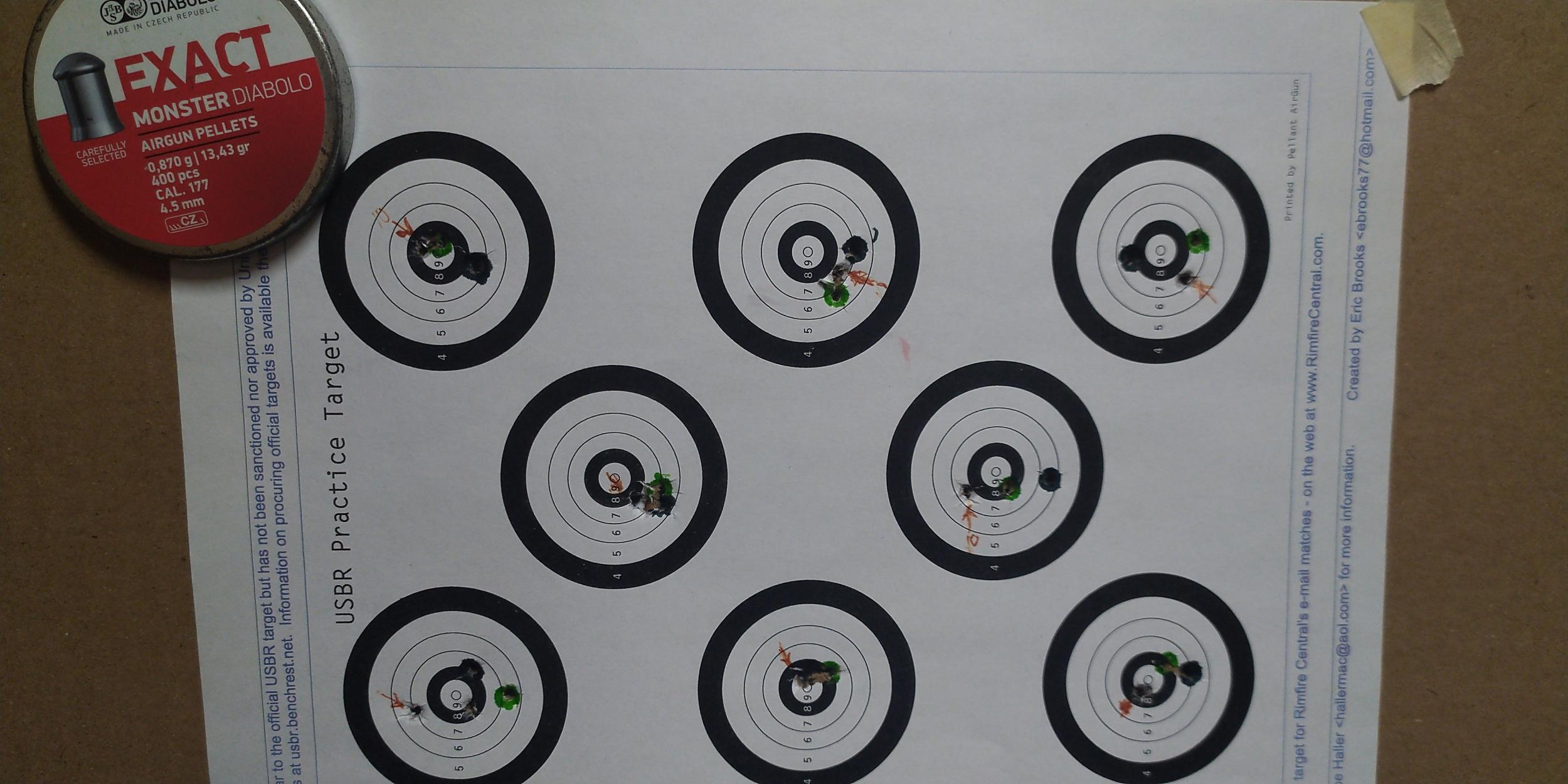

I did some lead testing on a target 8 pumps in the green marks, 7 pumps in the black marker, 10 pumps on the orange arrows. 13.43gr JSB, the 12gr Apollo slugs are a no go. I tried off target first
10m benched, I blame the Caldwell Matrix for the shift off target. If shooting with the lawyer spring in , best to pull up the 1st stage slack, then follow through, otherwise one feels a few bumps on the final release.
