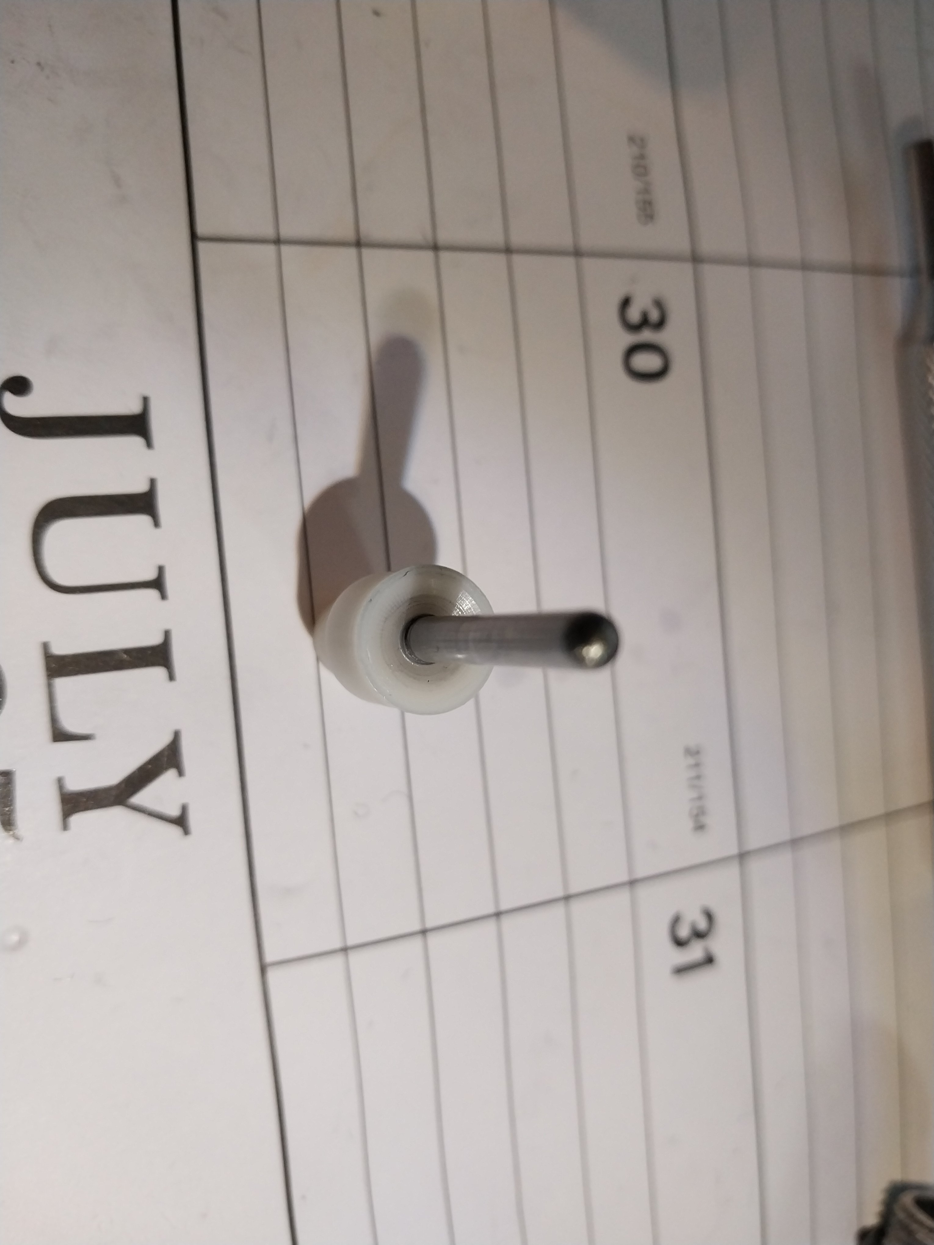

I have an old Daystate Mirage XLR I picked up from the classifieds not too long ago. Great shooting, lightweight rifle! Unfortunately, the valve started leaking the other day, and I haven't been able to sort it out.

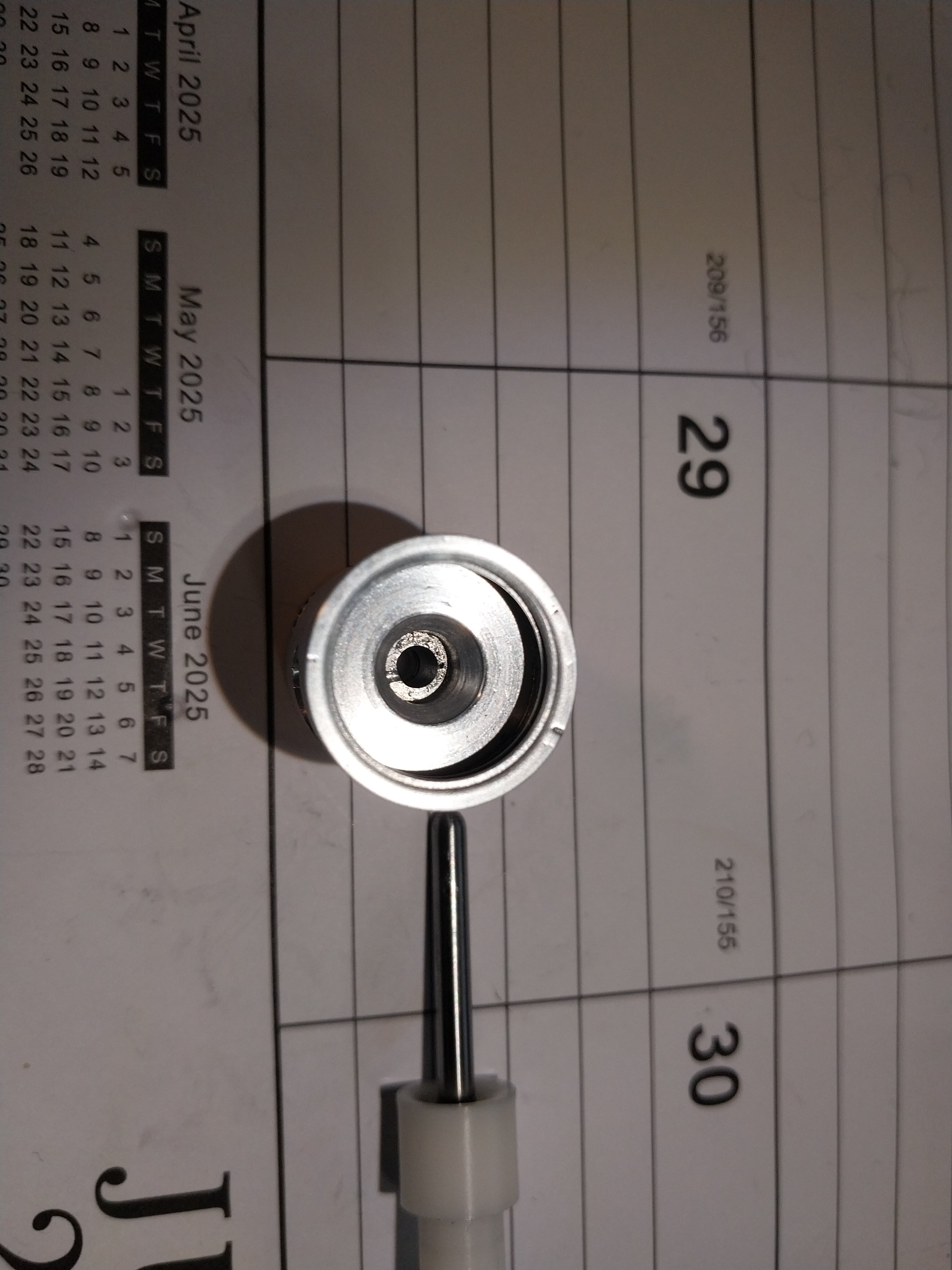

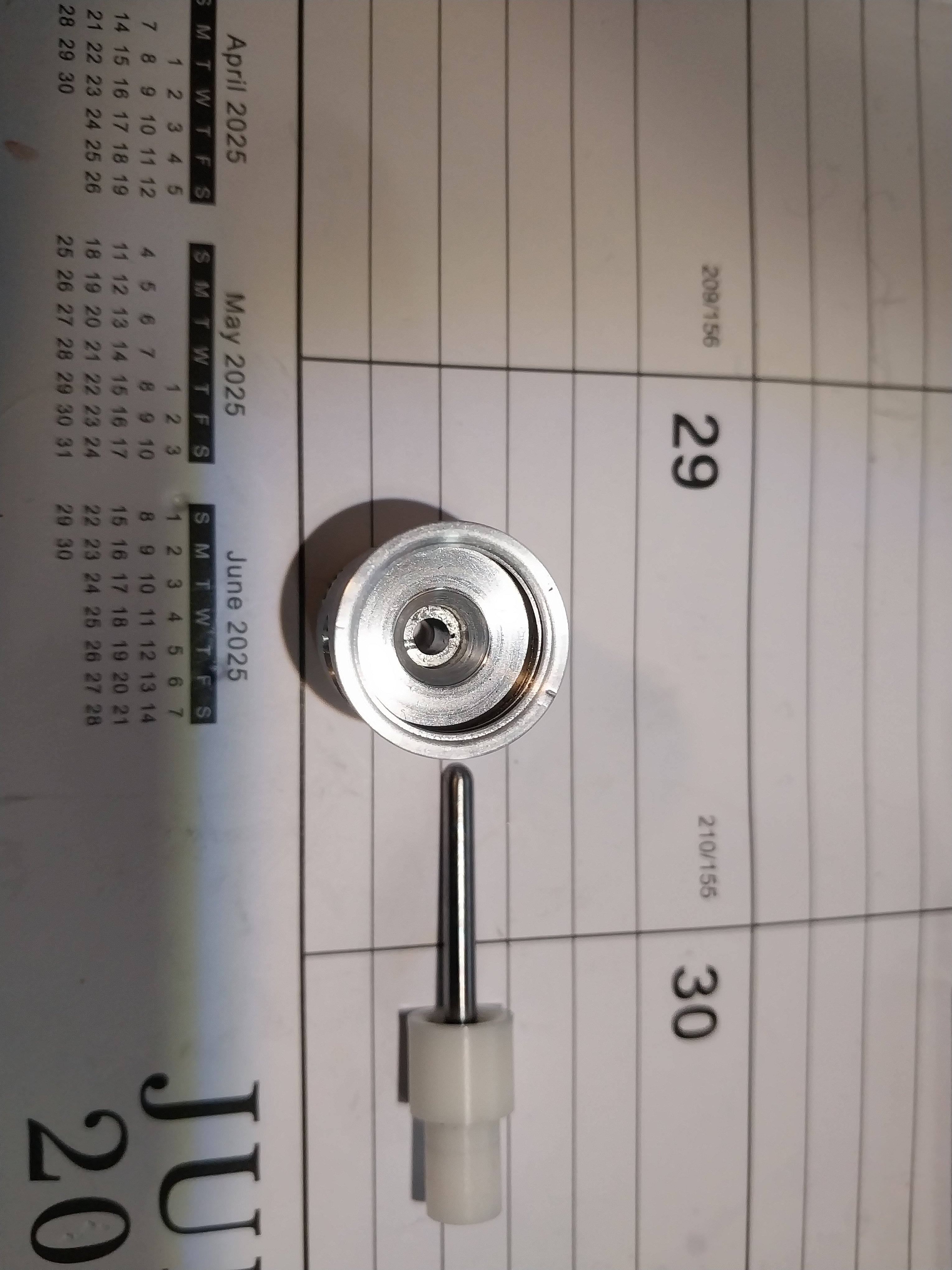

I narrowed it down to it leaking past the valve where it seats in the valve body. There are no obvious/visible defects or damage to either the valve stem or valve body/seat. All feels smooth to the touch and it seems to drop in just as it should, and there is good tension from the internal spring.
I have cleaned the surface of the valve seat and the valve stem a bit, and tried setting the valve stem in different positions, turning a little each time to see if there might be an obvious uneven/unlevel spot, but no luck.

Use a black Sharpie to color the contact faces of both the poppet and the valve. Apply a light abrasive* and spin them together for long enough to clear the ink from the surfaces. Wipe away the abrasive and inspect both with the aid of magnification. If there is a low spot such as a fine radial scratch, the ink will remain behind to signal what needs to be remedied.
Then based on the severity of the defect, you can consider how to proceed. For example, whether to stay with a light abrasive or step up to something more aggressive, whether to continue lapping both together or instead start by dressing the flawed part alone before doing a final lapping pass, etc.
