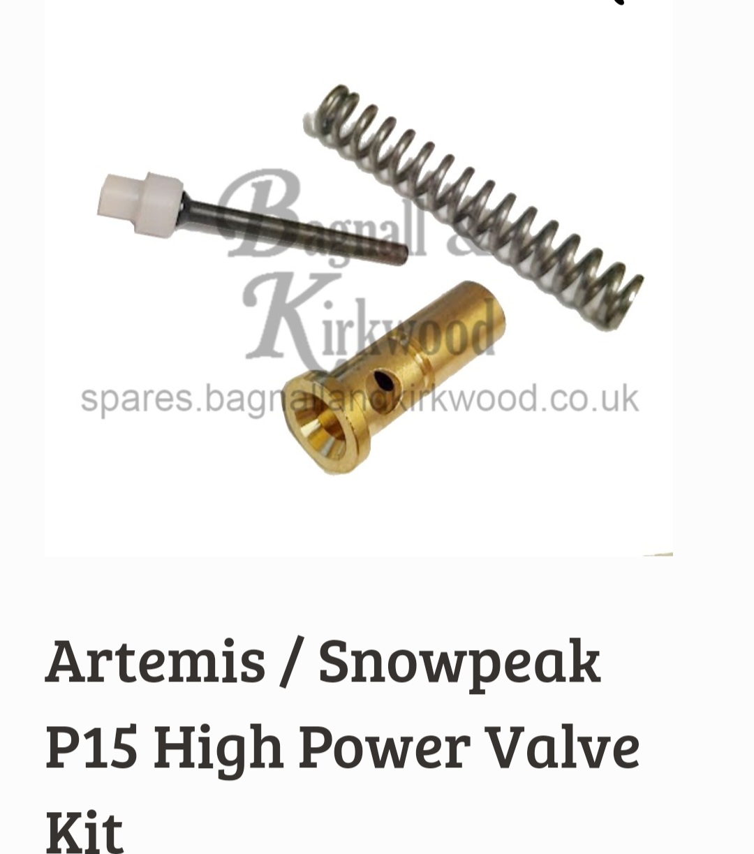

Hi anyone has tried this power kit for Artemis P15?
It says 5mm ported valve.
Pros and cons?
Pros and cons?
Mine shoot 850 fps so I don't need it right thanks for clarificationI could be wrong but I think that was designed for the UK sub 12 guns to get full power. If you already have a full power p15 it may do very little.
designed as for the non UK version as well as upgrade to FAC in uk.I could be wrong but I think that was designed for the UK sub 12 guns to get full power. If you already have a full power p15 it may do very little.
I ordered huma regulator with 12cc plenum hope i can do 850fpd on 21/23 slugsdesigned as for the non UK version as well as upgrade to FAC in uk.
i have this in my p35. Works perfect. Same exact power as prior to install. p15,35,35x use same valve housing, spring and stem/seal
i'm gonna be honest, I dont think so. at 143b i'm shooting a p35x with a 65cc plenum at 865 maxed out it can peak at 880-885 with 21 hp slugs if i bring it up to 150b. Maybe it will, you can only find out by trying.I ordered huma regulator with 12cc plenum hope i can do 850fpd on 21/23 slugs

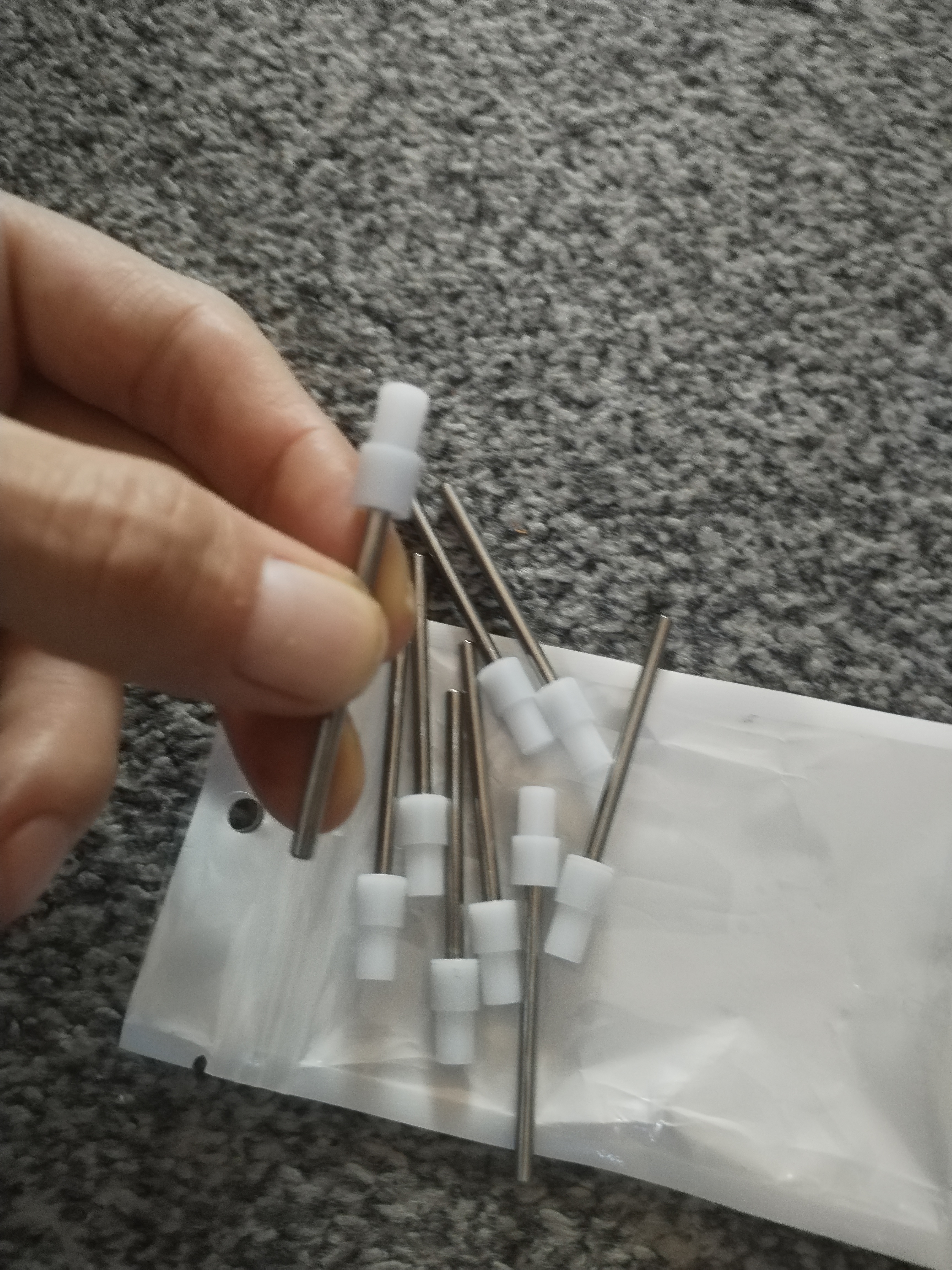

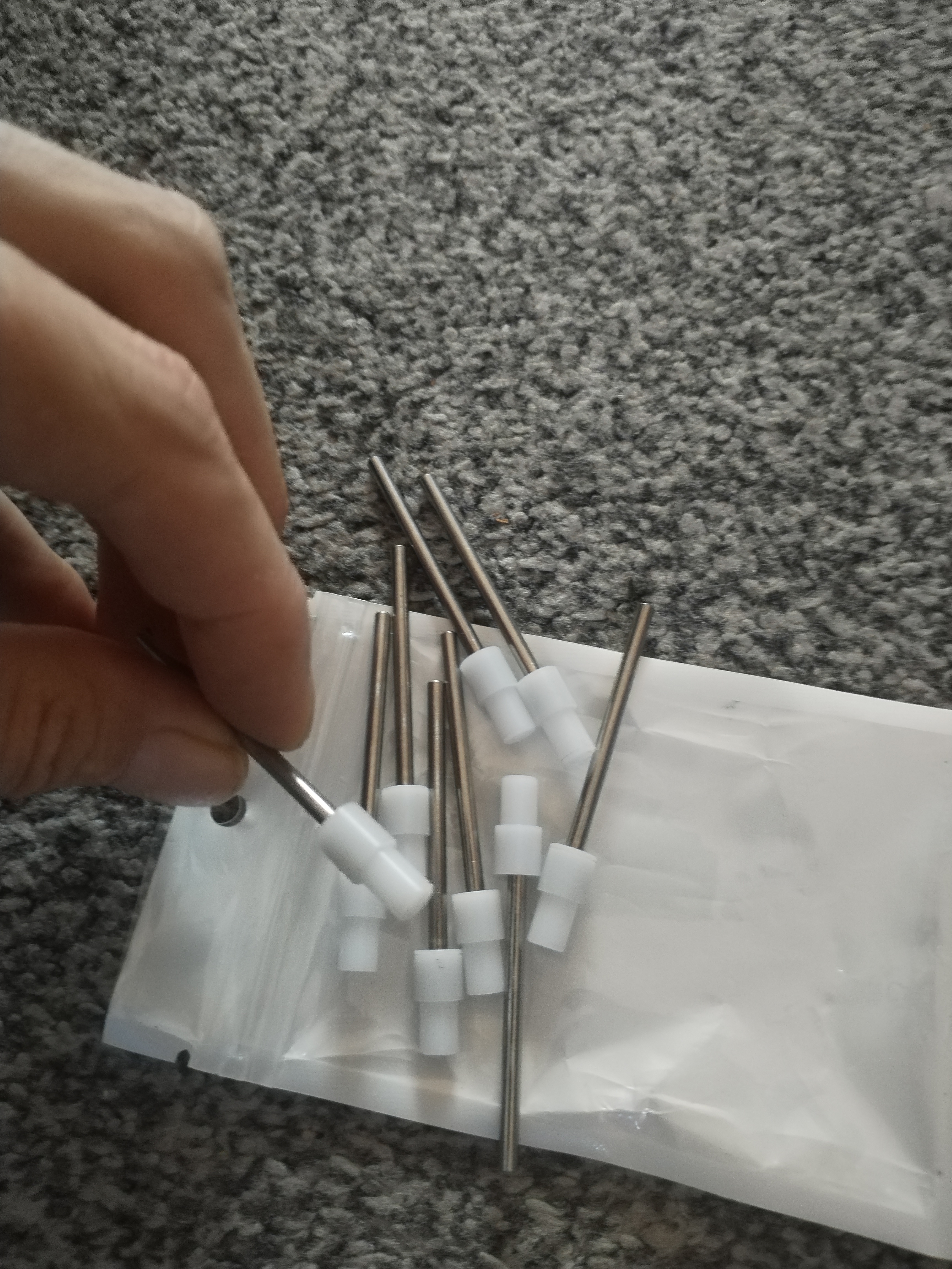

I have a spare valve housing if you need one. The same bagnall one in the thread. Order the PEEK or delrin valve stem/seal from maple.I missed ordering one Monday because I was away from home and thought I could wait until later in the day. I don't think it will increase power in my U. S. spec guns but the price is not much more than just buying another hammer spring and valve. I want those parts so I would like to give it a try.
