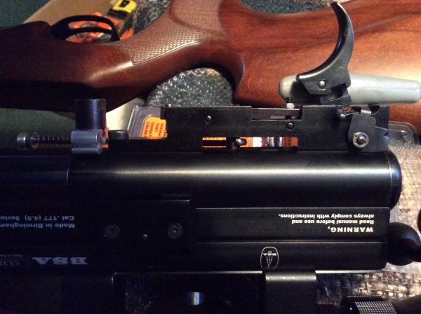

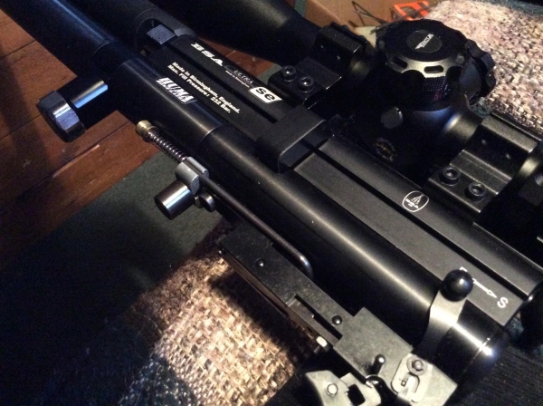

I made one for my BSA Ultra SE. It’s worth it. I used a spoke off a mini bike. My Ultra already had the aluminum block for the HDD or blast tamer. I used a spring from one of my micro r/c cars shocks. Once installed, I shot the gun through the chronograph and kept increasing the preload on the spring until my velocity went up. I backed it off a little and it’s been happily ever after ever since.

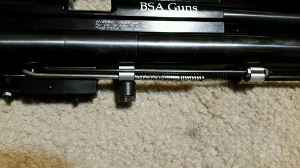

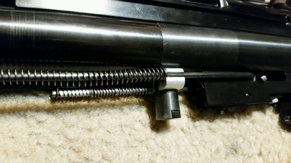

You fabricate it. Basically it's a rod with a spring and a hook (which fits around the cocking pin on the hammer). The hook is putting pressure on the cocking pin in a direction towards the valve. Now this might seems counter-productive for hammer bounce but it works. The hook is a tiny fraction of a second behind the hammer moving forward. When you have the correct spring pressure the hook will hit the hammer pin just after it (the hammer) strikes the valve. This stops the hammer from moving rearward and into the hammer spring which would be able to propel it again into the valve creating the "bounce", if the hook weren't holding it forward. On my Techstar one side of the MMC rod guides is a double. I used the unused slot to hold mine. I'll get a pic when I can. All you need are a short piece of rod, a small spring (I used 2 ball point pen springs) and a "c" clip the diameter of the rod.
Here is mine.
Vetmx- Think I got it -kinda works like a damper on a car shock- hammer spring hits -hammer travels back(rebound), lighter spring & rod absorb so it doesn't travel back into hammer spring & go hit pin again- Now got to tear my stock off, cause What your calling MMC rod guide , I believe my .22 & .25 each have 2 (rods from cocking end)So now what? its a clamp that holds the cocking lever(times 2 in my case) & in turn 1 bar to cocking pin. So now , I need to improvise? Need to look @ Lonestar setup- But same as your gun minus a blank spot @ MMC clamp. And what size rod do you use? for c-clip (need to cut groove to hold)?Thanks for the info

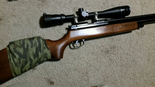

Here is my Techstar which (other then the stock) should be exactly like your lonestar
I drilled out the one side of the MMC bracket for the BT to ride in. Also the spoke idea is good as it is already threaded for a nut. I just took my rod, spun it in a drill press and cut a groove with a small dremel cutting disc. Figured this was easier then threading the rod.
