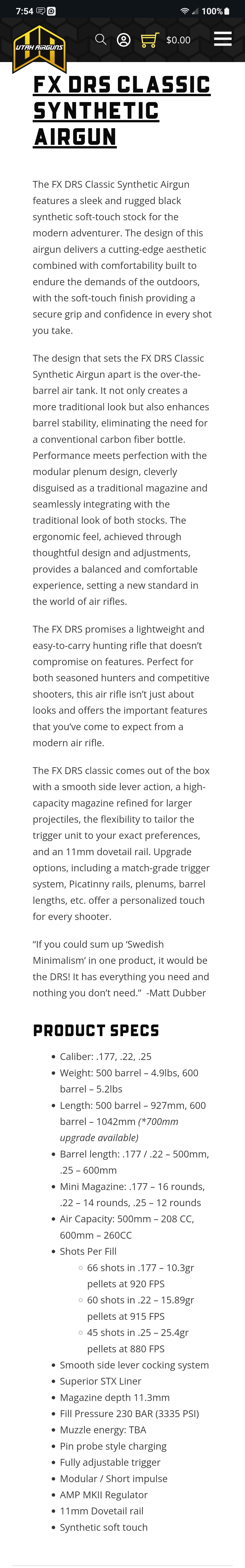

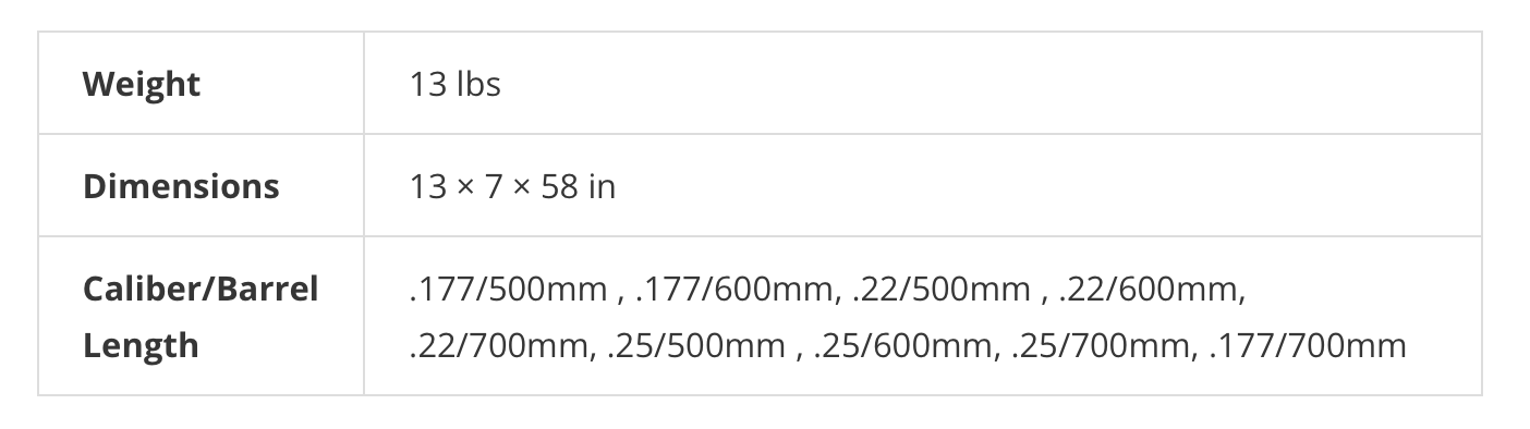

Their web shows .177, .22 and .25 available in 500mm, 600mm and 700mm barrel lengths.
Reactions: N2 Shooter

There seem to be conflicting INFO on the DRS Classic in that regard, just 500 mm or 500 and 600 mm
600 mm i could make do with, but then i would need a slug liner, and i assume in these a new barrel is not as cheap as the straw barrels are.
