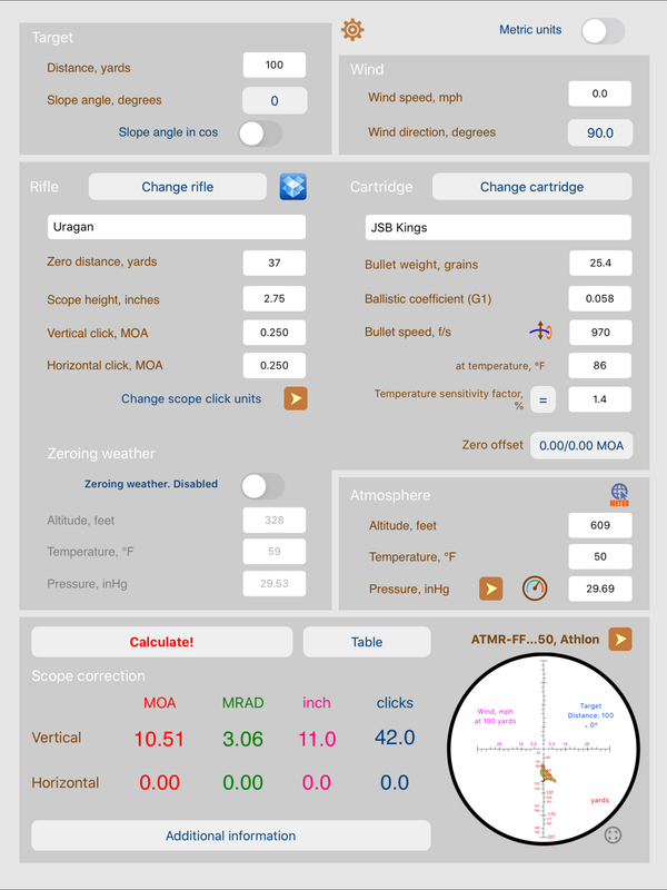

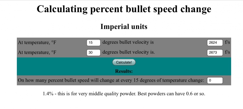

I’m setting up iStrelok for my new .25 Uragan / Athlon Argos 6-24x50 combo. After calculating my drop I clicked the ‘Additional Information’ link at the bottom and noticed a significant adjustment it made to my velocity. It said my adjusted velocity was 930 since my data for JSB Kings was using 86 degrees and iStrelok said my local weather today is 50 degrees. I am surprised to see such an adjustment for that temperature difference and it equated to 0.75” at 100 yards difference. Not huge but not insignificant when pesting birds.
What settings do you have for your pellet data temp? I assume it means the temp you had when you determined your velocity and BC. For me I go with a BC I look up in one of the standard references although I know it can vary a little between guns. There is also a Zeroing Settings area which I am not using right now and is turned off. I’m thinking I might need to better understand when and how to use these various temp settings for shooting over 75 yards.
