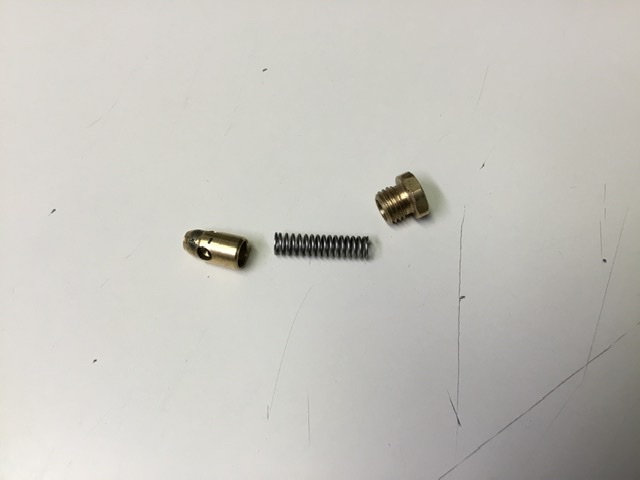

I have recently found that the slow fill tank valves such as ones sold by Joe B will not allow an external reg to cleanly reset each shot when tethering ….at least not on my 22 cal slug guns. Using the Air Tanks Plus Reg Man or the Huma external on a slow fill tank valves would require 2-3 shots before the reg would reset even if the plenum volume was reduced to the minimum.
I have scba tanks without fill restriction and one Joe B with restriction. I had days where everything worked great, and others where it was a struggle. Luckily I finally figured out the problem. Once I removed the restriction in the Joe B tank the regs worked like they were supposed to and day to day performance leveled out.
I wasn’t really looking at tanks as an item that could make or break performance…but it turns out that they can make a big difference in external reg operation.

Yes, true enough. The trouble I had is that even if I made the plenum so small that power began plummeting at the same pressure….the slow fill tank would not reset the reg properly every shot. With the slow fill removed….that is not a problem.

I've been seriously thinking about picking up one of Joe B's or the Reg Man inline/external regs for tethering. I currently have 3 of Joe B's tanks (2 Great Whites, 1 Guppy) all with the TJ3 Slow Fill Valves. I currently use the 2 Great Whites in a cascade fill system. I don't know if I want to dump all the air out of one of my tanks to remove the flow restrictor and repeat the process of installing it back on and airing it back up for regular use. I might have to get a dedicated tank just for tethering if that's the case.

What air tank are you using and if it has a flow restrictor, have you removed it?
I use my guns for competition and ask a lot from them. If not competing, you might be perfectly happy leaving the flow restriction in the valve.
Also…removing the flow restriction does not make a tank unsuitable for normal filling use. There would be no reason to remove and replace. Open a full flow valve slowly and it works just like a slow fill. I’ve never heard of anyone harming a gun because they filled without a slow fill valve. I suspect the guy that sells slow fill valves might tell you otherwise, though. It’s more of a sales gimmick than it is a necessary item. You should be opening the fill valve slowly no matter what valve you have.

Interesting timing as I have two Joe B valves with flow restrictors removed and was considering adding them back. I pulled the restrictors to allow use of a 120psi scuba regulator set up to air up tires after off-roading. But I haven't really used the tanks for that, and I find the unrestricted valves a bit touchy for airgun filling especially when tanks are at a full 4500psi.
Thing is, I have never used the flow restrictors since they were removed before first fill. Is there a significant difference filling with them? My first tank was a 3500psi scuba tank, so I'm used to feathering a valve, but I don't know if its the 1000psi extra pressure or the valves themselves on the carbon tanks that make them seem more sensitive.
Are there any good external flow restrictor options? That seems like it may be the best all around option. You'd have to rely on the gun gauge when filling, but it seems like a trade-off I'd be willing to make in order to have maximum flexibility from a tank. If there's nothing commercially available maybe you could drill the check valve in a male foster with the smallest drill bit you could get your hands on or something like that.
