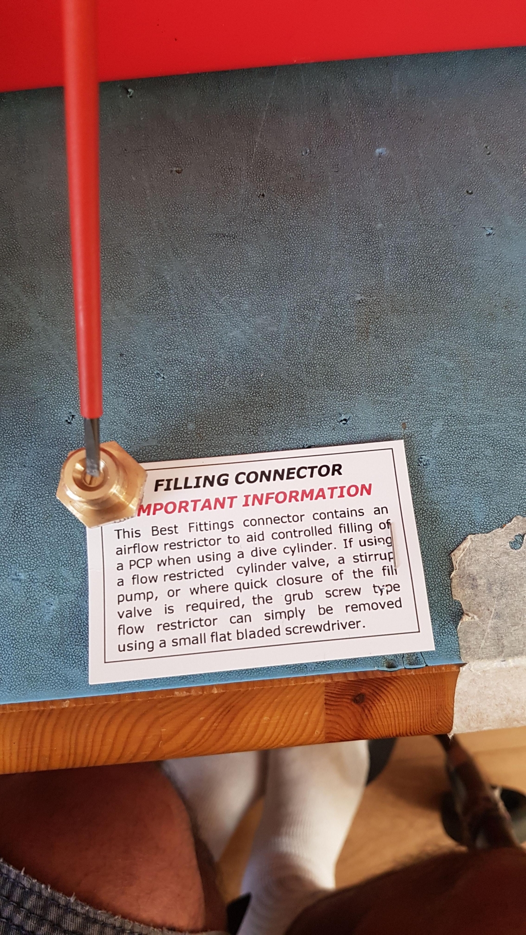

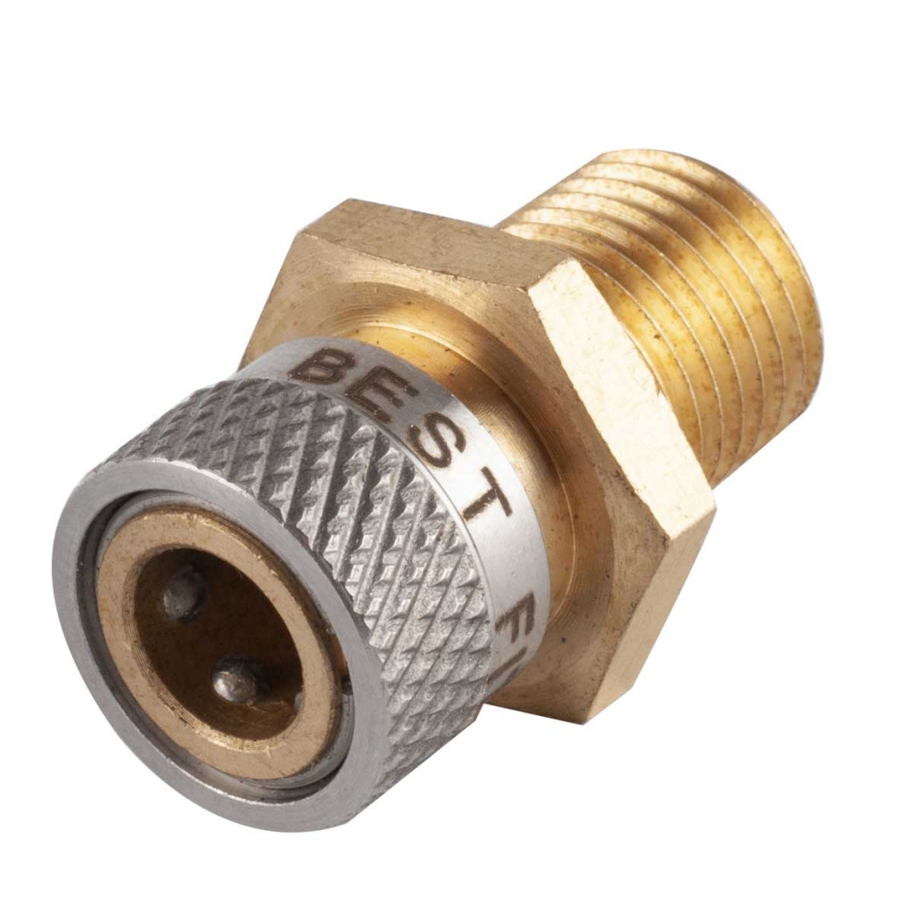

Just wondering if anybody who uses yong heng compressors and uses quick detatch female foster fittings , do you remove the flow restriction grub screw or keep it in ?
No because the pressure coming out from the compressor goes up very slowly so there is no need for any means to restrict the air flow.
The answer to the question is yes, remove the restrictor. You don't want or need to restrict the flow from the compressor. It is there for filling from bottles to prevent accidental over filling or excessive heat build up from filling to fast. I think that the above answer may be confusing because of misinterpretation of the question.
