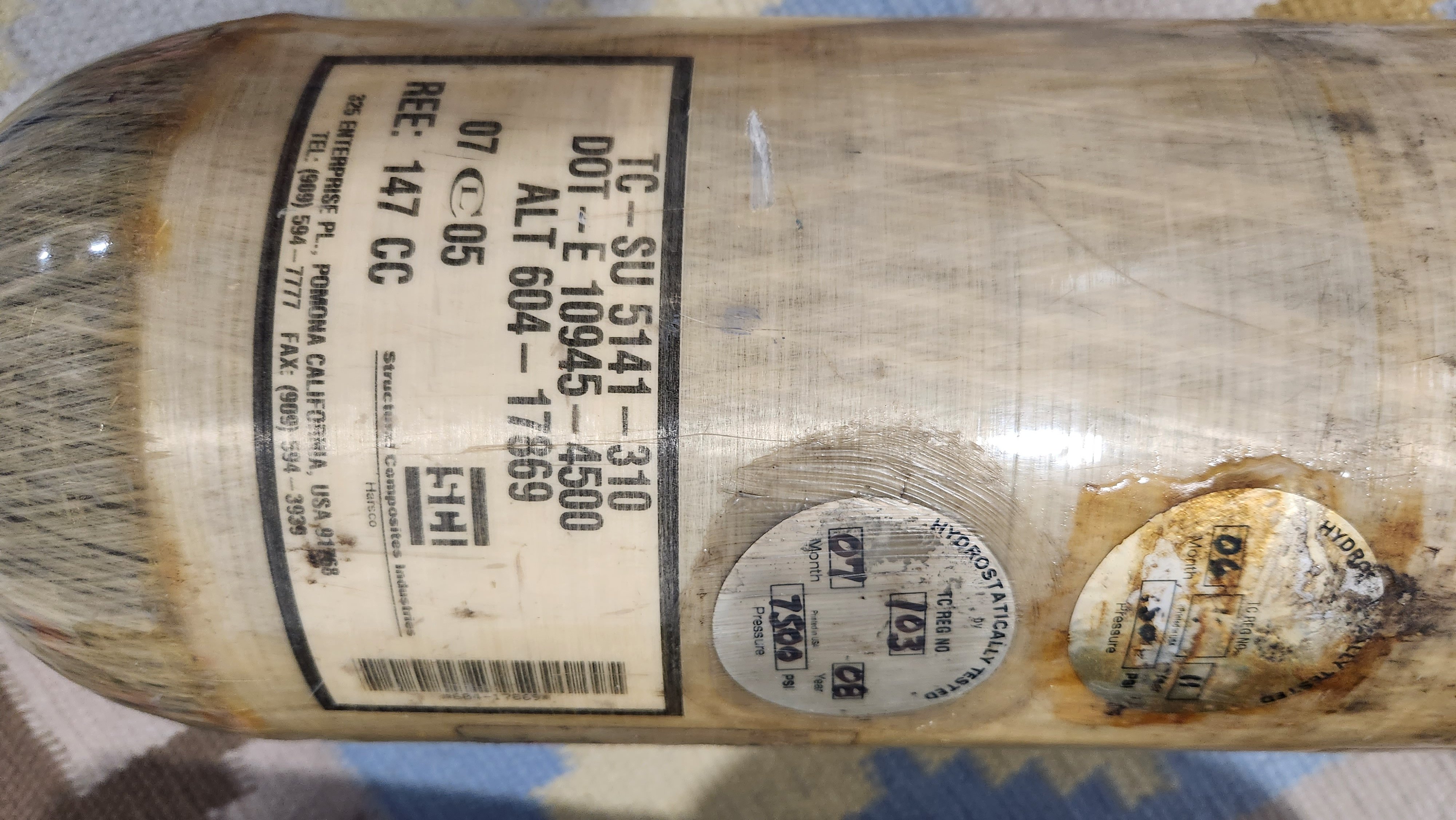

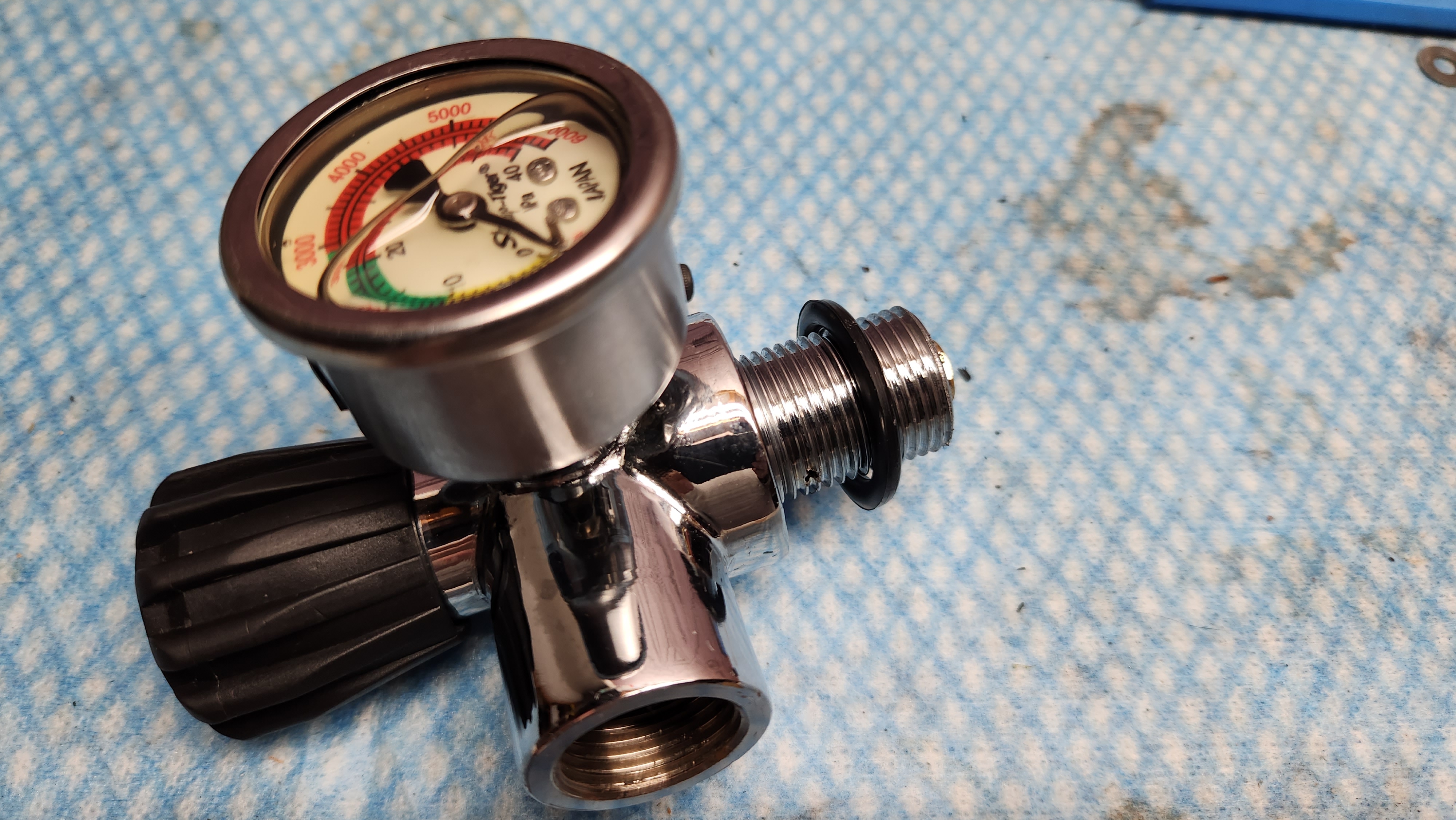

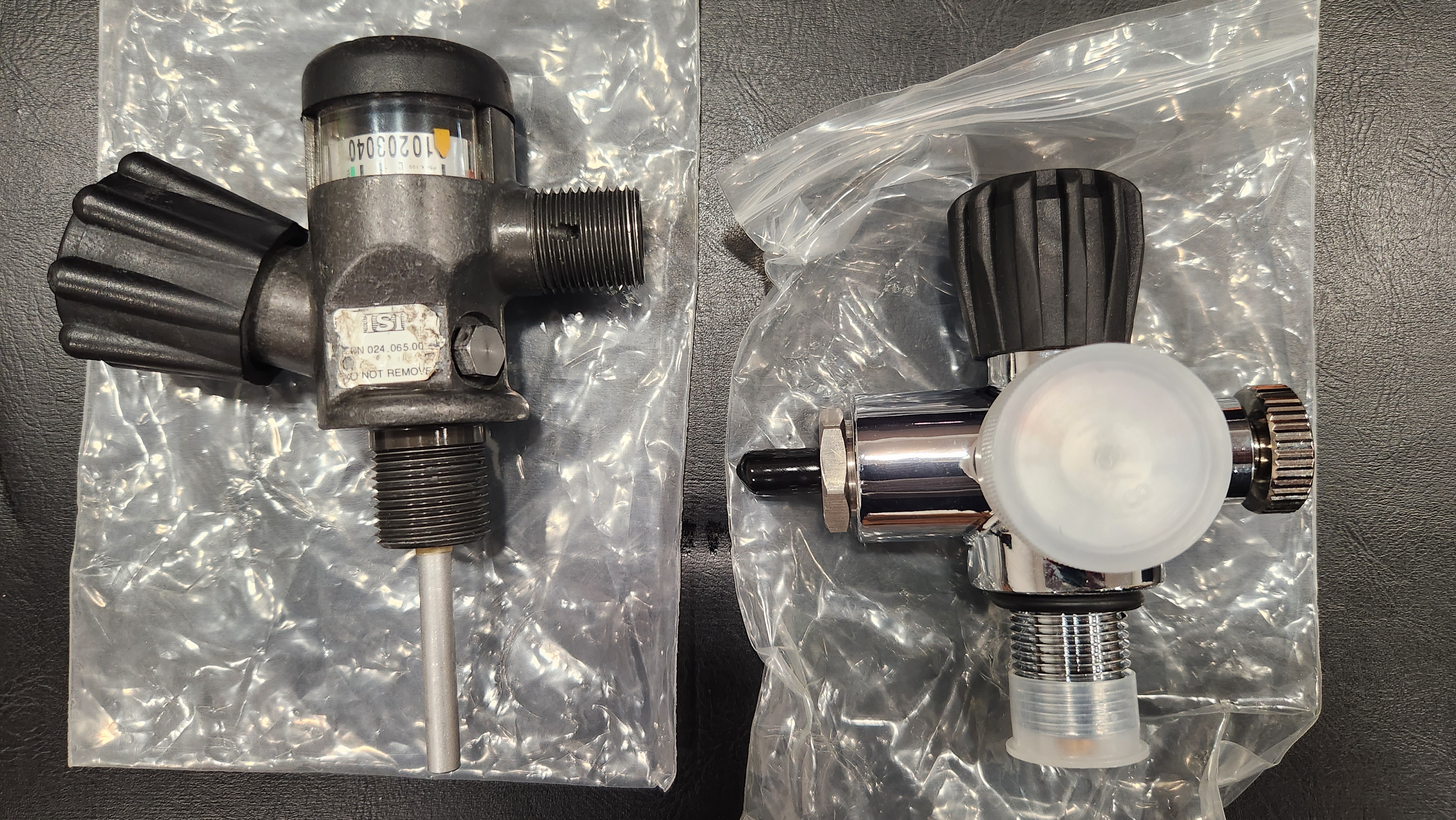

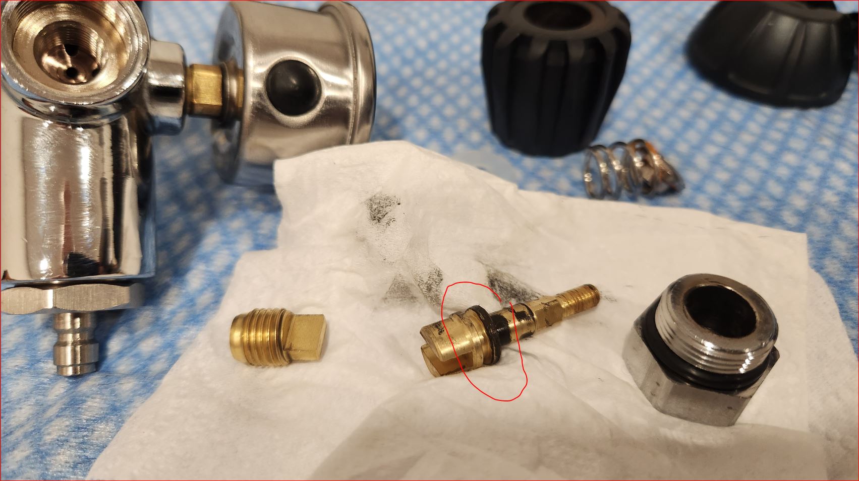

I bought four scba from a fire station auction sale back couple years ago. All these tanks came pressurized, out of refill warranty, in shape pretty much this one pictured. Never bothered sending them for test.
During years one by one I replaced the valves to DIN, diy. Also replaced the valve gauge to more friendly look.
All parts from aliexpress
Working for me
