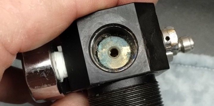

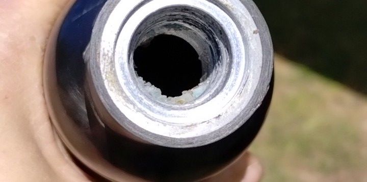

This folks is why you use dry air to fill your gun. Thank you Brian at Veradium Air for being my airgun doctor. I personally filter my compressor. This is a newly purchased used rifle.
This is exactly why I don't/won't buy a used PCP from just anyone... Using a cheap compressor is fine...those cheap filters you read about everyone say...is fine.... definitely is not! Your holding the proof in your hand.
Hopefully you get it cleaned up and there's no pitting in the important parts..

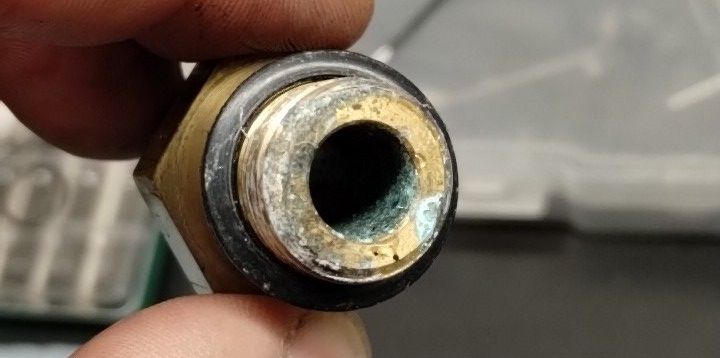

Wow, yeah no truer words spoken, a buddy of mine has a Benjamin marauder that inside the air cylinder looked like a water line out of a 100 year old building, had to spend a good bit to get it back right, and looked beautifully and well kept on the outside, he uses good filters nowadays.

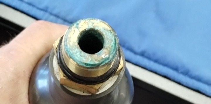

Yeah, almost ruined my first PCP, Umarex Gauntlet, with handpump. Internals looked similar, not the caked-on deposits, but the green, slimy stuff. WM

This is a frequent topic, some members will comment no problem with moisture filling PCPs, others will post pictures like the OP. After my experience, I went Yong Heng with a string of four filters! Each has to decide for themselves, I guess, I've too much invested in my PCPs to feed them anything but dry, clean air. WM

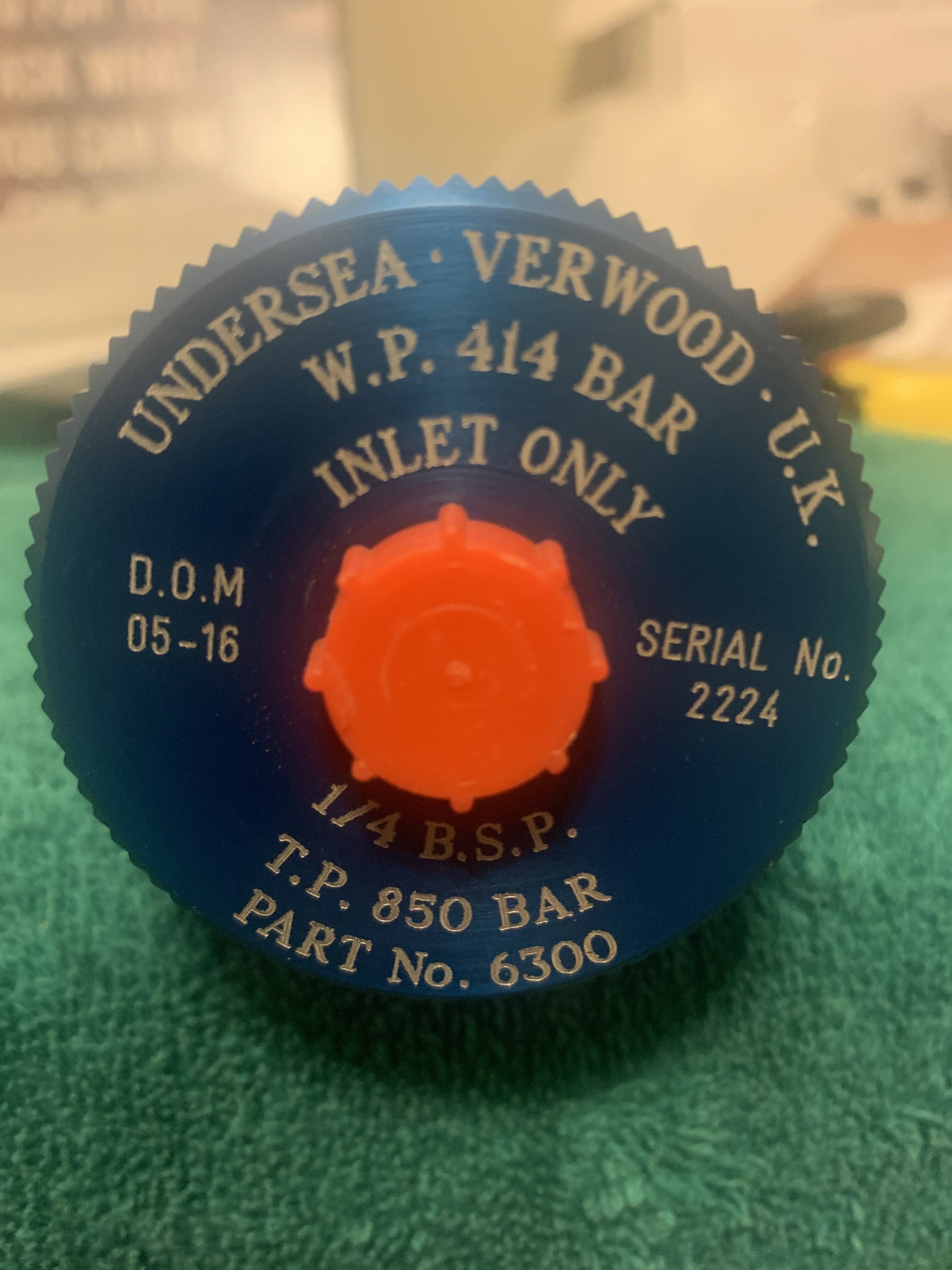

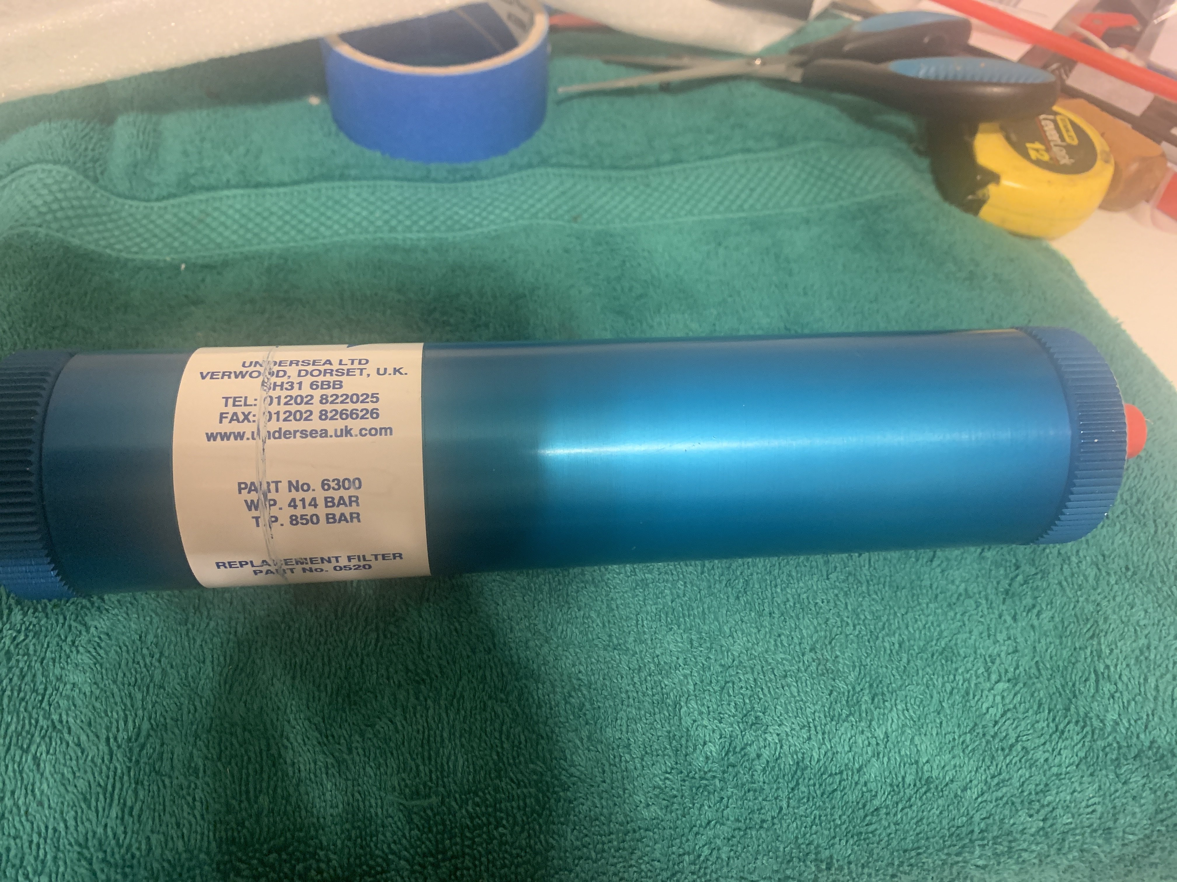

I’ve read of issues with the Chinese ones on eBay and Amazon. I don’t now if this is widespread or not. The high pressure filter I use was made in England and has a working pressure of 414 bar. I bought it from a guy on the Talon forum probably 7 years ago so I’m sorry but I can’t remember his name. Back then they were $250.
