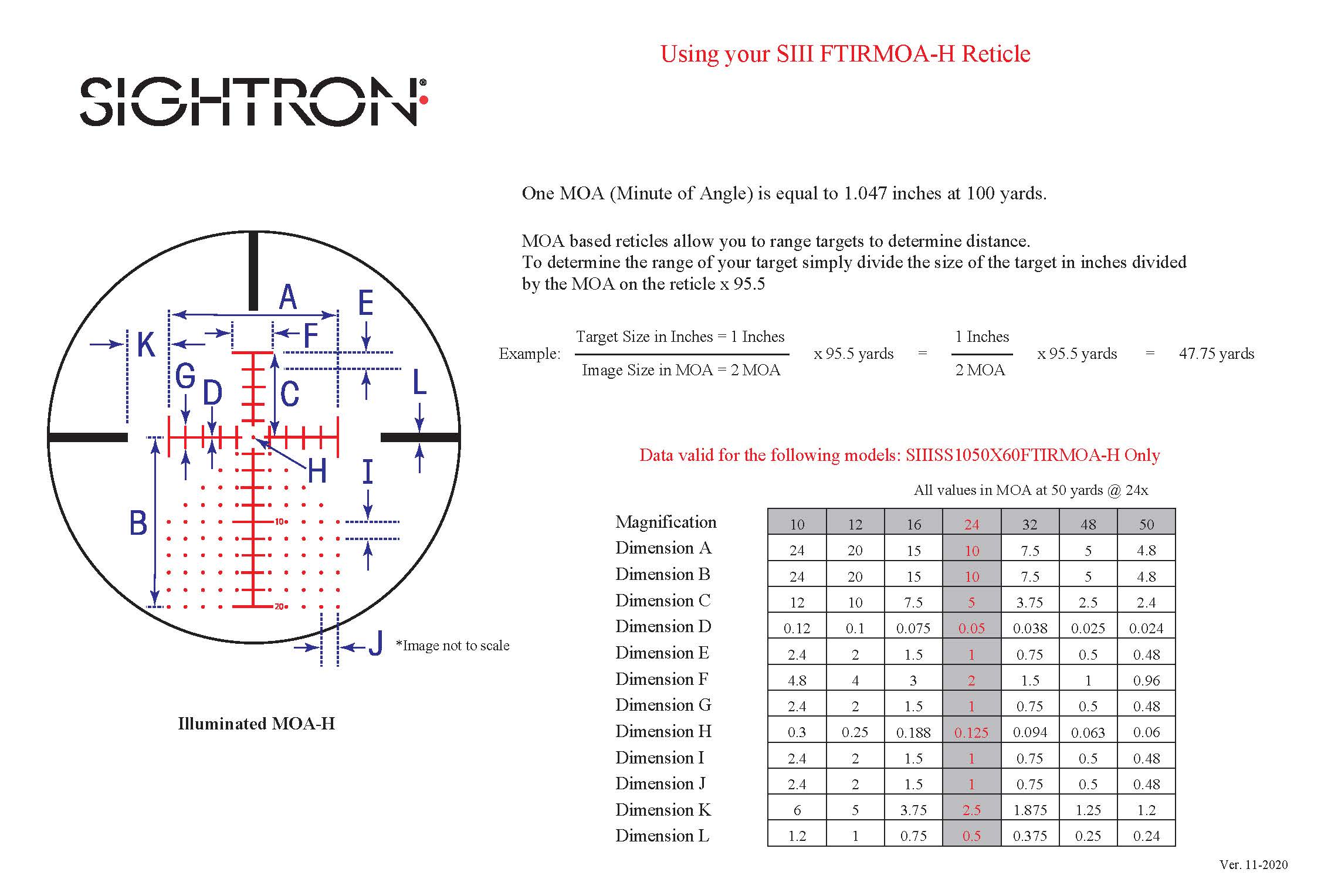

I'm wondering if anyone is getting usable results from any Ballistics program to set up a FT scope wheel?
I've been using these programs on and off for years now. The only one I got usable results from was the old
Hawke Chair Gun Pro for Hawke scopes.
I'm now shooting a Sightron SIII scope. I've tried a couple of the Hawke programs as well as Strelok with poor results.
Chairgun Elite seems to be the only program that lists a reticle for the SIII. I have played with that program for many hours.
But can't get results close to my real holdovers. I have a very accurate scope height measurement as well as several measured BC inputs
at different speed/ranges. My SIII has the SIII FTIRMOA_H reticle. For example my real world holdover for 10 yards is about 4 MOA.
Chairgun Elite says its 7.1 MOA. I have to be doing something wrong but for the life of me can't figure it out.
Any help would be greatly appreciated.

Using the SIII not sure if you realize but at 16X each MOA on the reticle is actually 3 MOA measurement and it takes 3 MOA on the turret to get to the first mark. I use Chairgun Elite and have used Strelok pro. Both have the SIII reticle. I have found that the BC in the program have worked well for me, but have also generated a BC. One thing I have learned to do is once I get the info in the calculator I pick a couple of longer targets and a couple of shorter targets and then use the clicks from the calculator to verify the info in the calculator. Then I will use the Reticle view to make sure as well. In Hunter class I love the reticle view as it gives me a visual reference when I am addressing the target. By setting up the view with the 3 rings largest being 1.5" and smallest .5" that also give me reference as to the actual kill zone on the reticle.
