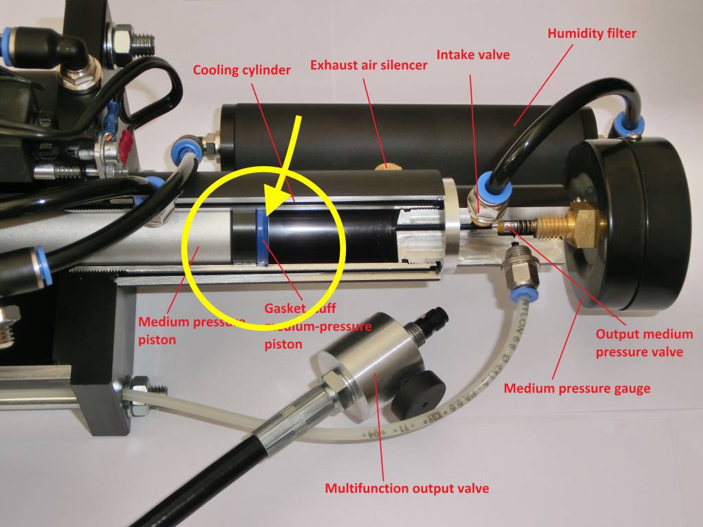

I do like my Altaros Booster, but this is the 2nd time I've gone through the medium pressure gasket cuff. Luckily I had bought a rebuild kit from Altaros, but I only needed this one gasket for the repair. Now that one is all chewed up. I don't want to buy a whole rebuild kit for one little gasket so hoping someone has a source for these.

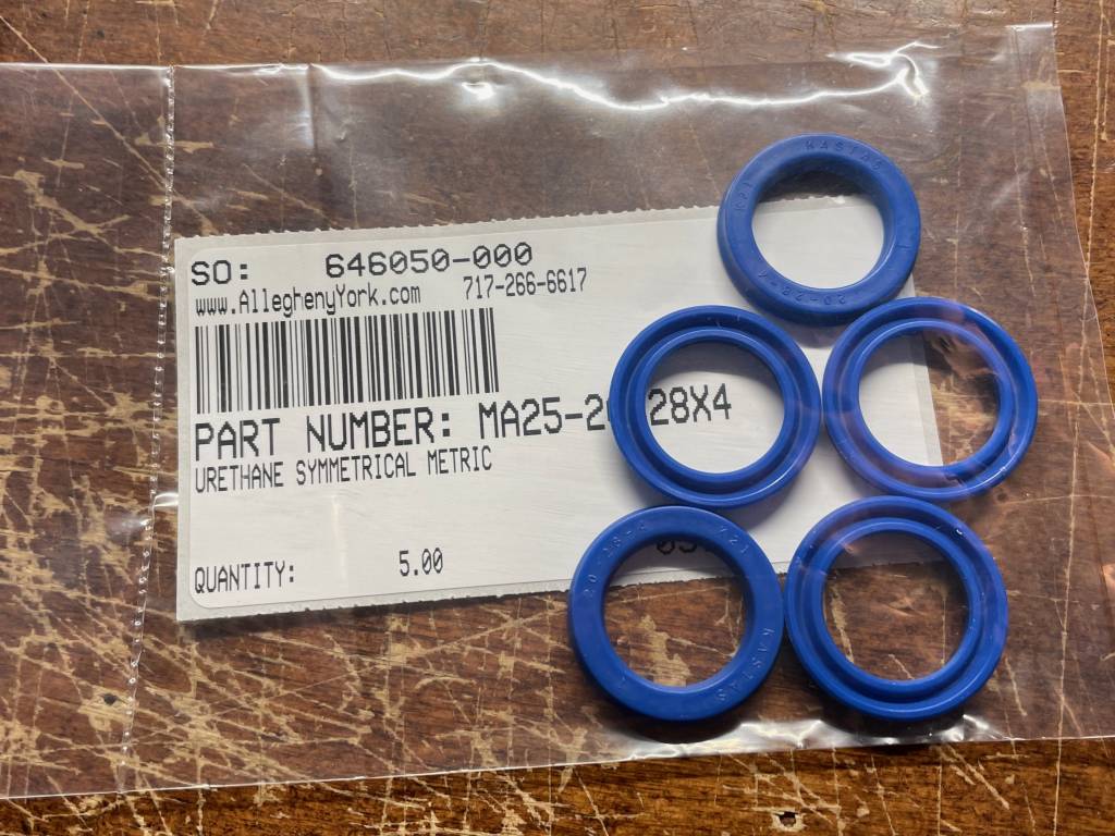

I'm pretty sure it's what the o-ring store is calling a hydraulic U-cup piston/rod seal.
I'm sure the size is close to 22x30x5, but there's a lot of other options close to the size that I can't go with my gut on the order.
