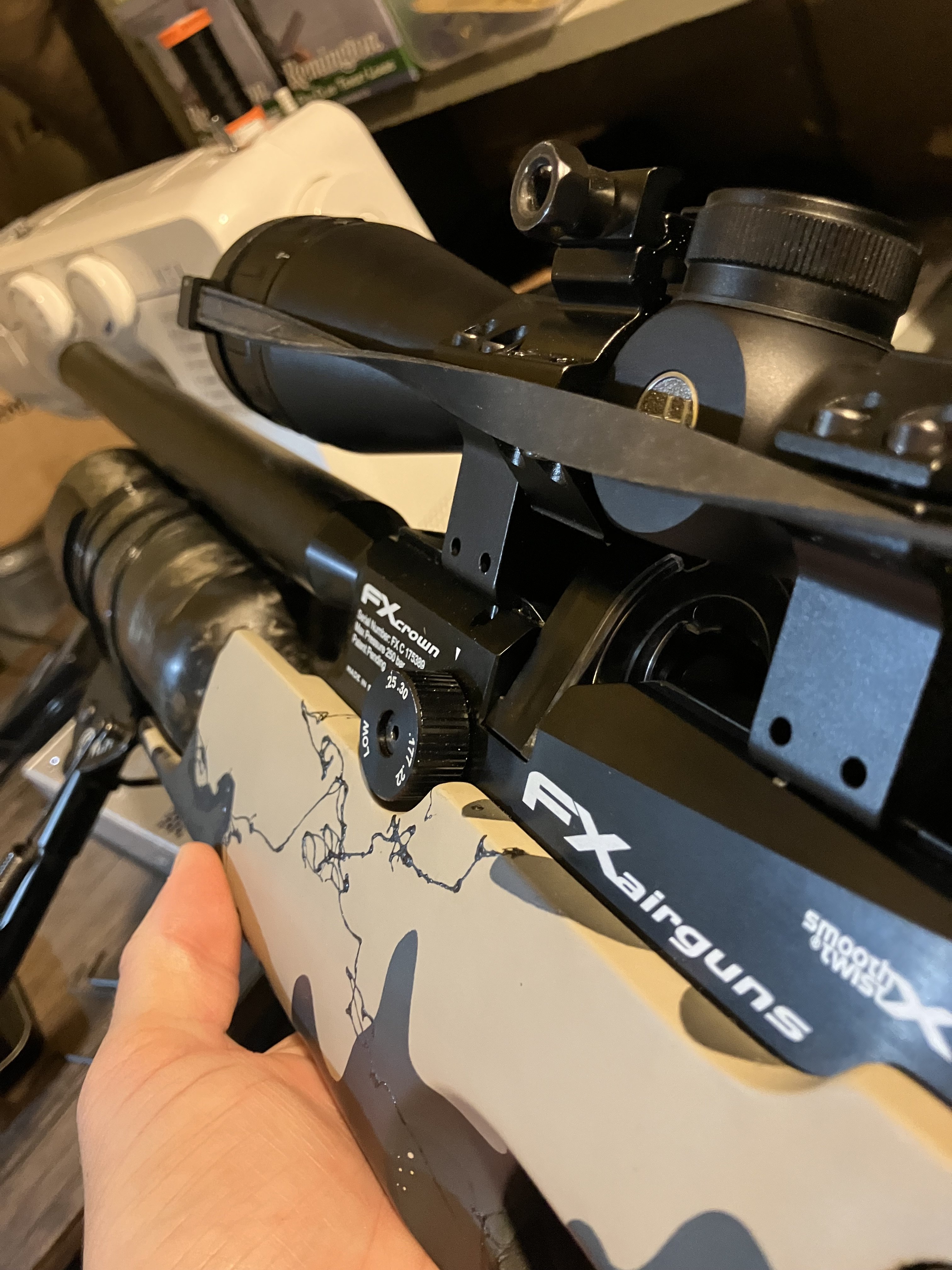

Here is a pic of the mag seated: from what I can tell it’s as seated as its always been. I even removed the cover and slid in the mag to watch the probe and it still hits high left.
I checked barrel screws and everything is solid.
Fixed: So I’m an idiot, a big one. The other day I mounted an additional mount to my scope to accommodate my night vision. This was preventing the mag from seating all the way by just a 1/16”. Really dumb mistake but lesson learned. Sorry for a wasted post but I learned a lot lol! Thanks to all who responded!

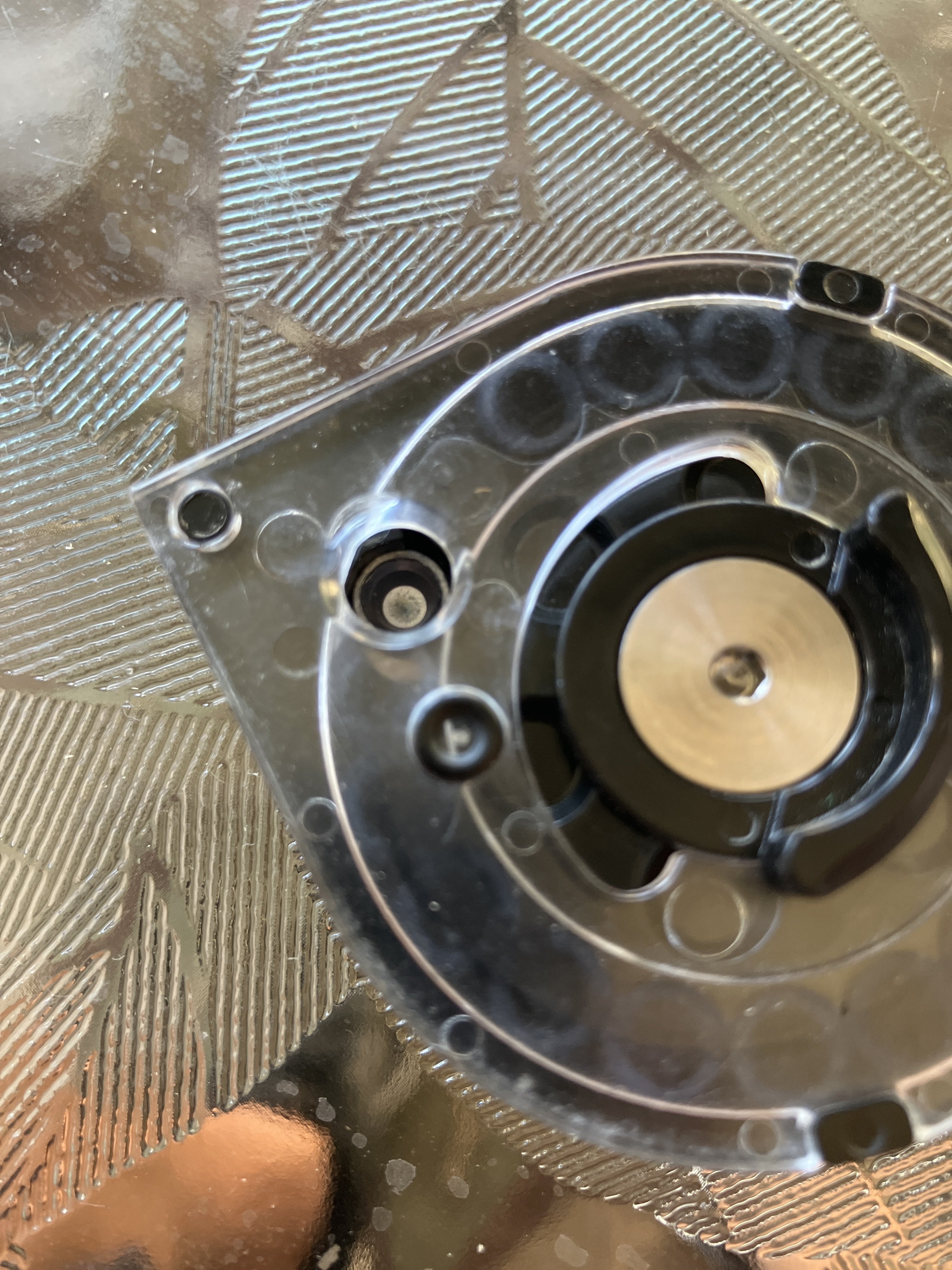

FX Crown. 18 round mag feed issue.
All of a sudden I went to load a mag into my gun and tried to push probe forward it wouldn’t go. Checked all the obvious stuff and can’t find an issue.
Single loaded a pellet no problem, the issue is definitely with the mags (I have 2) and neither will work. Took one apart and lost the ball bearings but even with the other one I cannot get a pellet or slug to feed from the mag.
Update: I noticed the probe is hitting the one part of the mag (upper left) of where it feeds the pellet. Took the probe off and it’s perfect. Tried to push the probe manually into the mag while in the gun and it still hits. Tried rotating it and everything it just will not feed and hits upper left.
I’m leaving tomorrow morning for a big pesting job, please help !!

When mounting a scope it is convenient to check that the magazine comes in in place and out, freely.
Later on if you can see the whole circle through the scope.
Then to confirm that vertical axle of reticle is perfectly plumb, to avoid canting.
Fortunately your problem was the easiest to solve !!!!

Yeah, I prefer to have my scopes as low as possible. Unfortunately a lot of airgun rotary magazines require higher than I prefer, and the scope ring availability can make it even higher. The adjustable height scope rings like FX makes, and others, can allow the lowest mounting possible with the rifle you’re configuring.

Another aspect to take into consideration is that if some weeks ago you were able to shoot without any problem and later on the magazine was touching the scope, than means that the rings were loose and the scope was able to move rear and forward.
Loose rings affect accuracy !!!
Well even worse, I mounted a ring (upside down) to hold my camera screen for night vision. I thought it was clearing the mag and just overlooked checking it.
I did something similar on my RAW. I mounted a new scope and didn't notice that the bottom of the scope (the part under the turrets) slightly interfered with the mag. Then, even more stupidly, I inserted the mag against more than normal resistance. Then, even more stupidly again, I pushed the lever forward against abnormal resistance. The result, I bent the probe. So, I called Martin and admitted my stupid mistakes, and he sent a new probe.
The lessen learned? Never underestimate your maximum stupidity. It can rise to unprecedented heights!
