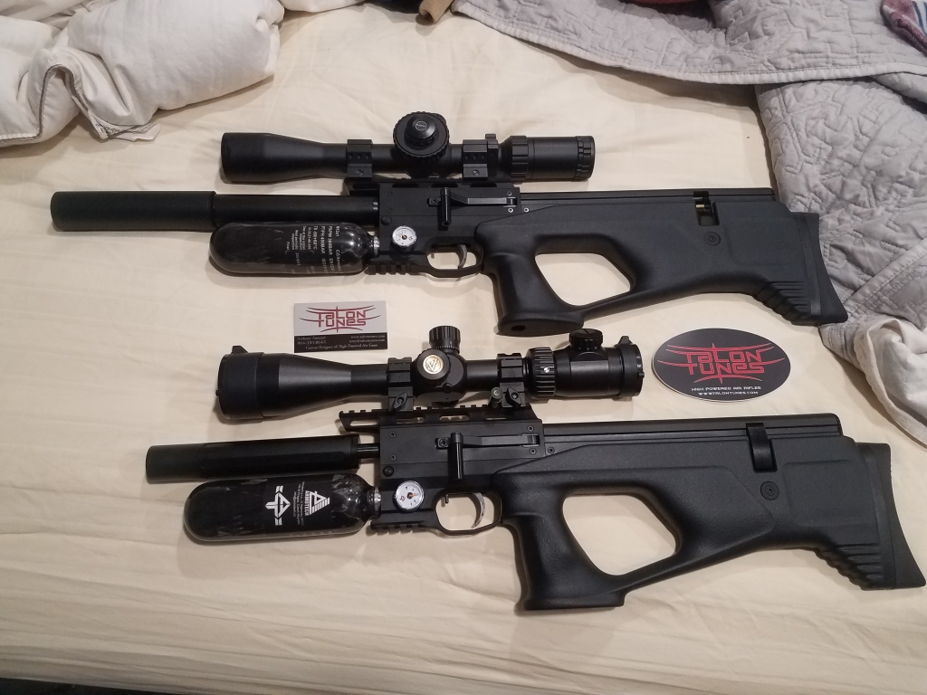

Mines the compact so not so bad to degas and I have a compressor. I’ll try and get some numbers tomorrow. I shot a few today and maxed out at 895 with hades 15.89 adjusting the hst before it started to drop. Reg is set at 135 but not sure if you can trust the marks on the reg as it’s just a sticker. I shot until FPS dropped and it got down to 110bar. Not sure if the gauge is off or reg is off. Might try and install a wiki gauge if it will fit. Bigger diameter so not sure. More tomorrow
the bottom compact has huma regulator installed and I see way better shot count out of bottom rig and less fps spread in over all shot string
