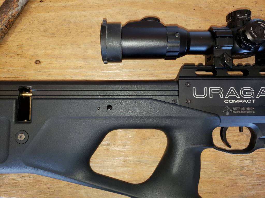

I'll try to get out this weekend with it and my chrony. My only issue is having to take it to a range and not having enough air to shoot more than a couple fills to do lots of tuning. Hopefully the wind will calm down tomorrow morning or the next and I'll get out. If you are pushing 940 with the 25g then I would think I could get the 18g up to that with the compact, but we will see. I hate having to remove the stock to adjust the HS. Maybe I can add a hole in the stock for access to the grub screw and notch out one side, and add a gear style head to the HS screw to allow for adjustment without disassembly.

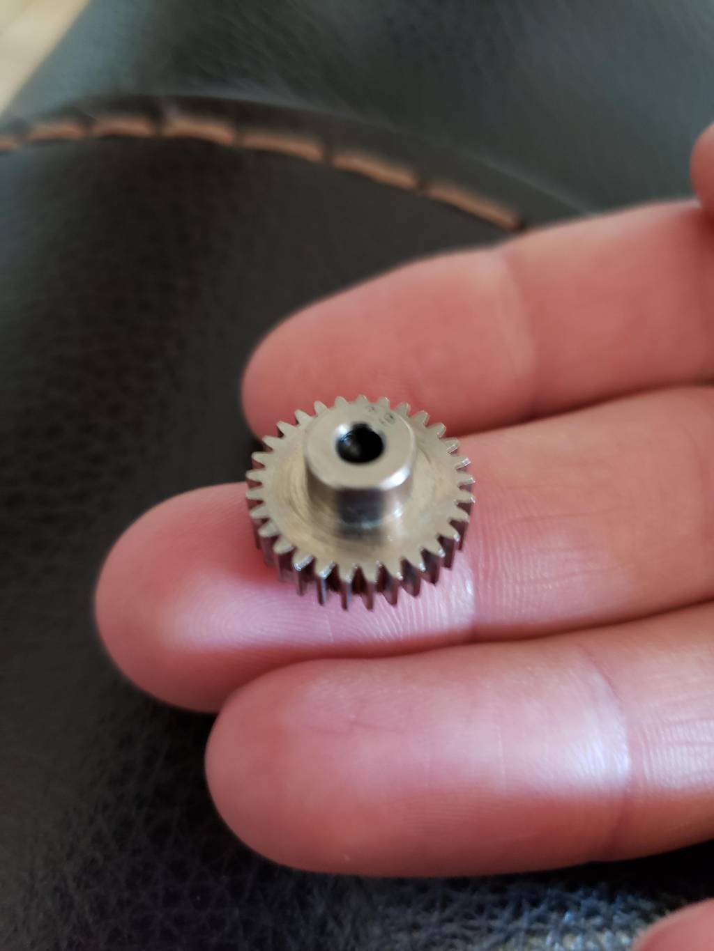

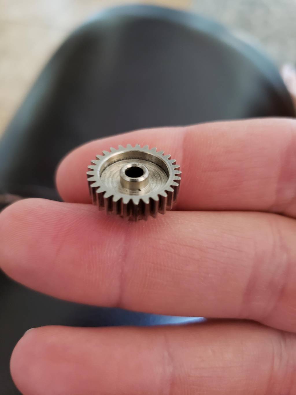

As I mentioned in my previous post, I didn't like that the HS can only be adjusted by removing the stock. Well, I fixed that issue and I think it came out looking clean and working nicely. I used a gear from a Traxxas RC car to create teeth to to adjust the HS screw. I had to turn the gear shaft on a lathe to get it down small enough to fit inside the HS adjuster. Now I can loosen the grub screw through the small left hole, and the use a small flathead screwdriver to adjust the HS using the larger of the 2 holes. I am looking for small little plastic or rubber plugs that I can pop in to keep dirt out.
