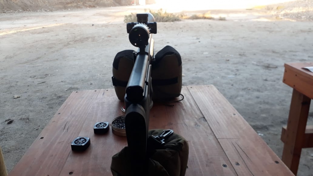

Yesterday at the range, was able to go up to 950fps, test begin from 890 and my first br target was 245, very happy, then go to 75m, but was too windy and big spread in the target, then go to 920fps, much better, but the wind was a factor that not allow to get the picture, next week go to 50m range that's with very little wind and will test more, also have to work in the trigger, very harsh.

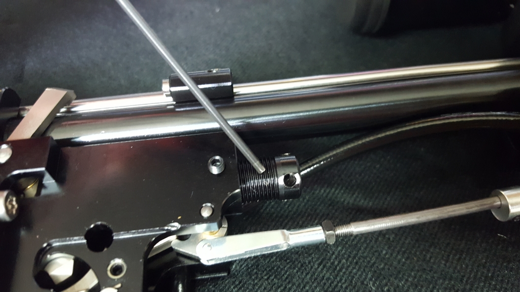

here is the power adjustment knob, you need to remove the stock, loosen the grub screw to the left of the adjustment screw first, then adjust your power to your liking; clockwise increases power, counter clockwise for lower power; once done, tighten up that grub screw.
Thanks for the pic and info. I just picked up a used 22 compact and I want to do some tuning. It has the HUMA reg installed already, so I need to find the happy balance for 15.9 diablos and Hades pellets. This helps because it did not come with the manual, although that doesn't seem to sound super helpful either.

What are hoping accomplish? More power, less power, lighter trigger release....
You can get a good amount of power (FPS, up or down) adjustment from just the hammer spring (the picture in your post). The sear engagement adjustment and reg access is detailed in this post too. Note that my reg 'cover' (where the high pressure hose attaches) is different on one of mine.
I'm looking to tune for power with accuracy. The Huma reg is set to 110 bar. I feel like it has a lot of hammer spring twang right now. With the moderator on it, all I hear is the hammer. It is a compact, so I think if I can get 72 shots or more per fill with decent power and great accuracy, I'll be happy.
