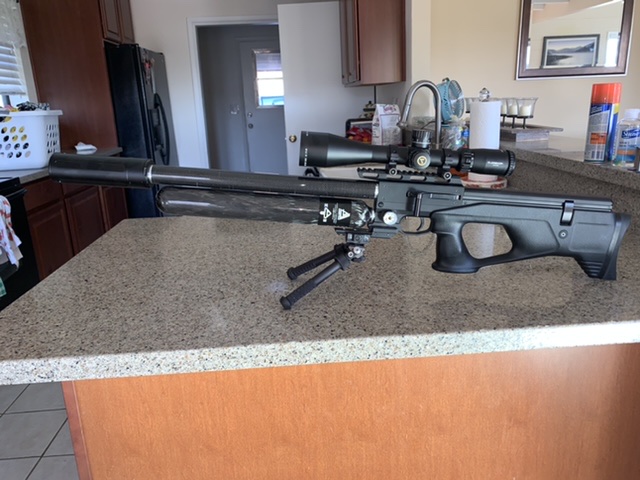

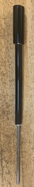

New 28” tj barrel with carbon shroud! I kept the oal the gun the same just ditched the shroud function for now. Its still plenty quiet. I’ll post some more pics attatched.

Yep wanted a better barrel for slugs. The stock barrel was .306/.298 which isnt the best choice for .300 slugs. I also wanted 100fpe, and with really no room for a plenum, longer barrel it was. Today I found a sweet spot at 1014fps with nsa 44gr
So far very happy with this build! A plenum would make this much sweeter but hard on the looks department lol. So here she is almost finished! Heres some specs:
removable valve, .310 steel valve 25 degrees 2mm stem , .280 throat, .264 ports, bronze valve guide, 316ss body with peek seat.
28” tj barrel
carbon fiber shroud
huma reg at 160 bar
atlas bipod
donnyfl ronin
athlon ares 4.5-27x50 ffp
tuned for 43.8 nsa at 1020 fps, 75 shots from 300 bar to 160 bar. 3/4 moa or better
This gun would be an absolute BEAST with another 40-50cc of plenum. But, I just cant see a way to make it look nice. Im open to ideas! I can easily come out the back but dont want to make the gun longer...
