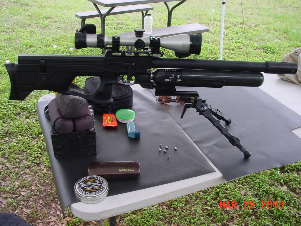

Uragan All Day Long! Unreal build quality. Only production AG I've ever seen with a fully lapped and polished bore. Unreal!

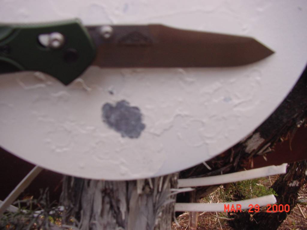

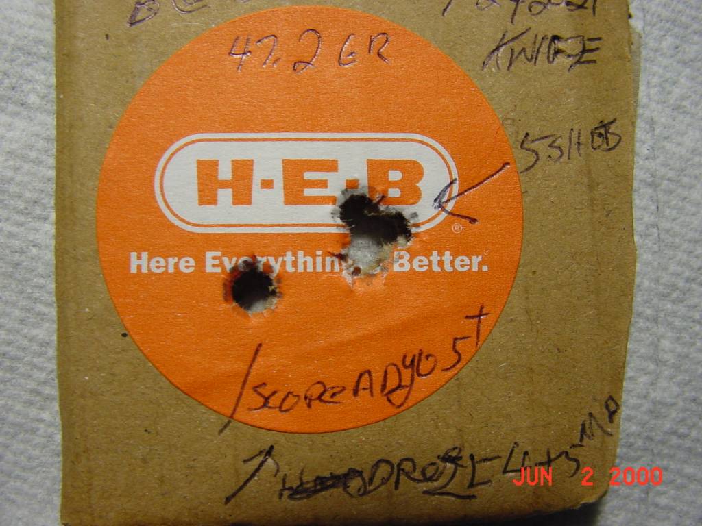

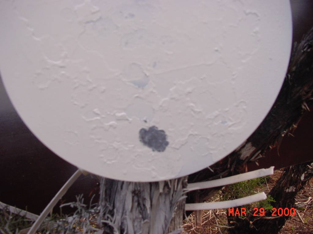

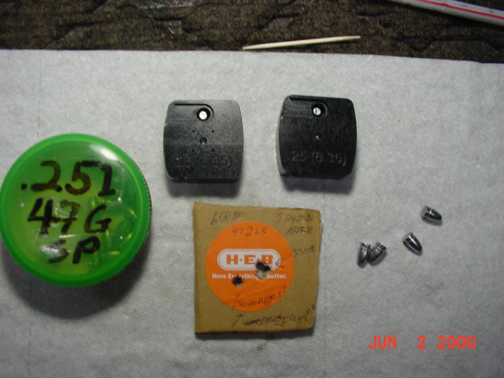

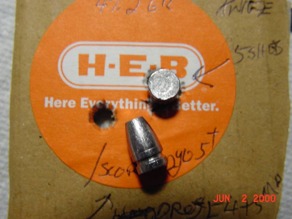

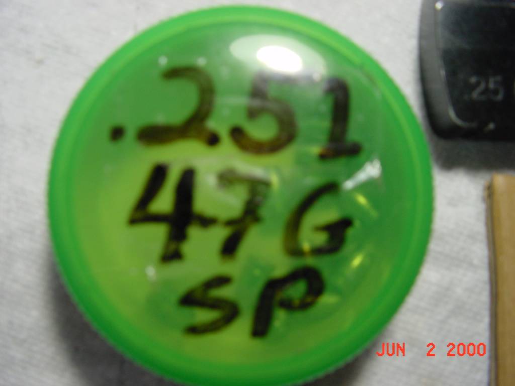

96 yards, near 100 fpe, (added Huma reg and opened the port in barrel. Only mods done), 47.2 gr. hand cast slugs on steel plate. And 5 at 96 yards, ctc just barely wider than 1/4", and this mornings target first shots. Adjusted scope two clicks right and 1 click up for breeze. Turns out, 1 click too much. LOL!!! First shots from it this morning. Dead nuts on.
NO poi day to day. Woo-Hoo!!!

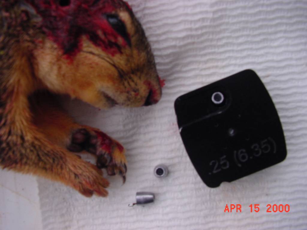

Three squirrels taken, all three straight thru the ear at 56+ yards. Fantastic hunter! Cant post the pic's here I don't think. I'll show one that is not too messy. Mod's, feel free to remove the pic id needed. I will post it below so the entire post is not deleted if needed.

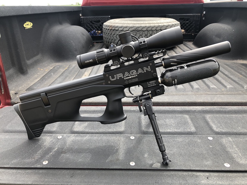

I've had this Uragan 22 compact for a few years and it has not had any issues: air leaks or something broke. It just keeps shooting and shooting. I can't say how many pellets have been shot but its used all year round. I have two friends with Uragan 22 compacts and another who wants one because its so quiet compared to his 22 and 25 wildcats w/ moderators.
I had the muzzle rethreaded to accept the Hugget snipe moderator because the two factory moderators weren't quiet enough. I get 80 shots with the Huma/hammer spring set for 880 fps and single digit velocity spreads with quality pellets.
It cannot shoot on an empty mag.
