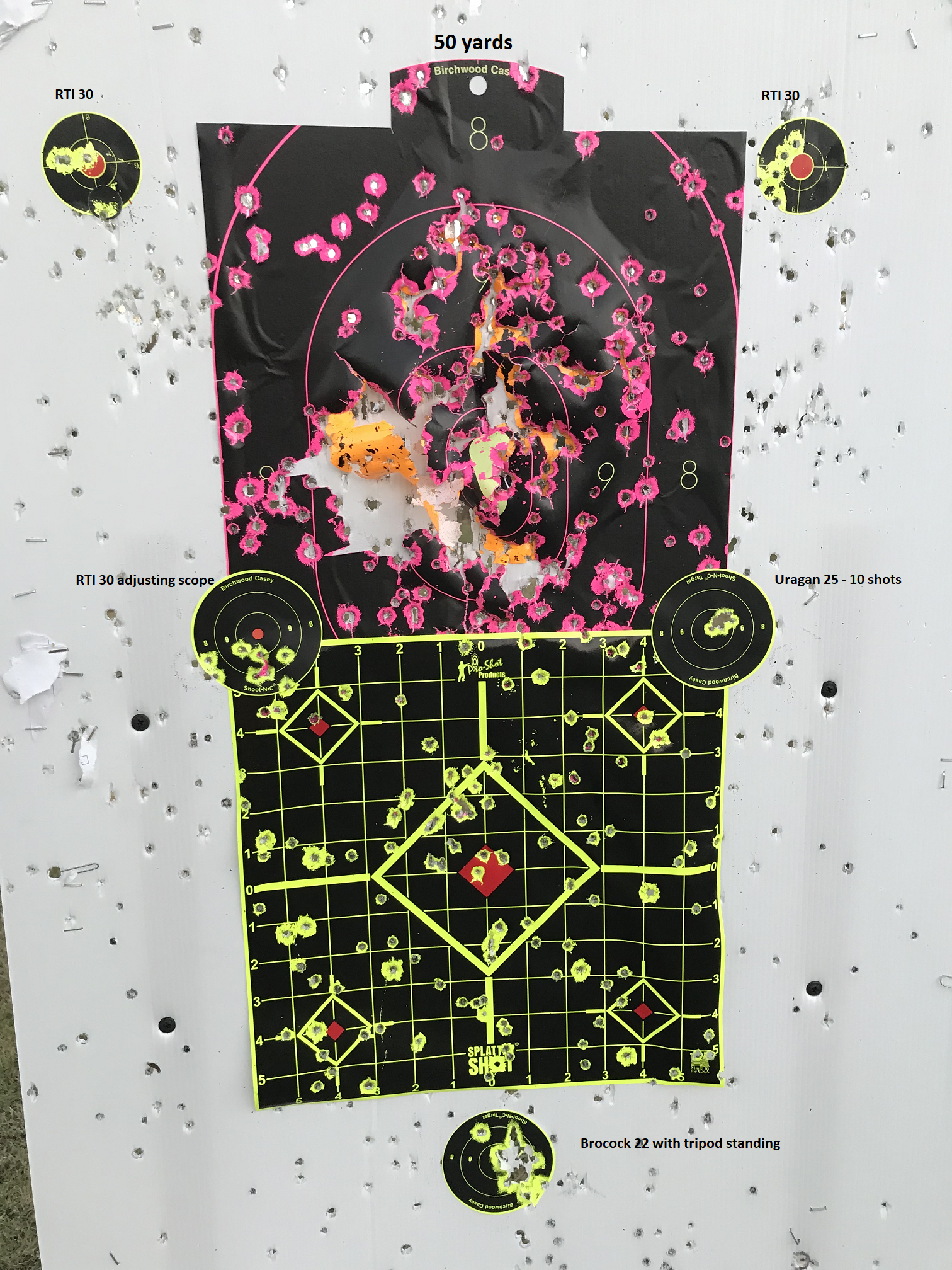

Mine shoots the NSA Eco-33.6-250HPFBs exceptionally well. I am going out to test both HN and Knockouts this weekend. Here's the group from last weekend. I was tuning my RTI Prophet 30.
