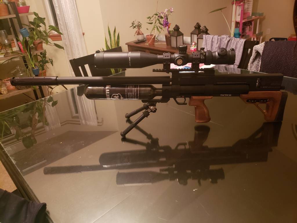

I would vote Cricket Tactical....I own 2 and this one just went from AoA to Derrick Wall to tune for me.
Shoots the 50 grain at 865 and is laser accurate, 44 grainers shoot VERY well also. Very quiet (with moderator) cocking is a breeze, mags can over rotate but are able to be tweeked to address that issue.
Loads of power on tap for slugs (my reg is at 130 and can go up from there) easy hammer spring adjustment, great reg and the trigger is very good....
I own an Uragan .30 as well and it is also a great gun but the Cricket in my opinion is just a couple notches above....
Derrick placed 6th I think it was at EBR this year with a .30 Cricket Tactical so that should tell you something about their long range accuracy...
You won't be disappointed either way!
